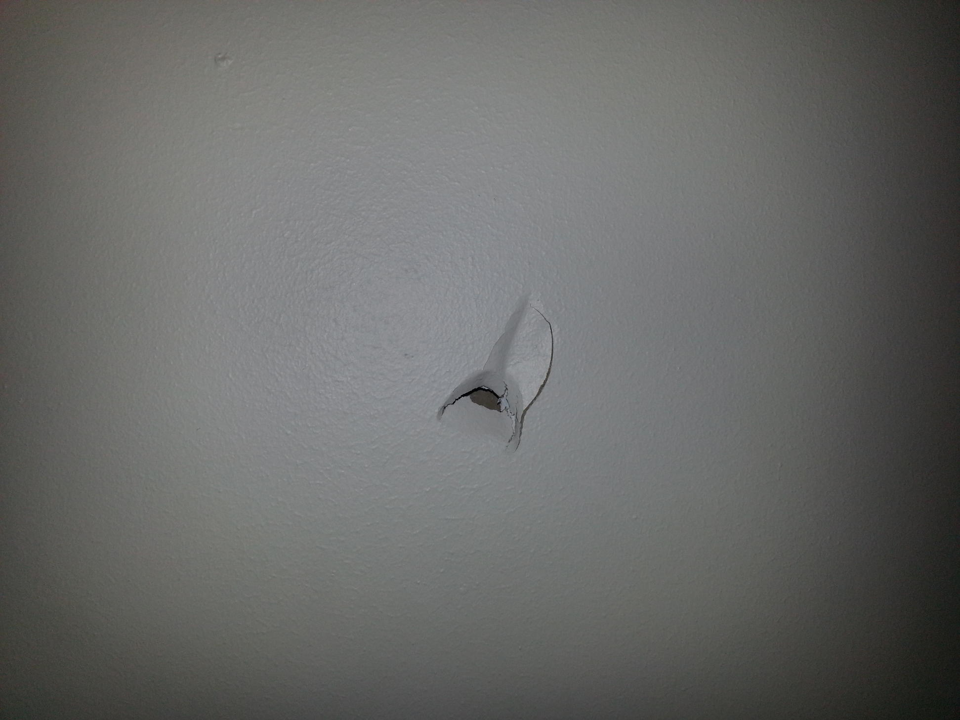

    Hi,
    My nephews were playing with cricket ball and one of them zoomed and hit the partition wall and made a hole in it.
    It looks like this....
    Can you point me to a DIY for me to fill or I need to call someone to fill it?
    Thank you for helping me :-)
  • Drywall DIY Guy
    • Jan 2005
    • 108
    Hole in Wall
    Not sure how big that hole is. For small holes, nickel size and less, I wad up some fiberglass tape, stuff it in the hole so it lies below the surface, and then fill it with joint compound. For bigger holes, I use a procedure shown at Drywall Repair a Hole in Drywall - Instructions But in your photo, it almost appears to be a dent, not a hole. If it is a dent, fill with joint compound. The compound will shrink in, so you will have to coat again a few times.
