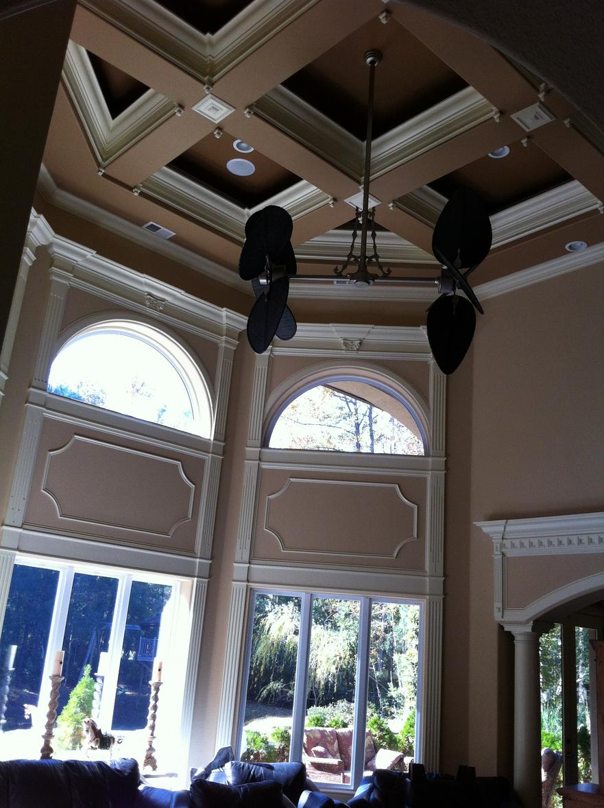

    For inspiration have a look at this coffered ceiling in a friends house.....awesome !!

      Wow, that is an impressive room!

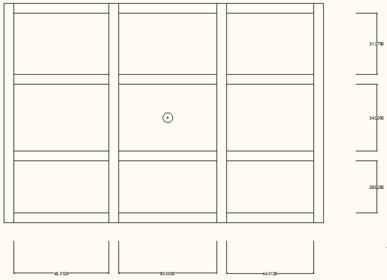

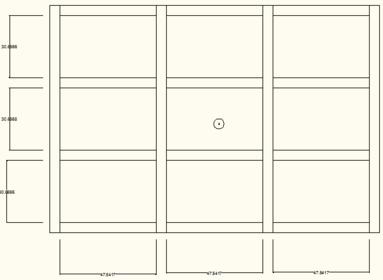

        I have the ceiling mostly prepped and am going to start laying out the grid. I drew it up in CAD to see and found out that my ceiling light fixture is not in the middle of the room! I came up with two versions, one with the fixture centered between a coffer but the coffers are all different or having all the coffers the same and not having the fixture in the exact middle. What should I do? I cannot move the light fixture, a joist is in the way and the wire doesn't have enough slack (it is 3-way switched with switches on two different walls)
        Hopefully you can see the dimensions.

          I prefer the second option with the centered light, but I like everything centered it looks like it fits.
          You would find that the set out will be easier as well.

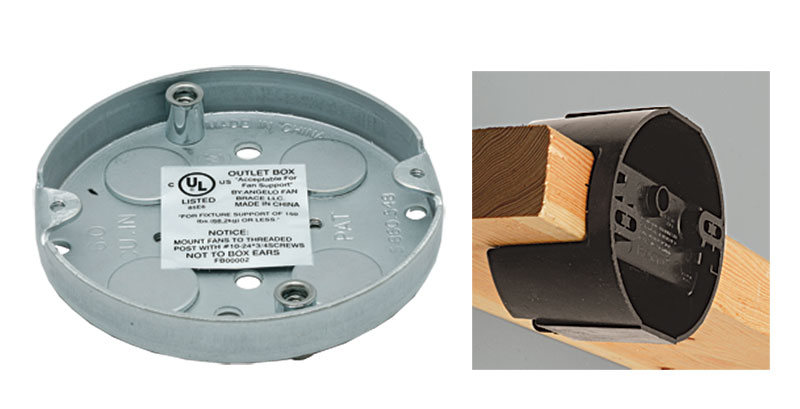

          You could always center the light fixture and use a "joist fit electrical box" they are flat (pancake) and have a 1 1/2" wide recess in the back of them so they actually sit over (and around ) the joist, the extension to the wiring would be easy as well simply by adding a junction box in the attic.

            I thought about that, like the one on the right?

              Yep, that's the one, or if it's not dead center use the standard pancake box screwed of center it's only a light fixture and not heavy.

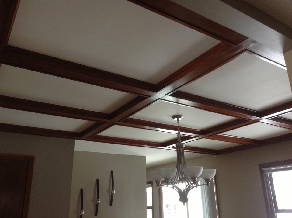

                Here it is...

                  That looks great, excellent work.
