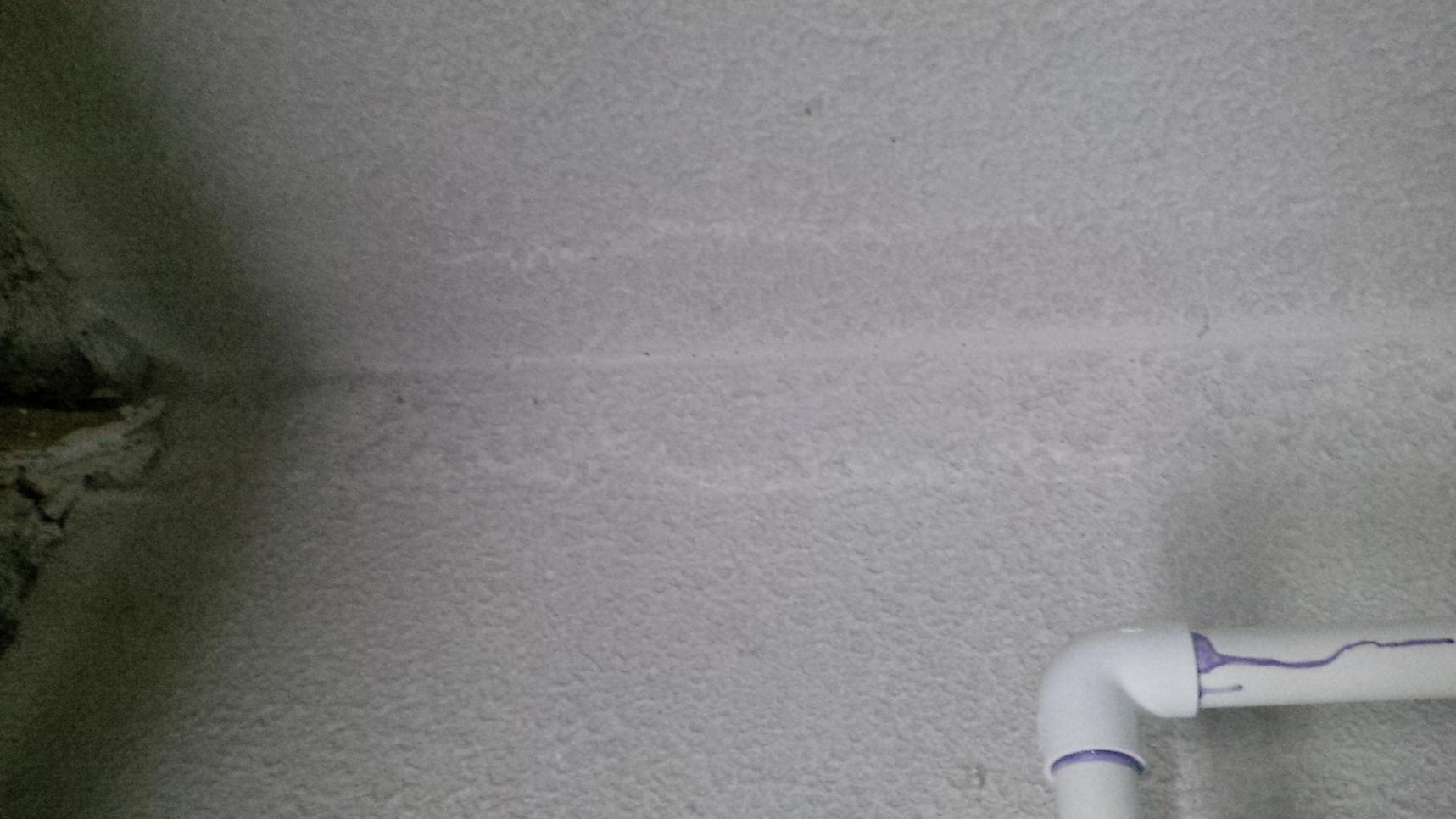

      I think you are right - probably just some kind of paint. Click image for larger version

ID:	87210 Here are some of pictures, one from a corner (looks like they used some kind of tape like large drywall tape) and where the paint has fallen off the wall. The pictures are sideways.
        From the pictures it sure looks like a textured paint product, drylock looks remarkably like that when 3/4" nap rollers are used. The big piece that has fallen off would suggest to me that no lead is involved as that looks almost like it peeled off.

          Okay -thanks. I'll pick some up and see if I can replicate it. Not that it is pretty right now, but it would be nice to keep it from looking like it has been patched.
