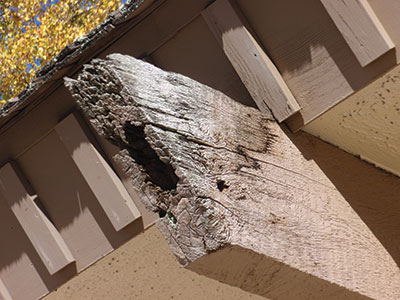

      You can see the end grain splitting and wood rot setting in on this exposed wood joist:
      And here's where I come back to the subject at hand...
      So, regardless of whether you use construction grade lumber or pressure treated lumber, I'd paint the end grain with an end cut preservative to prevent wood rot starting there, give that time to dry, and then paint those same ends with an exterior oil based paint to prevent water from being absorbed into the wood there. Most people use the end cut preservative to protect against rot, but that does nothing to protect against splitting.
