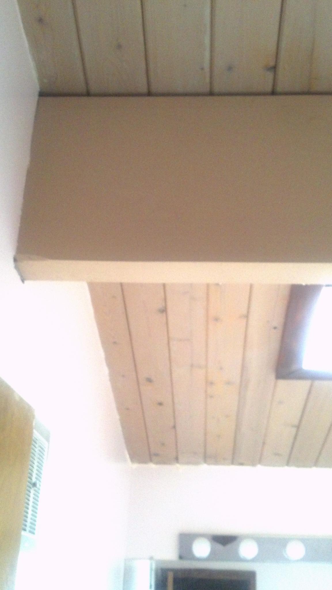

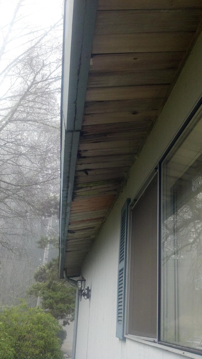

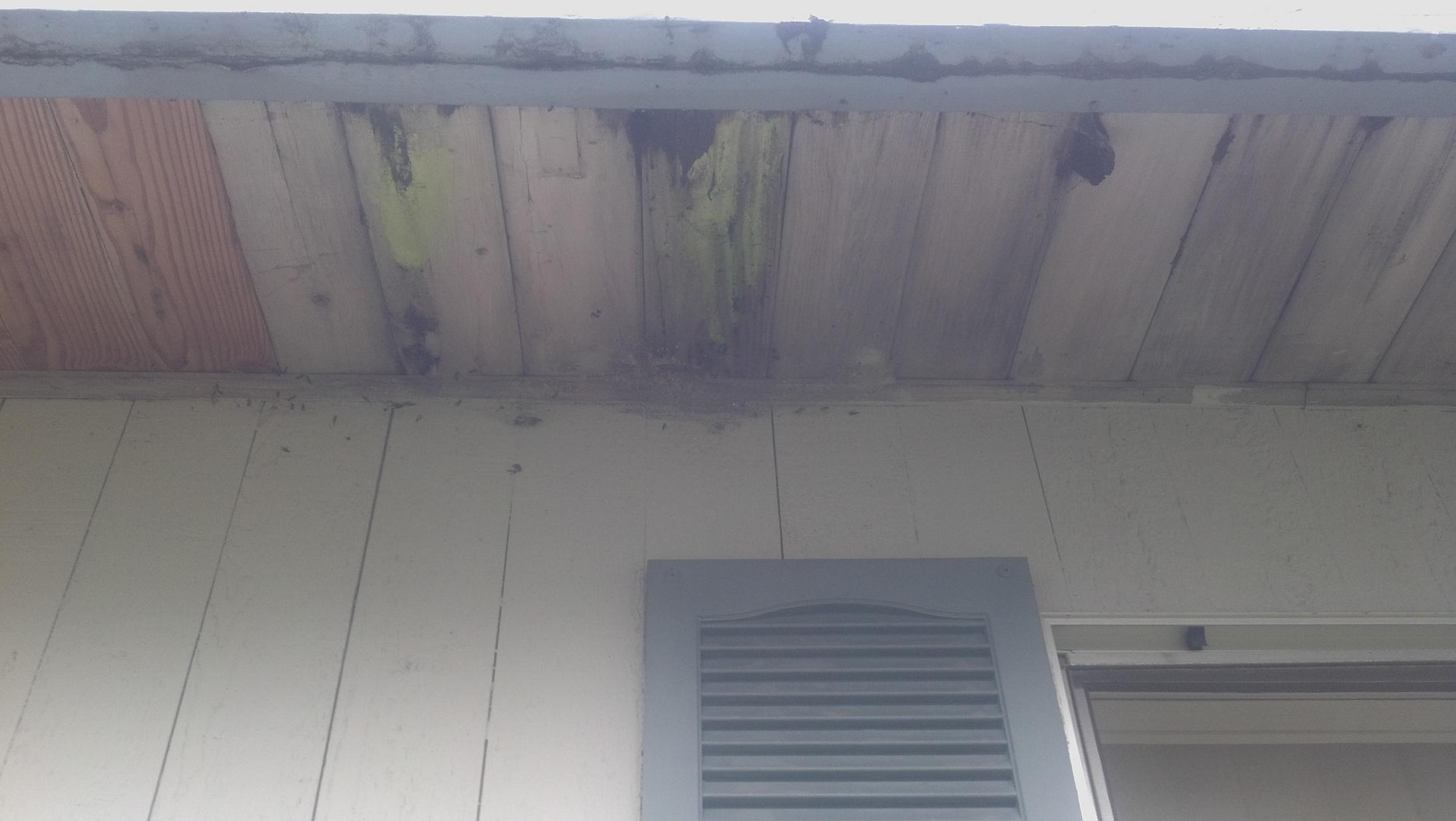

      Here are a few photos
      Click image for larger version
ID:	87165Click image for larger version
ID:	87166Click image for larger version
      The first is inside looking toward the outside wall. it is about 10 feet from the beam to the wall. The other two pics are obviously from outside showing the water damaged area.
