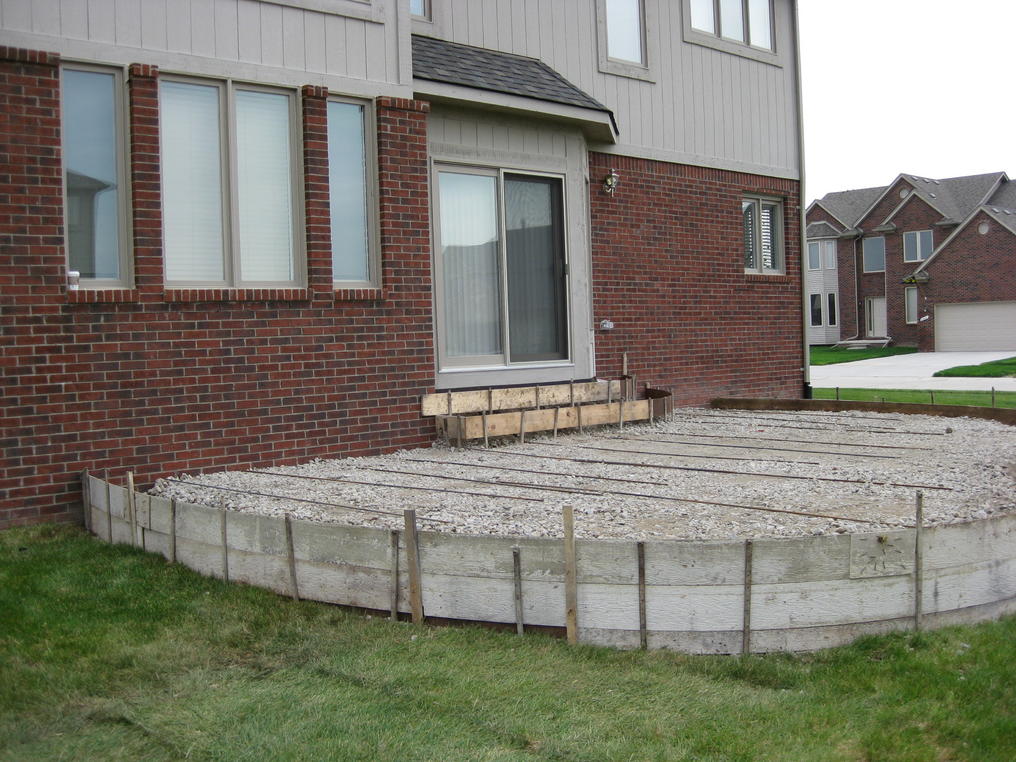

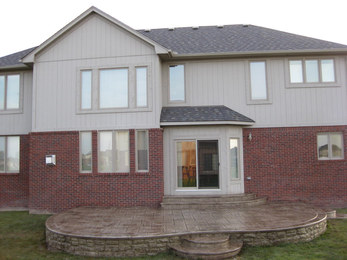

    Hope some gurus can weigh in here.
    I have a 6 year old house (pic attached) that's mostly brick, but is wood in a few areas like the doorwall bay (as shown). 4 years ago, had a stamped concrete patio installed right up to the bay. I believe a vapor barrier was put in place, but as you can imagine, the wood underneath the doorwall (both the trim directly underneath and supporting wood behind the trim) are now starting to rot. The patio covers up about 6" of the bay and is separated by (from what I can tell) only a fabric concrete expansion strip.
    I've had several carpenters come out to quote on fixing it, but the estimates and fixes have varied from trying to take out the concrete steps and replacing wood with fake "PVC wood" to just chiseling out the rot, replacing the trim and flashing everything to prevent further water intrusion.
    Any thoughts on the best path forward for repair? I may end up contracting out the work, but am not particularly savvy with regard to wood rot and making an appropriate fix. Perhaps it's something I can fix myself.
    One other concern is that there is a small-ish air gap under the bay to gravel / earth / crushed concrete beneath - if I fixed the trim and prevented water intrusion from outside, will I still get burned by moisture under the bay? (The patio installed assured me no, but he was selling a patio).
    Any thoughts are appreciated,

    Typically what should have happened is that the siding and trim were either removed or cut off above the proposed concrete line, then galvanized metal or rubber flashing added to the house, pour the concrete, stamp it etc... then and only then reinstall the trim and or siding allowing 1/2" between siding and concrete. this allows any moisture to harmlessly fall away and the galvanized flashing stops it getting back to the house wood.
    What you have is the siding/trim sucking up any moisture it can get out of the concrete and a place for rain water to wick into.
    Removing the trim/siding is problematic as it will leave a gap between concrete and house and replacing it with PVC trim/siding equally as problematic and still will allow moisture in (bigger problems down the track). You could add a small piece of drip edge to the wood, make sure you use a very good quality caulk, apply a bead on the wall and apply a bead on the concrete, position the drip edge/gal. 90 degree into the caulk and then screw the drip edge onto the siding. Once done add a bead of caulk across the entire top edge of the gal. strip.
