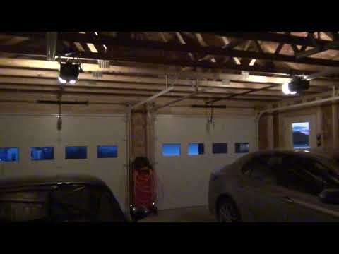

      I made about a 30 minute video.
      Here is breakdown of lights coming on.
      left light on at 6:34
      right light on at 6:37
      left light off at 11:04 left on 4:30 minutes
      right light off at 15:35 right on 8:58 minutes
      left light on at 15:37 left light off 4:33 minutes
      left light off at 20:07 left light off 4:30 minutes
      right light on at 20:09 right light off 4:30 minutes
      right light off at 24:38 right light on 4:30 minutes
      left light on at 24:40 left light off 4:30 minutes
      left light off at 29:10 left light on 4:30 minutes
      right light on at 29:11 right light off 4:30 minutes​
