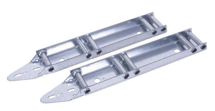

      When you already have had a garage door contractor, I guess he did what he could do with what you have, as adjust the top roller bracket out as much as possible.
      Some quick turn bracket might help.
