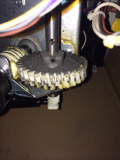

        Just look on top of the opener at the drive sprocket and you will see some black powder like stuff and maybe some pieces of the bushing. When you open the box(DISCONNECT THE POWER FIRST) the big white gear will be full of the same black stuff and you will have it in the cover too.
        When you tighten the chain you put more pressure on the worn out bushings and make the limit gear skip.
        When you closing it will over run and hit the pulley bracket and reverse, then stop half way open. The open/close limit is out of adjustment because the limit gear skipped.

          Sounds exactly like the symptoms I have. When I was looking at it last night I noticed a lot of the black powder and small pieces on top.

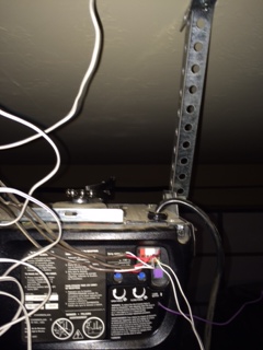

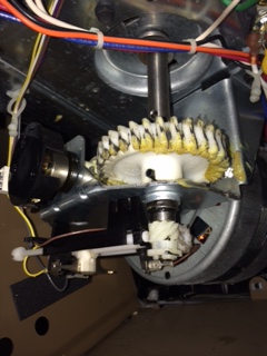

              I opened the unit and snapped some pics (Top of main gear with residue, view of more componets, exterior of unit)

                  Thanks again for all the help. I visually saw how the limits work when I took apart the housing of the unit. Somehow they were way off, and I had to dial back the middle screw so the limits would be within the acceptable range. There wasn't any extra room for the high limit to move up. I don't know if something else was causing it to be way off, but it works fine for now and will go back to troubleshooting if it acts up again.

                    If you didn't replace the gear/sprocket assembly, it will act up again and you can keep reset the open/close limit till the sprocket pop off.
