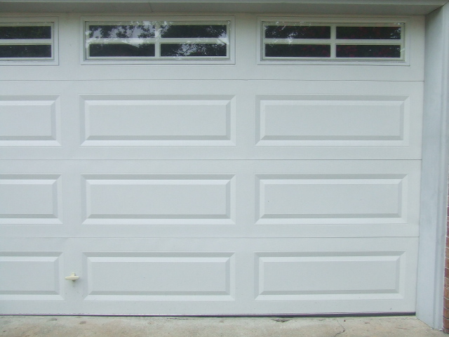

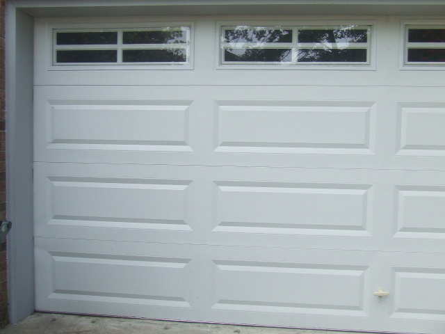

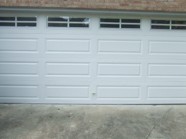

                    Here are a few pics of the door, just to bring this discussion to a close. In no way is the door damaged enough to transfer the jar of a stoppage peripherally, which, evidently disables this feature.
                    Thanks for the help.

                      Nice door, don't look bad at all. So with what you told so far and what I can see in your pictures will rule out the door as the problem.
                      Some might run tight on/in the opener. Did you or any ever tighten the chain on the opener? Get the ladder out and look up on top of the opener around the front of the drive sprocket, do you see a little pile of black stuff? Take the cover of the opener and take a good look at things to see if gear or bushings has any wear. A couple drops of oil (3in1, engine oil, oil) on the motor shaft at the bushing behind the black cap, on the drive shaft at the bushing under the white gear and drip some oil on the pulley at the wall mount you will see where it can seep down. Some times that can free up an old lady. It can be some in the dials. Before pulling to much hair swing by Home Depot and see what they have of Chamberlain openers.
