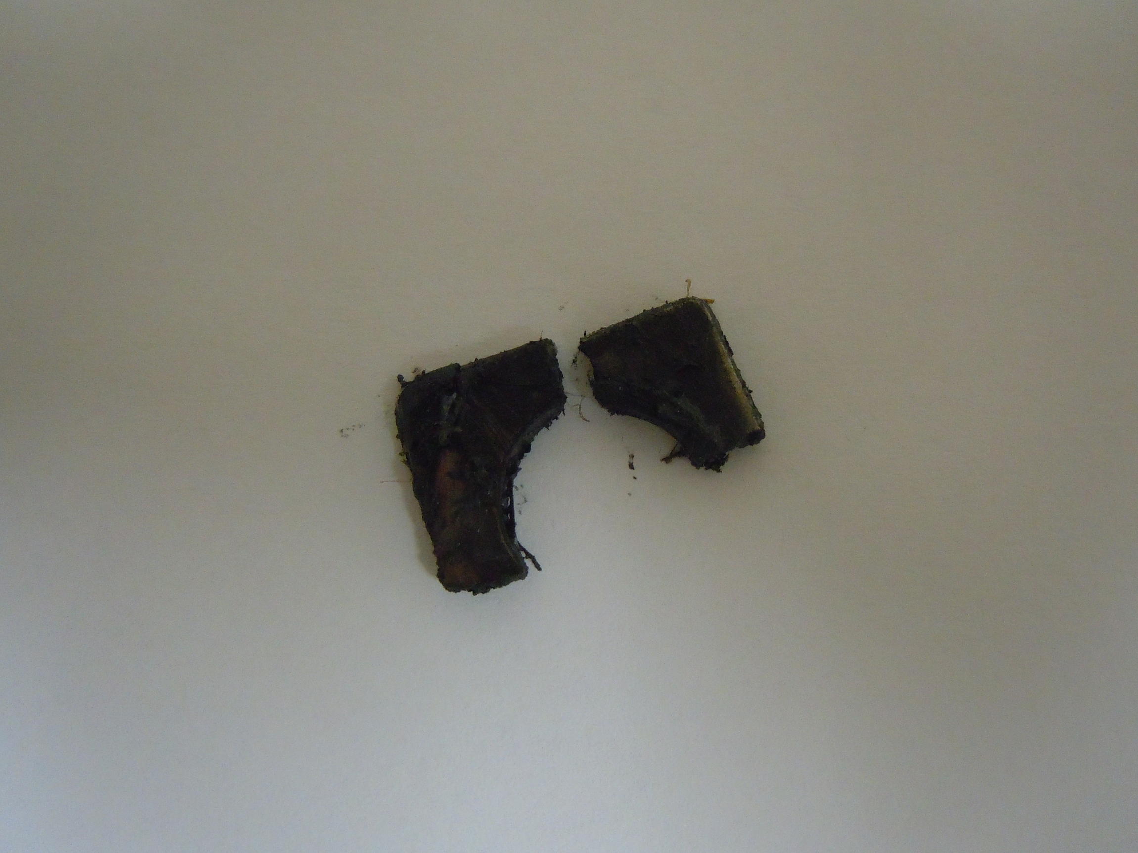

          I opened up the gear section to check on the popping sounds. On this type there is drive gear that is horizontal and is driven by a worm gear from the motor. The teeth on the drive gear appear to be fine, and the threads on the worm gear appear to be fine. At the bottom of the drive gear cover I found two metal pieces which fit together and seem like a part of something else. I removed them and put everything back together. However the symptoms are the same. However, I figure that the broken pieces must be at least part of the problem. I have no idea what they are , but I have attached a picture of the two pieces. The only other clue was that there were two washers on the worm gear between the gear and the motor, and I thought it was odd that they seemed to just "float" freely between the worm gear and the motor. The pieces could have come off of the worm gear's rod and slipped into the case that sits under the main gear. Perhaps they are broken from the glide bushing for the worm gear.
          Any ideas would be greatly appreciated.
          • TJR
            • 175
            Not sure where it goes, but it is missing somewhere to keep things in place and it don't show as a part number in the manual. So you will have a hard time to find that piece.

                  The part that was broken which was broken turned out to be the bushing for the worm gear (I think it is listed as the motor shaft bushing). I have replaced it, and I added some lubricant. Now without the door attached, the chain will only go a few inches either down or up. Previously, without the door attached, it would run its entire course both down and up.
                  Any thoughts on what that might be?
                  My only thought now is to replace the drive gear with the possibility that it has a small crack and possibly try the circuit board replacement again. What about the capacitor? Could that be an issue?
