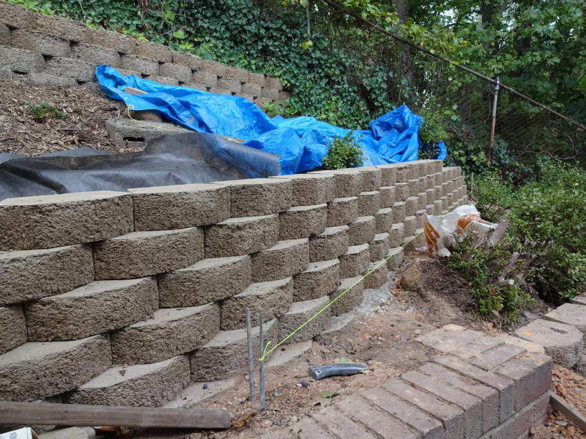

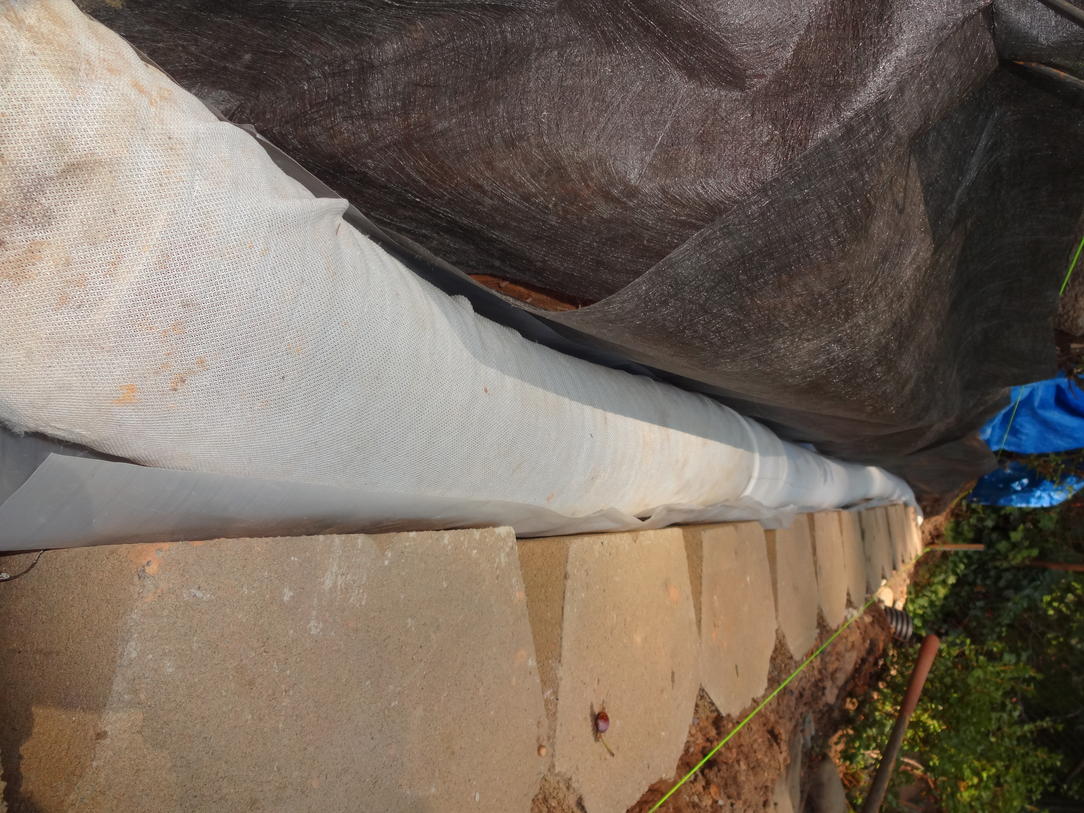

    I am nearly finished with the 3rd retaining wall on a steepish slope.
    i am installing 4" lined drainage tile on a bed of drainage gravel. I was thinking about lining the bottom half (approx. a drainage pipe diameter) with a narrow strip of plastic to divert as much water away from the base of the wall and into the pipe as possible?
    Is this over-kill but possibly a good idea?
    Thanks

    You could add the plastic/visqueen to the base, but really there is no need. In a wall like your building the reality is that most/all water will seep through the wall. The drain tile is typically used to remove the pressure from behind a wall that can retain/hold water like a solid brick/block wall or basement wall etc... With your concrete block wall there are many many places water can seep through (and that's the point of the design). Now if you were to line the rear of those blocks with plastic from the drain tile up to the finished ground height the tile would take the hydrostatic pressure off the wall by allowing the water to drop down and into the pipe (as it cannot pass through the wall).

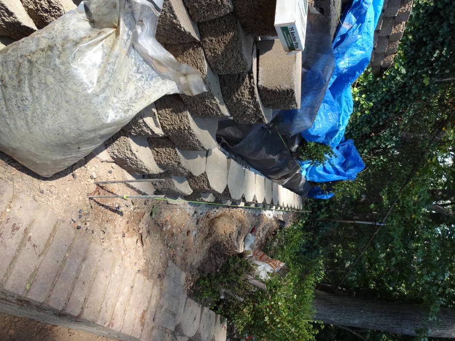

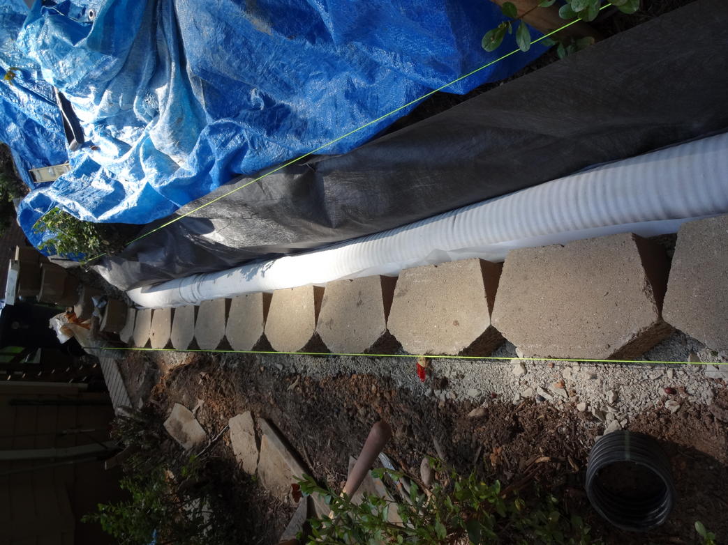

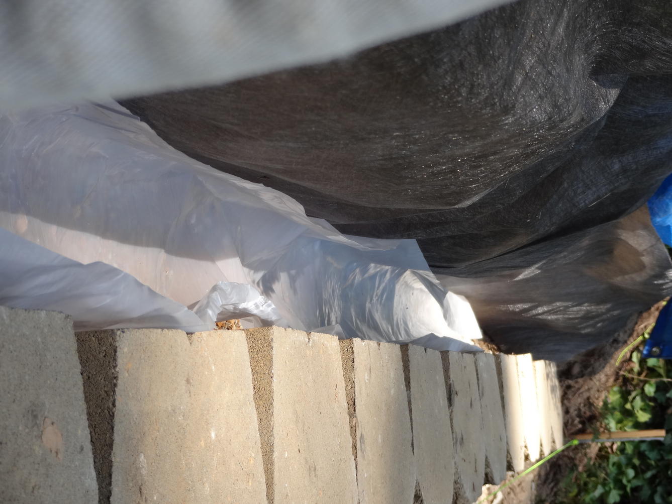

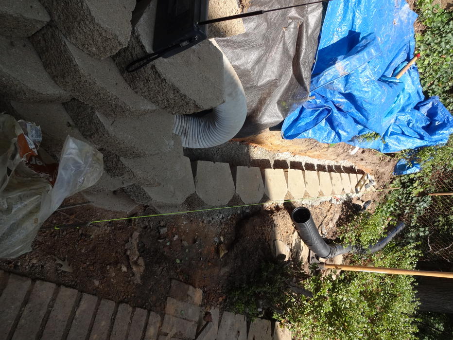

      Thanks...I was really only thinking about linning the bottom half of the pipe to channel water away from the wall altogether because of the slope and possible liquifaction of the base with enough water during our famous deluges...at any rate, I lined it, and got on with the project before the tornadoe warnings began this afternoon....

      I backfilled with drainage gravel and closed up the patient!
      DONE!!!!!!!!
