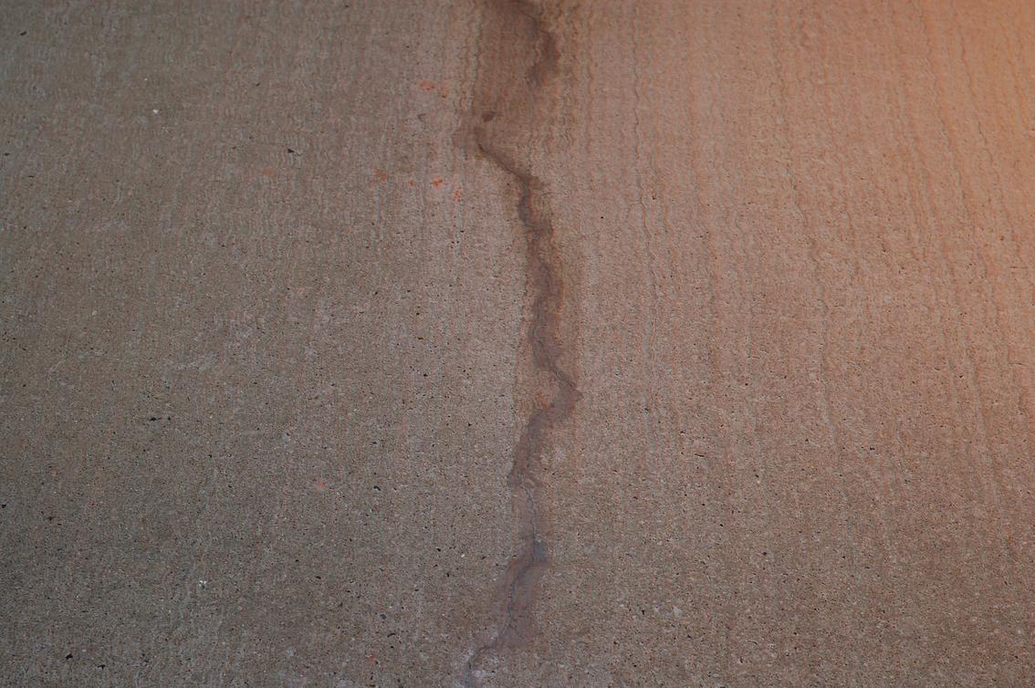

    Cleaning Cement prior to painting
    I am painting a 8 x 8 x slab using Stoneffects Rollable paint with primer in it already. I own a power washer and was wondering if that alone is good enough to wash the slab and let dry before painting. There is a entrance roof over it so its not totally exposed. See image for surface I am doing. My plan is to also apply a clear sealer at the end of the job to extend the life span of the product. Thanks for any tips.Click image for larger version
    slab
    Any concrete that is wet and appears to be dry really isn't. Concrete is a mixture of aggregate [stone] sand [silica] and portland cement [ baked ground rock] and limestone.
    Hence it is porous.
    Pressure washing will remove some of the surfactants in the form of a whitish powder.
    To be absolutely clean it should be acid scrubbed.
    I can't see how a primer can be in an all-in-one application.
    A primer "primes" the surface for a finish coat.
      I know the product your referring to Honda, it's a paint product and as a paint product it works pretty well. Power washing is a must a light solution of hydrochloric acid wash would be advisable as well. You will have to wait up to a week between washing and applying the paint to ensure the concrete is dry enough for adhesion of the paint.
      IMO stains are a much better option, they permeate into the concrete and don't have anywhere near as much "wear" paths and you can clear coat over a stain (clear coat doesn't work so well over paint).
