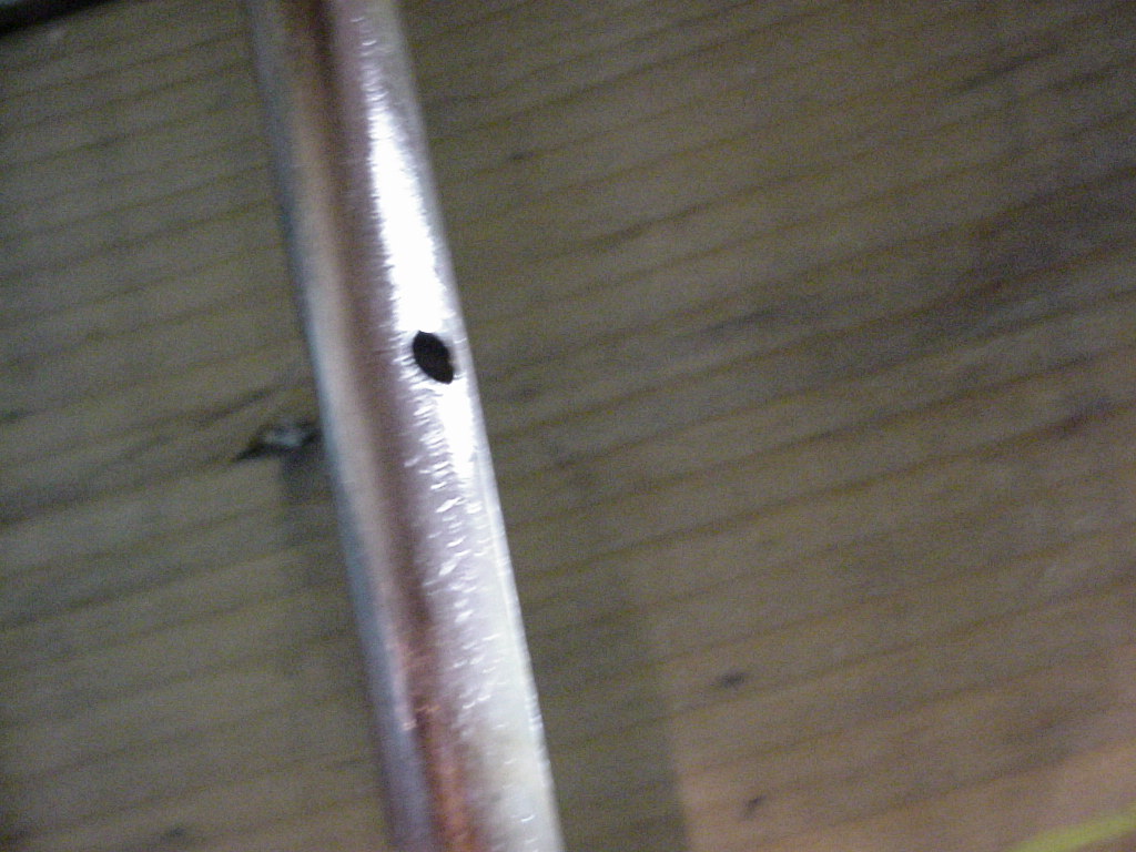

    Another update. I just took off the saddle valve to look at it and it IS the self piercing type. I took it off, then put it back on, still drips at the fridge of course.
    Tomorrow, I'm buying this:
    Part Details - SEA Saddle drill tap valve, part number: STV2D (any tip on how to keep metal shavings from getting into the pipe?)
    Now, the only test I did weeks ago, was seeing if there was pressure to fill a bucket, but that's it. Tell me exactly what I need to do to test it by your method?
    Am I on the right track now?

      ** any tip on how to keep metal shavings from getting into the pipe? **
      Very little should go into the pipe, most should be forced out via the bit's grooves. But you could always run
      water through it into a bucket first before connecting it to the fridge just in case.

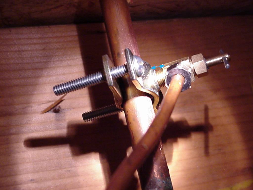

                Ok. Now I'm about to go crazy.
                Tested with the old self piercing valve, and it took 4 min and 50 sec to fill the huge 5 gallon bucket from the small coper line on the back of the fridge.
                Drilled the hole to 1/4", and then did the test. 2min and 50 sec! No joke, it was double the speed.
                Put it all back together, and it still drips, same thing as before. I don't get it. The water pressure coming out of the tube was super hard, night and day, but it still drips.
                Here is the new drill valve in place.
                Wasn't sure how much I was supposed to thread the valve into the first bracket that the rubber piece sits behind. I twisted it in maybe 3 turns, and the shaft barely sticks into the copper pipe. It doesn't leak. Wasn't sure if I needed to thread it all the way into that bracket, see pic. Again, nothing leaks on the valve.
                Not sure what to do now. I just can't figure it out. What are the chances of the brand new water fill valve being bad. I tried the old one, and the new one, same drips at the dispenser.

                  ** What are the chances of the brand new water fill valve being bad. **
                  It does happen occasionally but I'd have to ask myself what are the chances of both the
                  new and original valves being defective in the very same way? I'd say that is fairly unlikely.
                  ** Put it all back together, and it still drips **
                  Does it drip from the dispenser continually or just for a short time after use?
