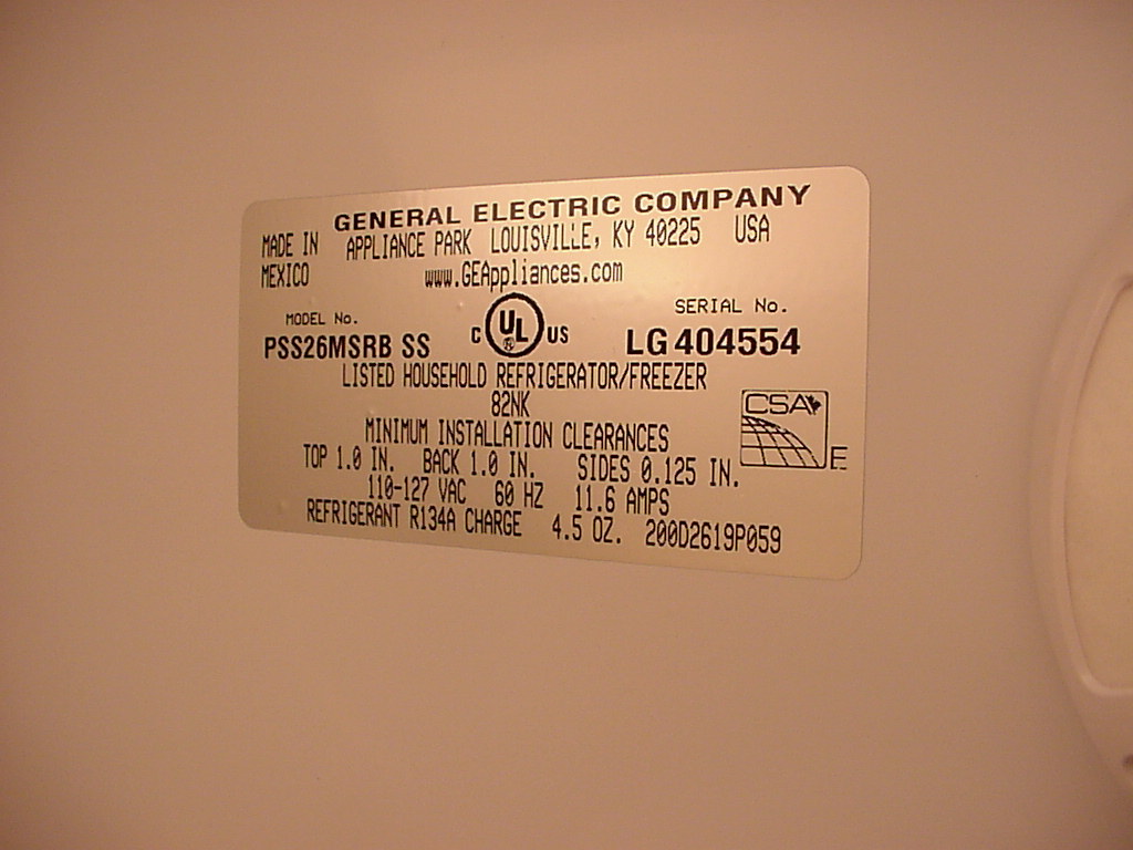

    Model number incorrect?
    ** GE Profile PSS26MSRB SS **
    I'm afraid I can not find a listing for that exact model number (note bolded character in question above).
    If this is not a Canadian model, please double check it.

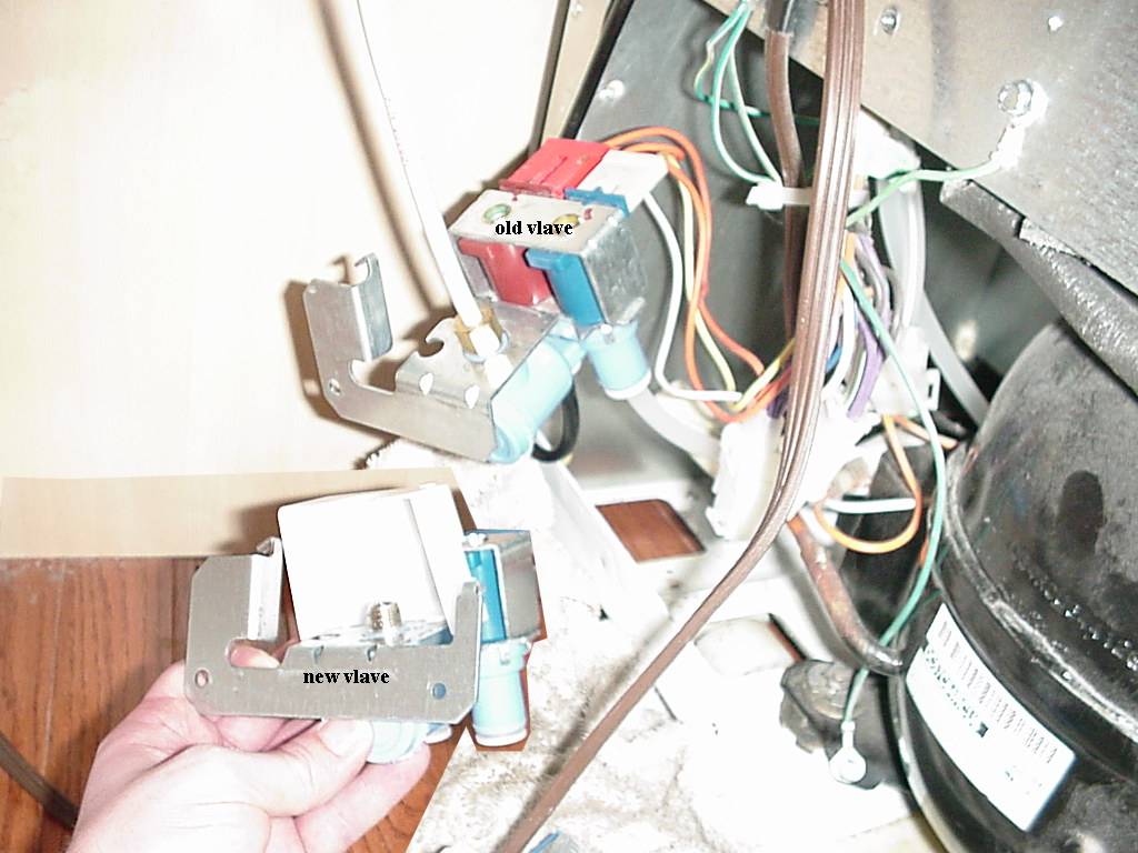

                      Ok, here is the latest. I ordered the new electric water valve that you posted and it came in today.
                      (They looked almost identical, except the new valve had a longer mounting plate, and some kind plastic shroud around the top)

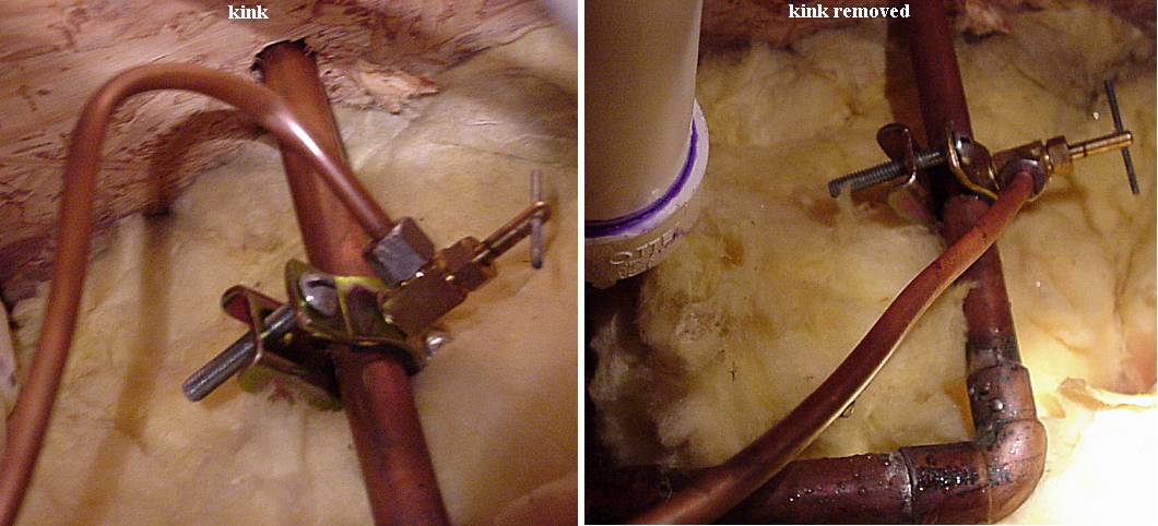

                      I installed it, crossed my fingers, it still leaks! : ) I read all your replies again. I could never get to that valve in the basement to check to see if it was a drilll type or self piercing. I had called the previous owner who built the house months ago, and was told it was a drilll type.
                      I removed some of the drop ceilng panels to try to find this thing to see for myself. Also, I noticed a KINK in the line, right before the shutoff valve. I cut out the kink, and made the line go straight into the valve:
                      This seemed to fix the leak, which led me to believe this kink caused the issue. So, as a test I then put the old electric valve back in, and it leaked again. So, I thought maybe it was a combination of the kink and the old electric valve. SO, lastly, I put the new electric valve back in, and now it's still leaking again! I checked all connections, swaped them both out a few times, and it's still leaking. Argh.
                      Here you can see what happens after filling a big glass of water: video I made of leak, .mpg
                      I really don't know how to tell if the valve in the basement is a self pieceing or not. Maybe these pics will help you. Also, I'm on a Well here, and the well tank has 25 gpm written on it, which I thought was pretty good, as most people in this neighborhood get 8-15.
                      Suggestions?

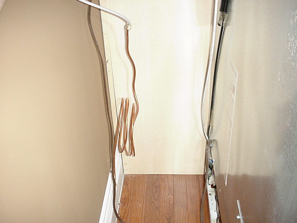

                      Also, here is a pic of the back of the fridge.

                        • Dan O.
                          • Sep 2003
                          • 2167
                          The water filter is in line after the main fridge's water valve so even IF it needed replacing
                          it shouldn't create your symptom.
                          I can not tell what type of saddle valve that is either.
                          ** ...has 25 gpm written on it **
                          Hopefully it is working that well because that pressure is borderline to begin with for a
                          refrigerator water valve's operation.
                          Sorry but I have no other ideas. I would think either the water supply pressure is not high
                          enough or the saddle valve might be the problem.

                            Thanks. I also just found out that I have a contstant pressure pump for the well, and it's set at 60 psi.
                            • Dan O.
                              • Sep 2003
                              • 2167
                              #15
                              ** it's set at 60 psi. **
                              As long as it is working up to that it should be more than sufficient pressure.
                              Did you ever actually test the water pressure coming out of the the fridge's water
                              supply line? I can't see the problem being anywhere else.
