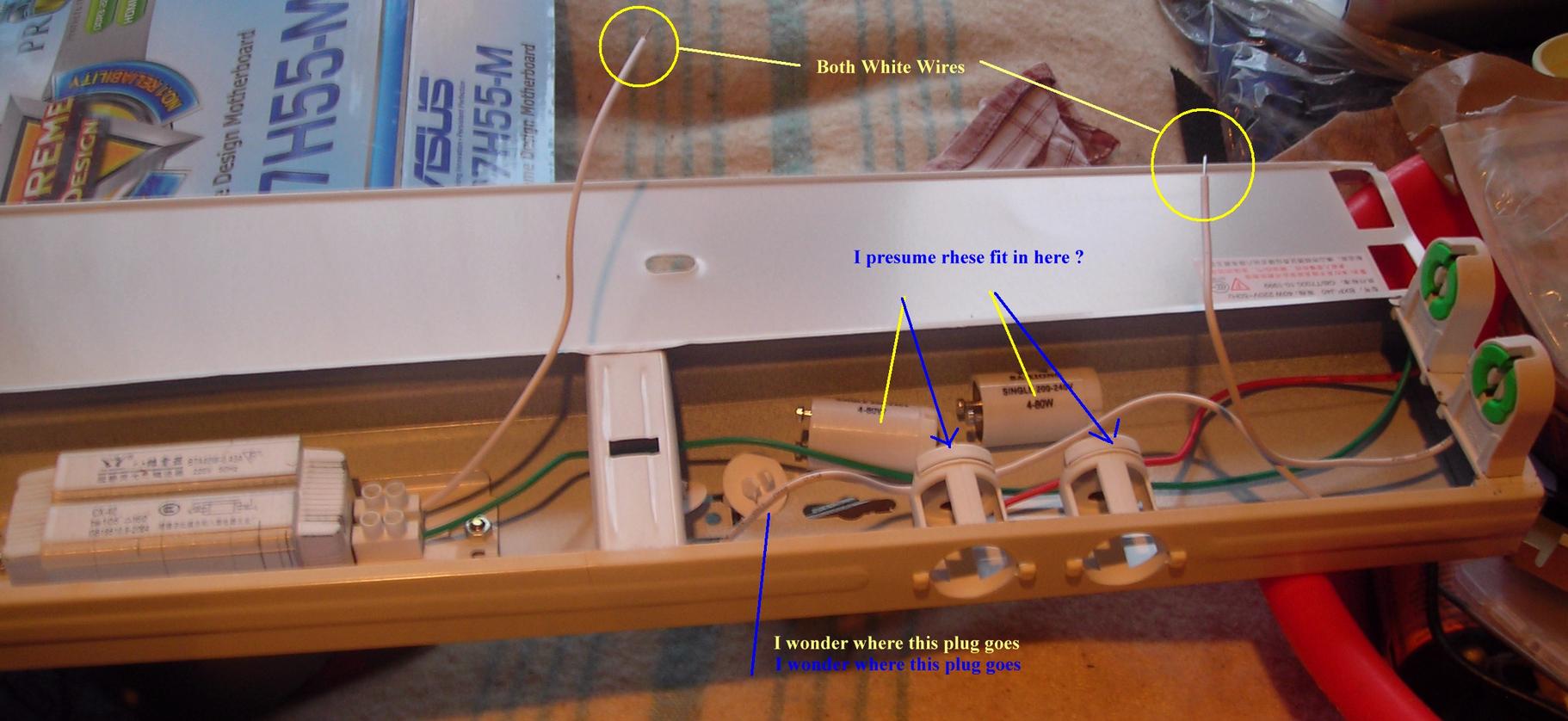

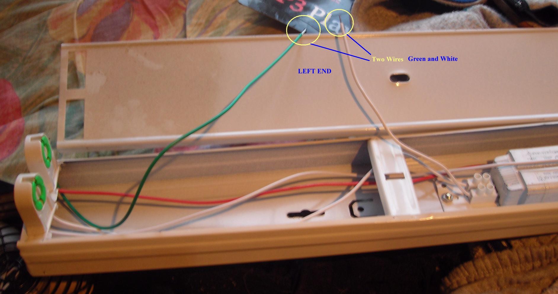

    Hi...I purchased a Twin Flourescent Light fitting some years ago on auction and have decided to put it in my work room .... BUT I do not know how to wire it....So I have attached two photos (one of each end of the fitting ) and hopefully a member can tell me how I wire it up ...Thanks...

    there's a wiring diagram printed on the ballast, follow that.
    those two circular gizmos are starters, they go into those two sockets.
    this type of fixture is called a trigger start ballast.

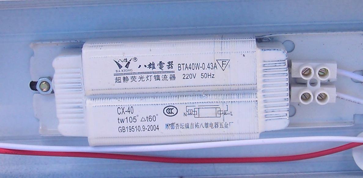

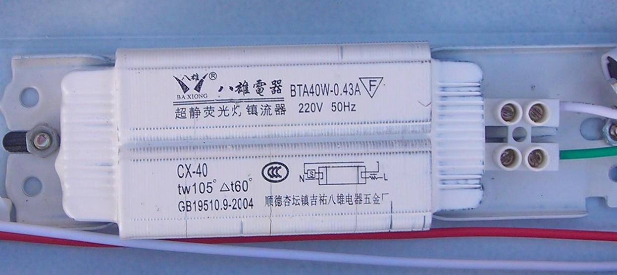

          Hi Photos are attached of the two ballasts...BtW I am not in America but I am sure it will not be a factor...hk

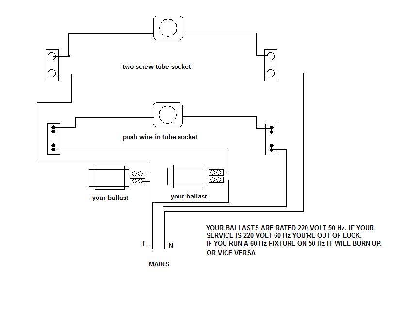

            attached is a wiring diagram for your particular ballast. printed on the ballast it says 220 V 50 Hz.
            If your mains are 60Hz, this fixture will burn up in a short time. because the ballast is rated 50Hz.
            The starter is in series with one side of the bulb socket which may be a screw connection or a push in wire terminal [as shown on my diagram]
            One other terminal of the bulb socket goes to the ballast, the other bulb socket terminal goes to the LINE. the remaining wire from the ballast goes to your NEUTRAL Click image for larger version

              Hi..Thanks ..I think I have it .. The starters just push in and turn ......my supply is 230v 50 hz.....Hk

                      Hi...I wired up the unit yesterday and put it up today ...and no light..??? I already have a single unit up and going so I tested both bulbs in it and they are alright so tomorrow I will take it back down (which is difficult on my own) and I will recheck how I have wired it.....If I cannot find where I have gone wrong I hope you do not mind if I take a photo and post it for you to look at....At least sparks never came shooting out? Thanks Hk.

                          shouldn't matter. the ballast is just a coil wired in series in your circuit. look at my diagram again

                            Yes I rechecked your diagram and rewired it again ..I needed another short length of wire ??? and it has now burst into life...BUT I do not know where I went wrong in my initial wireup....Would help with less white wires on the fitting....and I have had to back the unit with a board to stop the fitting from twisting??? but its going and thats the main thing although a bulb is fluttering so do not know how long it will last ....Cheers .Hk
