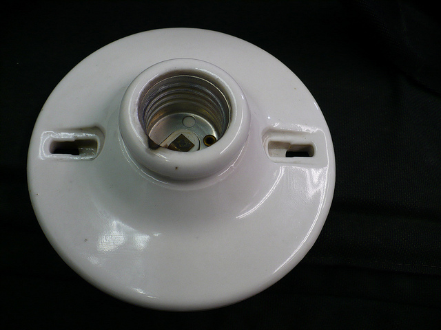

    Having passed our one year anniversary of buying our first home and learning of the Farmer John style of rewiring the kitchen and garage (my apologies to actual farmers named John) I'm having to address some potentially dangeous issues. Last one I addressed was a covered up oven wall socket that had loose/broken connections in the wall. With this in mind I'm wanting to attack another issue with elecrical. In the garage the primary lighting is from a wall switch to a single incandescent fixture mounted to one of the rafters above the washer and dryer.
    This fixture had been tapped into (loose again) to operate a T12 fixture above the workbench in the back of the garage. Upon first moving in the fluorescent tubes (F96's) would occasionally flutter off. I replaced them with fresh tubes that I use at my office, but upon replacing them they failed to light. Suspecting a ballast issue (as at my work this is one of the usual suspects) I held off on this repair until I got on top of my oven issue.

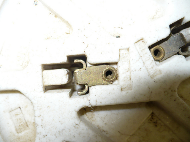

    So, yesterday I purchased a standoff voltage probe and began tracing wires with load and finding the corresponding breaker I killed the power and took apart the smaller fixture and found that there were four wires (two white, two black) that had been crammed into the hold fasts in the cap.

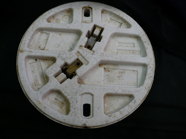

    It looked as though the primary wiring (in place) had been curved into a hook pattern and was wrapped around the bottom of these with a wire and stay holding the wire in place. The tap was loosely crammed into these tabs and only the black tap was secure. After I removed this panel the whole works of the spring wire and tab fell from the fixture.
    So my questions are is this fixture repairable? Is there a safe way to run a tap into this fixture? or should I get a box to make a junction for the lighting wiring in this space. (seems logical to me, but I'm no one's electrician save for automotive).
    Thanks and a lift of the lynch lid for any help on this.

    this type of fixture is called a keyless receptacle.
    "Farmer Brown or John" or whatever should have used a 4 inch octagon nail on box to splice and/or hold the cables. Connections to the fixture itself should have been with screws.
    What you have is a quick-wire fixture which I don't trust and as you found out, the wires pull out or fall out.
    Get the right fixture [screw terminals] and a box and do things correctly.

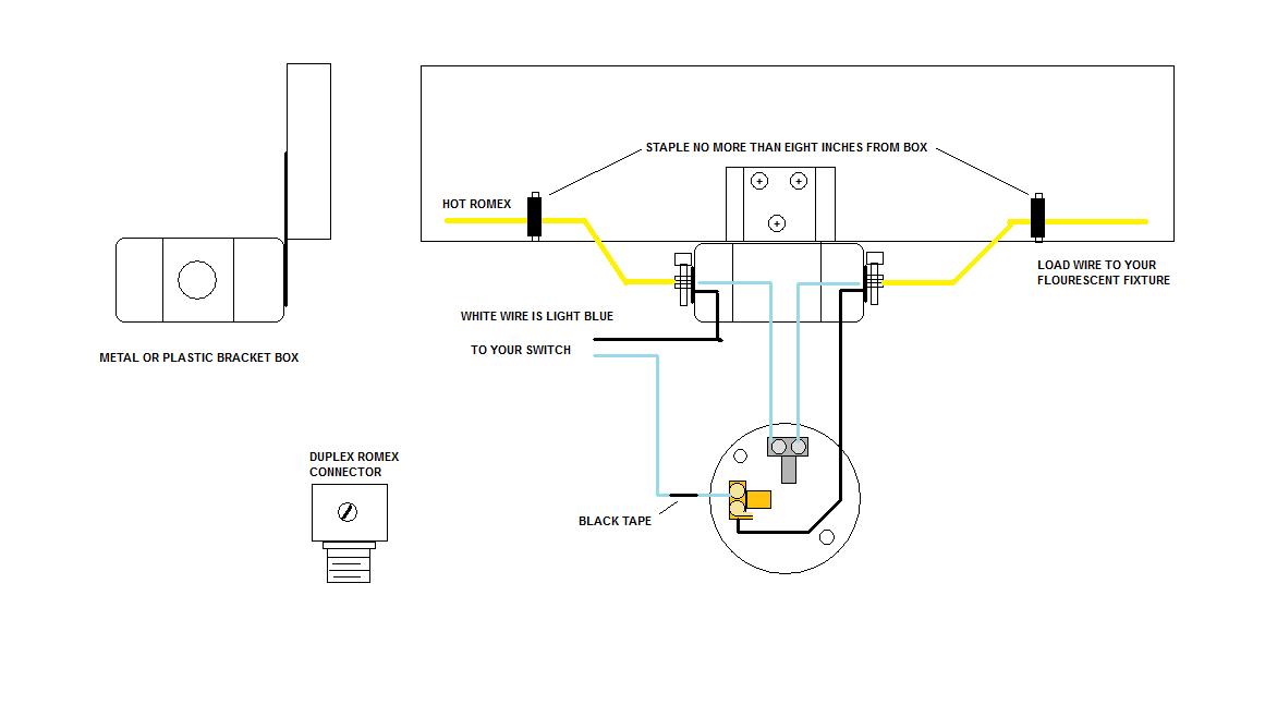

          Ceiling fixture
          Here's a diagram that shows a ceiling bracket nail-on. It could be metal or plastic and how to wire a porcelain keyless receptacleClick image for larger version

            WOW! That's downright groovy! Thanks so much for the specific diagram!

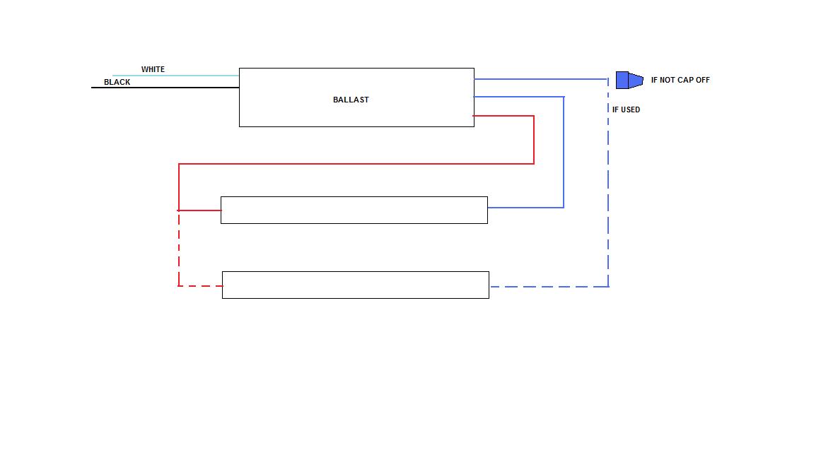

                    Well I broke down and got a replacement electronic ballast (Advance ICN-2P60-SC) that according to Pro lighting.com is the replacement for my old one (Advance Magnetic SM-2E75-S-TP). I wired in the new incandescent fixture and tested it and it works fine. Ran new cable to the fluorescent fixture and wired the new ballast as per the instructions of the case and....nothing, nichts, nada. I verified I had power to the fixture and after disconnecting the cable verified continuity to the tube sockets and all checked out. Tonight I'll take some photos and post but having double checked my wiring and relpaced numerous F40T12 and two F96T12 ballasts over the years in my office, I'm at a loss as to what could be the trouble.
                      ballast
                      I went to the Advance site and in their PDF diagram extrapolated this diagram.
                      A single tube fixture uses the blue and red along with the 120 volt [white-black] wires
                      A two tube fixture uses the extra blue with a jumper to the red.
                      One tube, cap off the extra blue wire.Click image for larger version

                        Wow Hayzee,
                        Didn't know it'd be different than the retro fits on double F96's I've done before. Thanks for this diagram!
                        • Turbogus
                          • Sep 2013
                          • 23
                          Well, let there be light. Went by your diagram (from Advance) Hayzee and it's workin' the diagram on the ballast itself was in I'd say 1 pt. font and hard for me to read despite my new bifocals. Again, I suppose I'm just too used to retro fitting ballast that I normally purchase from Hab for Humanity that is of the same period and design when it comes to wire color code. I'm going to be more cafeful in the future.
