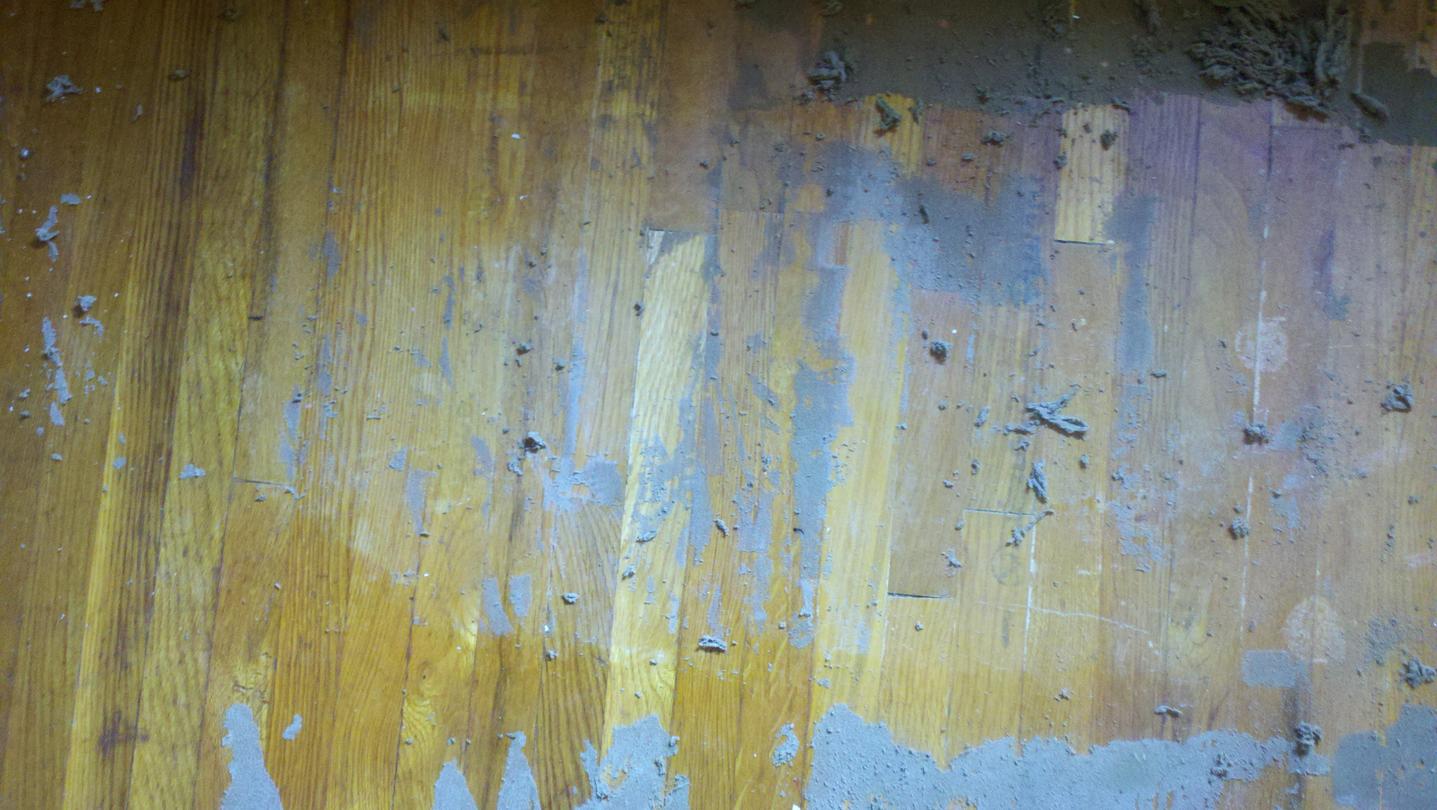

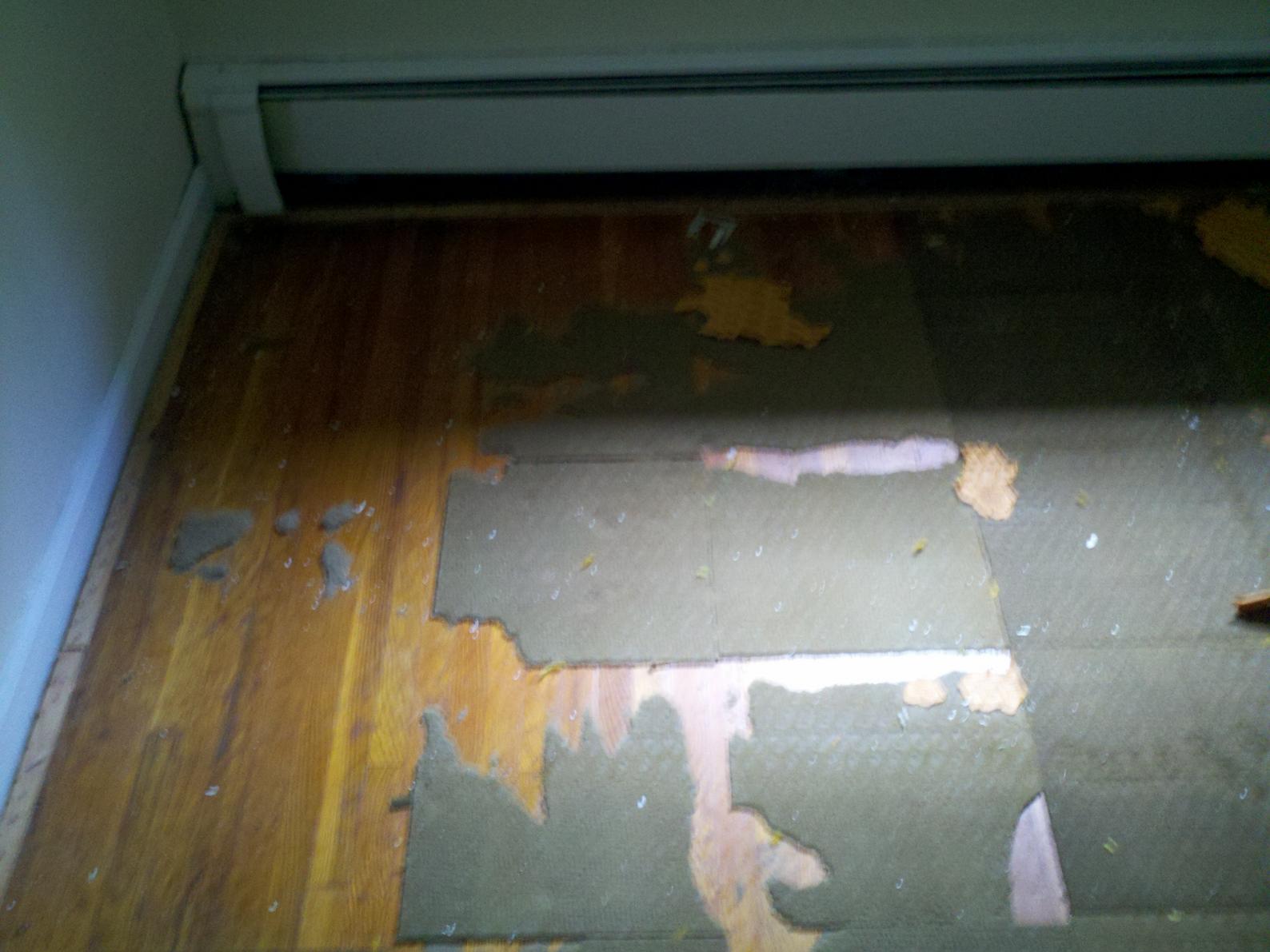

    So I pulled up my carpet in the small bedroom expecting a beautiful hardwood floor. The large bedroom was great, the small bedroom had Armstrong adhesive tiles stuck to it. Well, not even the tile, but the backing to it. The previous owner took up the tiles but couldn't get the backing up, so they threw the carpet padding on top of it.
    What a PITA to get up. First I used a plastic scraper (drywall tool) to scrape most of it up. First picture is pre-scrape.
    I tried Goo-Gone, which worked..ok, but not economically feasible as it would take buckets. I tried mixing it with Hot water, but it was as effective as just hot water, or nothing.

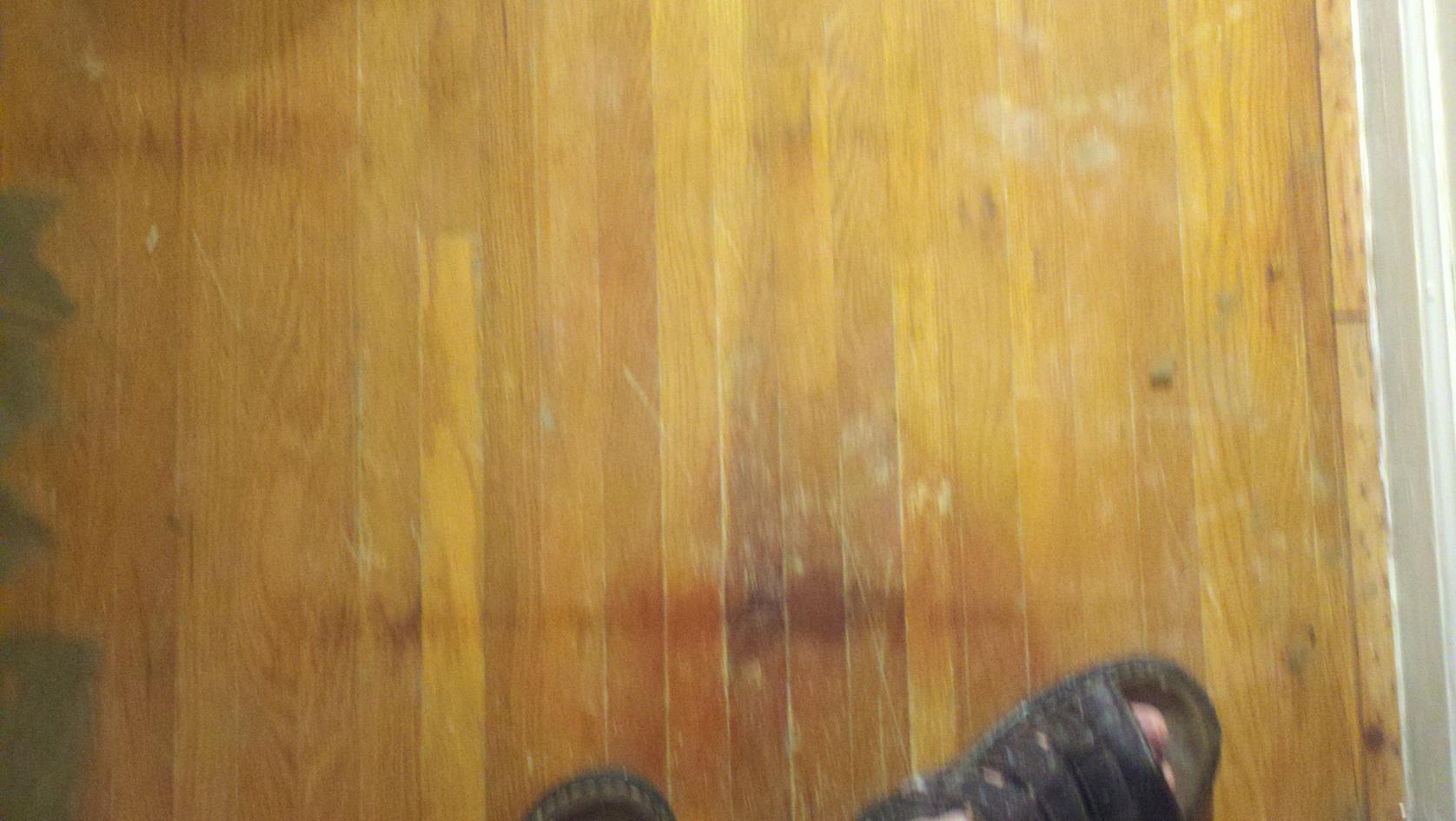

    I used denatured alcohol, but it tends to take some of the finish off. I guess I'll be refinishing it anyway.

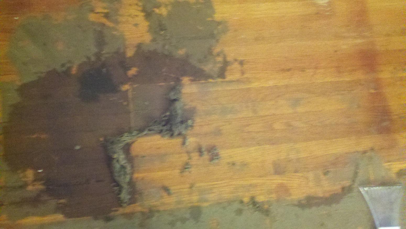

    The only thing that takes it off easy is Mineral Spirits. Pour it on, wait 5 minutes, and the adhesive comes off it one piece. And now I use a snow scraper from my car. (after I broke the other tool)

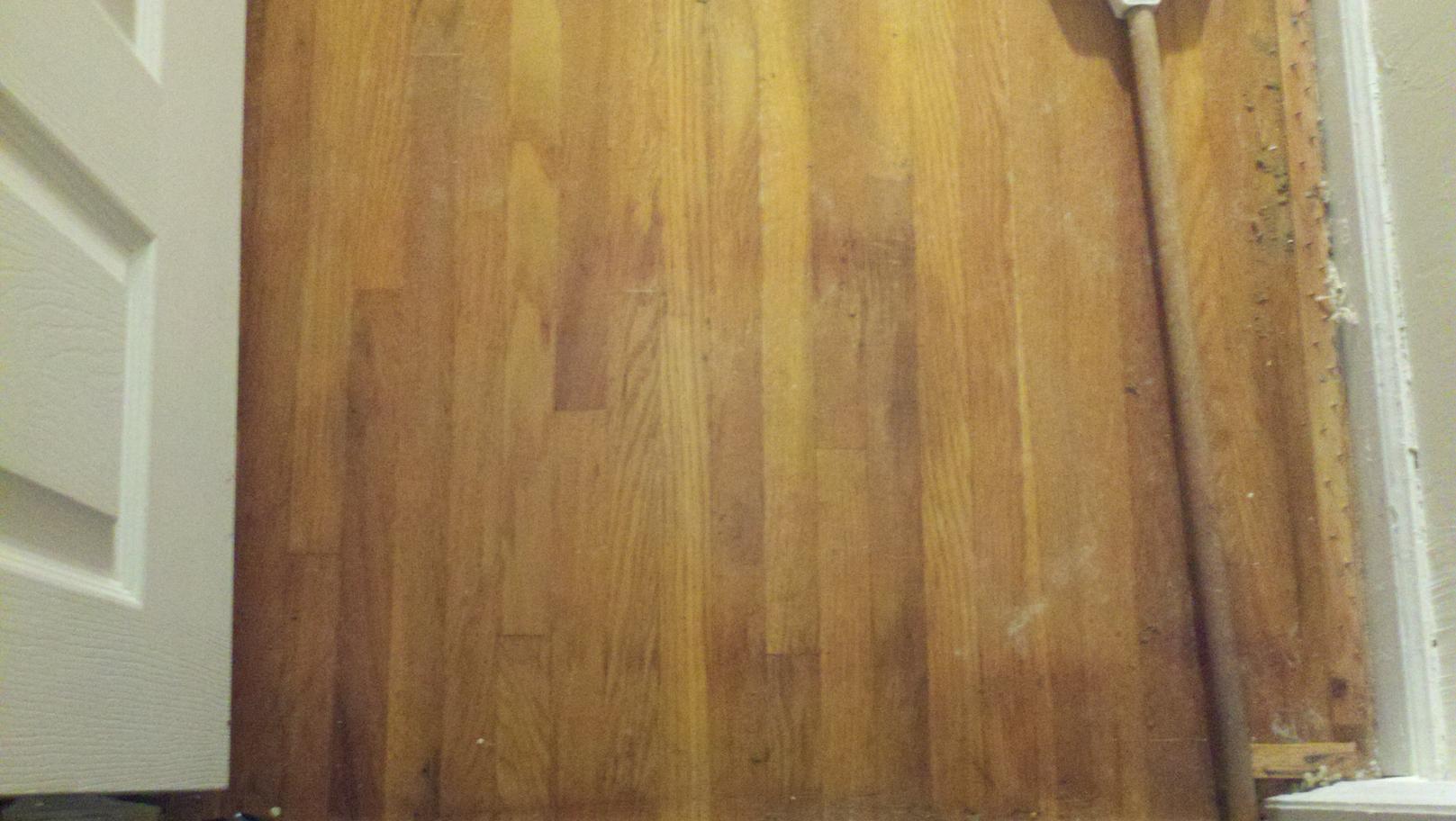

ID:	87611 goo gone, still dirty not scratched
ID:	87612 Someone used a metal scraper when I wasn't there.
ID:	87613See the whiteness from the denatured alcohol?
