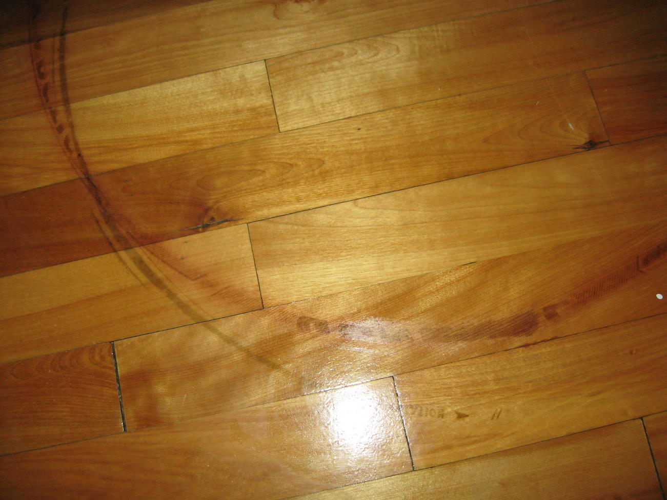

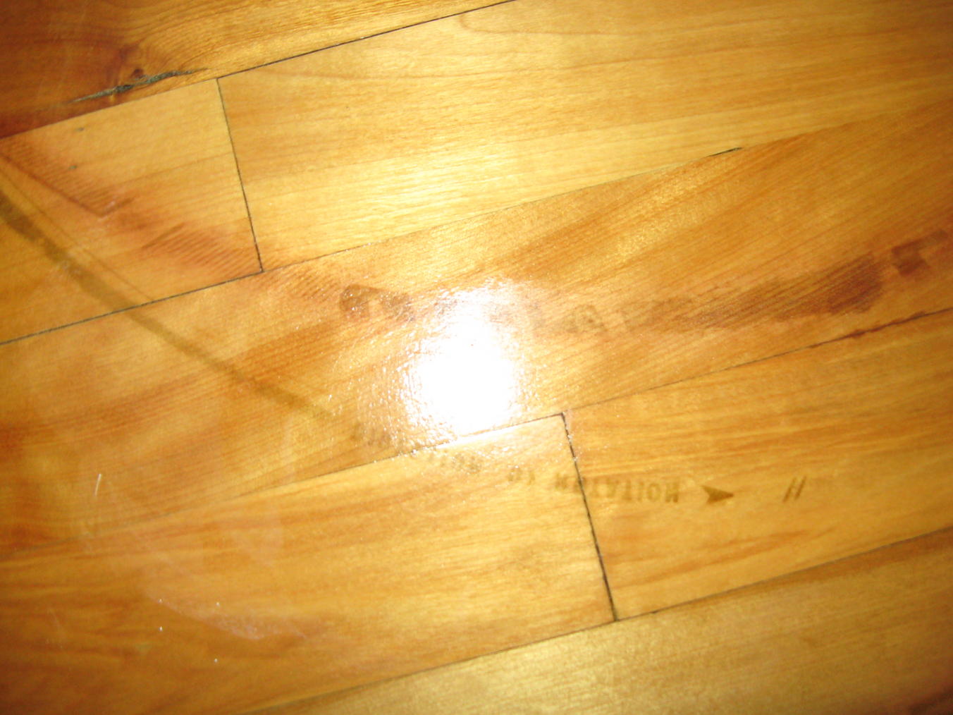

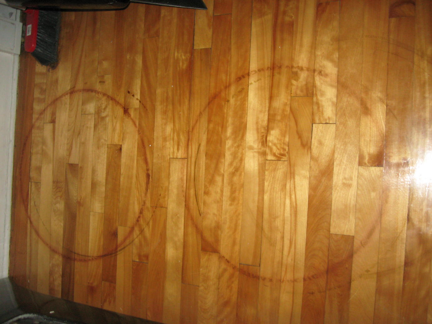

    get the drum sander and sand the whole floor. use fabulon for a finish

    yup, that the oils that leached into the wood. sanding is your only best bet. you could try acetone but you'll refinish the floor anyway.

    Ok look, i'm having a bad day ....
    I have left on the floor some winter tires. Now need to change them on the car and i see bad marks on the floor.
    It's like the contour of the tire left a print mark on the floor....
    I have tried all kind of stuff... magic eraser, lighter oil, degreaser of all sort .... now, the only option i have left was to sand the damn thing out...
    Obviously i just cant sand the wood floor because it leave bad marks on it ...
    What are my options.. PLEASE I NEED DESPERATE HELP...
    Here's some pictures
    P.S. The mark seems really encrusted in the floor...inside of it... The only method i was able to remove some was to sand the floor with 80 sand paper....
