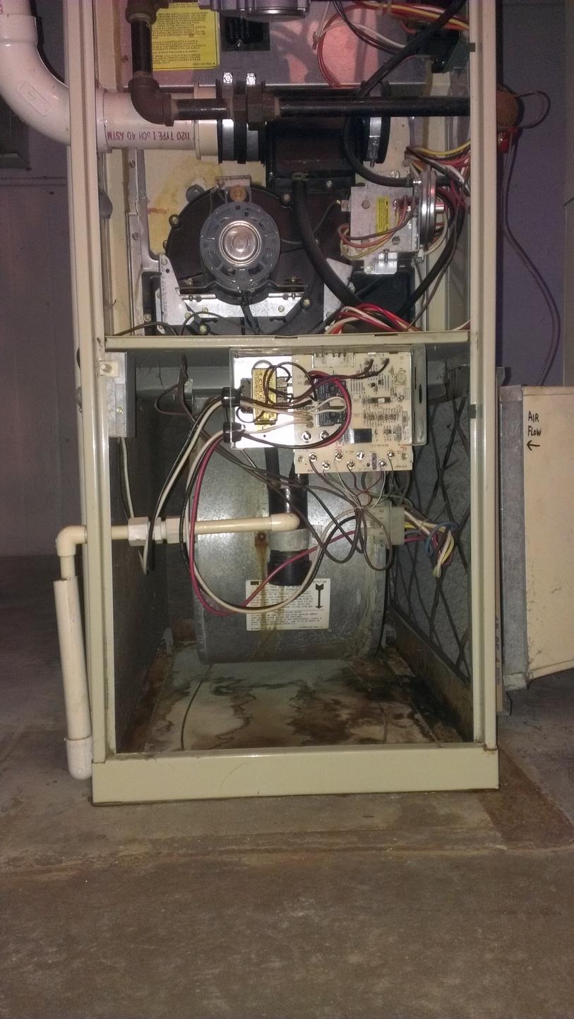

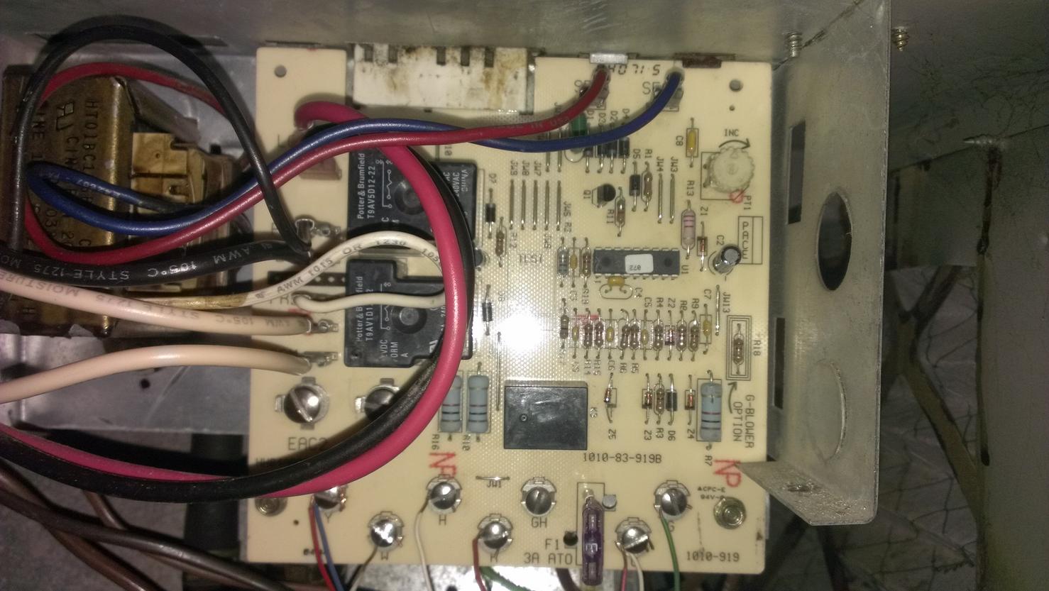

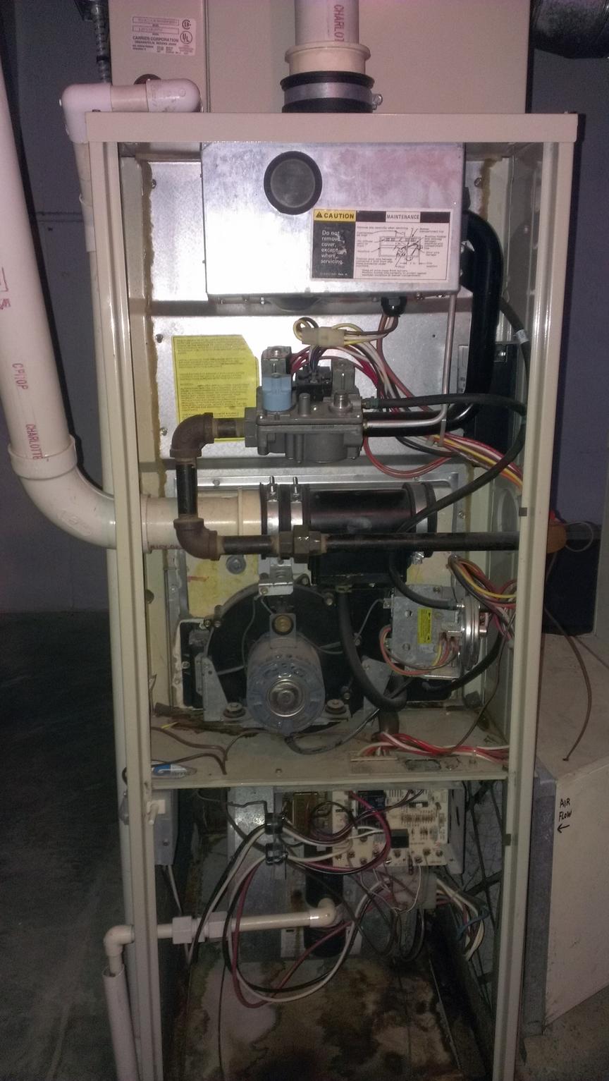

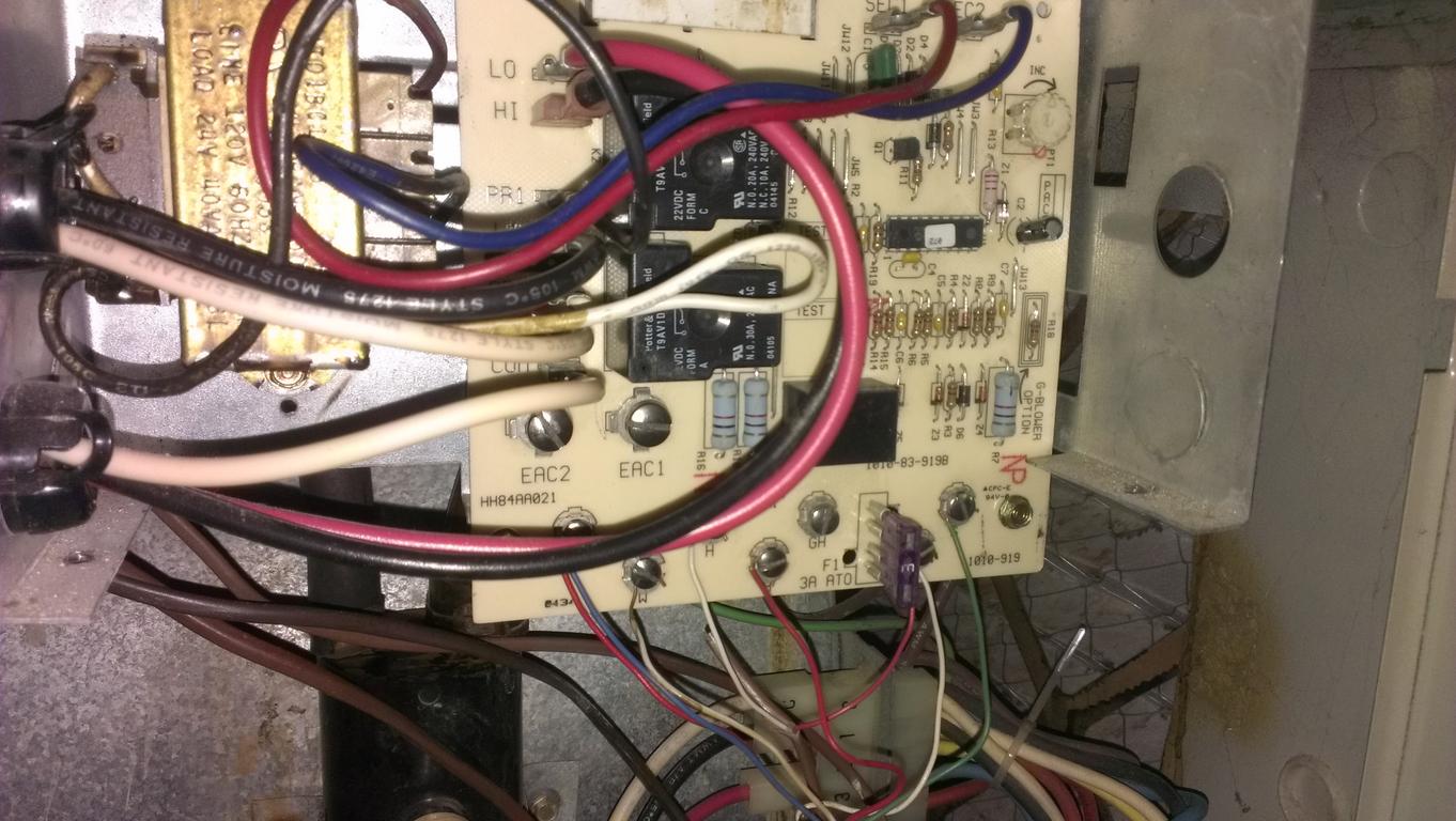

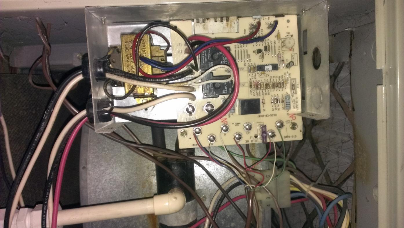

    Here are some pictures of the furnace, including closeups of the control board.

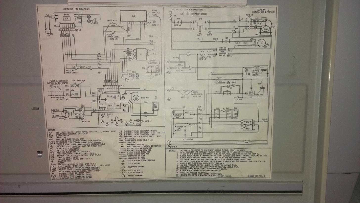

      wiring diagram
ID:	87277Click image for larger version
ID:	87276Click image for larger version
        #18
        wiring diagram
        I got your wiring diagram. Copied it so I can increase the size of it.
        Upon examination of it all I can see is a flame detect relay switch [as they describe it]
        I'll have to look further but I think they're using the spark electrode as an ignition device AND a flame sense.
        Another thing is, why would the gas valve have a manual pilot knob if the system only comes on when the system creates a spark?
        The manual pilot knob must be pressed to open the pilot valve, then turned to ON after the pilot is lit.
        So that tells me it is a standing pilot.
        Oh yeah, on the controller board, check the fuse. Replace it if its blown. It seems that it is inline with the flame sense relay.

          After reading many articles on the internet about high efficiency gas furnaces, I was under the impression that the pilot system type is an intermittent one, or an on-demand type. I am not an HVAC technician but I enjoy fixing appliances and other things around my home. I am relatively handy, but furnace problems can be tricky, so I am looking forward to helpful assistance from the experienced people on this great forum, such as yourself.
          In the past, I replaced the control circuit board and the blower. That is my experience with furnaces. The circuit board was replaced about four weeks ago, but I will inspect the fuse.
          I will wait to see what you determine about the possibility of the spark electrode also doubling as a flame sensor.

            You have a White Rogers 36 E gas valve. None of these valves have a standing pilot. Your furnace has either a Proven pilot or Cycle Pilot system. Due to the type valve you have I think you have a bad gas valve or a circuit board problem. If you have trouble getting to the bottom of this call a good gas tech and he could troubleshoot this quickly. I could not attach the PDF file as it's too big. This is the link to the file:

                Thank you for determining the make and type of the gas valve. I will reinspect the control board for the ignition system and the one I recently replaced for damage.
