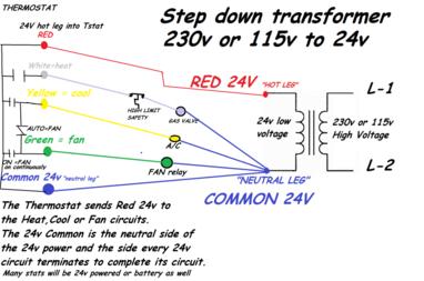

    can you supply me with a schematic diagram? go buy a cheap multimeter if you don't already have one. I'll look through the diagram and give you ideas to check.
    the thermostat is just a switch, nothing really complicated with it. a flame rod is a flame detector. it will shut down the burner if no flame. do you have a standing pilot?

        A standard Honeywell or Robert-Shaw thermostat uses a bi-metallic switch or a mercury switch in the Honeywell.
        Electronic will use a relay or a magnetic reed switch.
        Induced fan and exhaust duct will use a sail switch, normally open unless an air flow is detected, then it closes.
        High limit switch is normally closed and opens when its limit is reached, May be mechanical and physically opens a set of contacts or a bi-metal which springs open under high heat. [automatic reset]

                  If you had the schematic it would have been much easier to give you an idea what to look for. So, we'll be shooting in the dark!
                  If there is an exhaust blower, check for a set of normally closed contacts when blower is operating - air proving switch. looks like an aluminum pancake with tubes running out of it to the stack and two wires on it.
                  Next is a high limit - this would be on the plenum somewhere and would be normally closed when furnace is operating = opens on high temp.
                  Rollout switches - has to do with the burner
                  Flamerod you already know about.
                  Gas pressure pressure switch - detects gas pressure
                  Inline glow heater - glows when calling for a start - mounted near gas tube
                  The remainder has to do with temperature and circulating fan.
