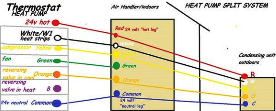

    Go to the thermostat and set the fan switch to the "on" position, if the fan comes on you have both high and low(24 volts) power and no need to check anything there, bypass the thermostat to test the unit. R to Y is the ac compressor. Click image for larger version
