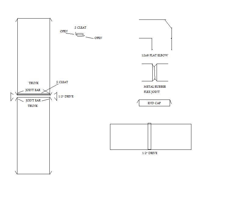

              OK. From what you've listed, the furnace ducting opening is on the backside approximately center of the furnace, or the side of it at approx center. Coming off the furnace is a flexible transition fitting [ has a rectangular collar about 6 inches long with a rubber flex joint and another 6 inches of sheet metal duct.] This feeds into a 12X6 "turning elbow, downwards into a 12X6 trunk line. At the floor level the 12X6 goes into a Y fitting, traveling east and west into major trunk lines. The extreme ends are capped off. Floor registers are tapped into the trunk line on top of the line with a register boot. These could be 6 inches round to 10X6 rectangular to a floor box and steel register with or without a damper.
                Here is a supplier of rectangular duct work and transitional fittings. []Ductwork | Ductwork Supplies | Sheet Metal Ductwork
                I checked Home Depot and all they advertise is round 6 & 8 inch duct.
                Ductwork consists of "drives" these are flattened out U-s, 6 or 8 inches long that fit over the joints of rectangular trunk line. each trunk line has a quarter inch folded back side wall of the trunk that will accfept a drive. the long section of the trunk uses what is called an S cleat, half of which slides over one top part of the trunk and the other half slides over the other top part of the adjoining trunk. I'll make up some diagrams to try to make this point clearer. I used to make all my own trunk lines and parts only because I had access to a press brake.
ID:	87343Not sure if a local dealer or hvac contractor would have fittings on hand. anyways I'm sure he can make the trunk lines cheaper than pre-made ones. home depot shows one half of a trunk line costs $19.75 each so a complete trunk would be over 38 bucks. an hvac person can make a trunk in one piece with a pittsburgh joint.
                    ever hear the term "tin knocker?" if came about from the fact that trunk lines made in one piece had a pittsburgh joint, a half bent sheet metal part goes into a formed s joint and the flap would be hammered over the joint.
