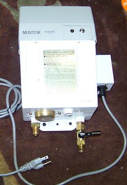

              I'm still having the problem. Tonight it was pretty bad, and I noticed kero was actually running down the side from under the top cover. I suspect there may be a shut off float problem? Here is a picture of an identical pump:

                Doug,
                Both Toyo and Monitor fuel lifters have a duel float system to make it all but impossible to over fill the tank. I my 15 years of working on these kinds of heaters using lifters I have never had a failure of the float system. That does not make it an all out impossibility. Dirty fuel or a gross amount of water with rust in it could cause the floats to stick. I would like to know how high the lifter is above the level of the fuel in the tank it is drawing from? The lifter should be located above the top of the tank it is drawing from. If not, it will siphon fuel into the lifter.
