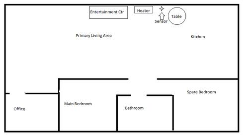

    The room sensor is very relative. It may not be anywhere near as accurate as a digital thermostat. Set the room sensor about eye height to start with. Set the temp at something that is going to give you a room temp that you can live with. When you have it set low there may be drafts in the room even after the stove shuts off. You mentioned 59 degrees as a start. With the economy plus on, the stove will have to sense 67 before it shuts off (8 degrees over set). I also believe you are expecting too much from your M2400. If the heater is in a back room or at the end of a hall, it may not heat rooms that are a fair distance from the unit. As I stated, the room sensor is relative. Try setting it at some point that heats up your spaces to a comfortable temp. Can you draw us a diagram of your floor plan and show us where the heater is located?

      That is somewhat what I was afraid of Tom. I have actually set the thermostat wire on top of the digital thermometer and it will go from 66-60 while the digital thermometer changes from 64.5 to 64. Overall we are able to keep the house at a comfortable temperature, it just gets a bit annoying when at night it is turning on when the house is 64 and then turns off again when it is at 66 when we don't want it to come on so soon but during the day the house is 59 before it turns on. I am guessing this is from drafts but overall the house seems well insulated as it doesn't lose heat fast. I have attached a rough schematic of the house and the overall outside dimensions are roughly 40x25. As you might suspect, the office area gets a little chillier than normal but not by much and I have a small space heater to take the edge off in the morning. The orientation of the heater to the opening of the bedrooms also seems to keep them at a nice stable temperature. I was just hoping there might be a way to get the thermostat to read more accurately such as by making the wire longer to get it away from the source of the heat and the outside walls to stabilize the temperature but I wasn't sure if this would cause incorrect readings by changing the wire length? When I put the wire up higher it turns off too soon (usually) but then turns on at about the right temperature. When I put it about waste high, almost behind the table, it runs until it is supposed to but then it kicks on earlier than I want it to as I suspect it may be getting poor circulation behind the table. I fear this may be a losing battle on my part and I should just be glad the heater runs splendidly now I was just hoping to take advantage of the economy mode more.
Name:	House Schematic.jpg

        You have the perfect layout for a vented heater. Your common space is all together. Your heater should keep them nice. As you have found the bed rooms and office will be a little cooler. You might think about a fan on the ceiling to help move some of that warm air downward. For your office you could think of a room to room fan in the wall with a line voltage thermostat. Put it up high so it will blow the warmer air into your room. These room to room fans don’t work too well for bed rooms, as they make some noise. When using the Economy Plus feature you should see a 8 degree rise on the stove indicator temp and then the unit should cycle. I use the Eco feature on my M441 all the time. I have the room sensor on the back right corner of the stove and that works fine. You have to be able to put up with the large swing in room temp in order to use the feature. The Economy Plus feature has its draw backs, however it will help your stove go much longer between overhauls. Don’t cut the wire for the room sensor. There is no need to do this. If you are worried about the temp just turn the stove up some. You will find a spot that will be fine for the whole house eventually.
