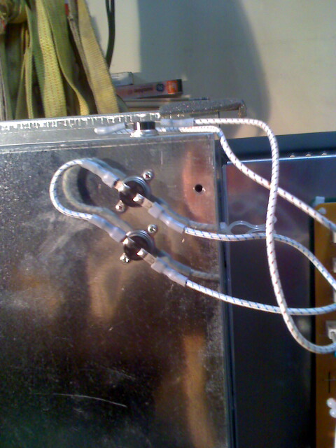

                I appreciate the reply, Tom. It ran so well all winter until the last week - but I took your advice and added and replaced it with a second 422 . I tried to download a pdf service manual online, but the printing is unreadable. My circulation fan runs on low when the heater is plugged in, even when unused. I assumed a stuck relay or bad capacitor, but lack a wiring diagram. Thanks, Gary

                  Gary, Are you talking about the M422 fan running all the time? If so you have the fan and over heat wires in the wrong place. I do not have a M30 manual in PDF. It may take a few days for me to answer as I'm off on a log raft trip for the next 4 days. Tom

                    I hope the weather favors your trip. Yes, the M422 fan. It ran fine as a temporary workshop furnace last year. Still runs great, but the fan is always on low after the unit cools. The fan starts when I plug the unit in, without turning it on. I mothballed the M30 until I'm established enough to make a decision
                      • 755
                      The blue wires go to the two overheat switches and the air safety switch. The red wires go to the fan thermostat.
                      We are looking at a good week end so it should be a dry trip.
                      TomClick image for larger version
