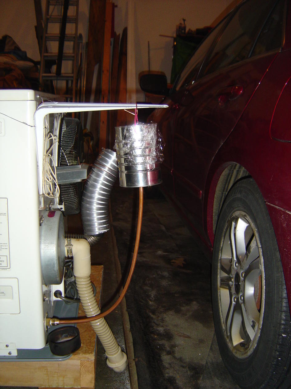

    I have no external fuel tank so I jury rigged a 1 qt coffee can so that the bottom of the can is 16" above the base of the heater to act as a fuel tank (yeah, I know, shade tree, red neck mechanic).

    Show us a picture of your fuel tank?

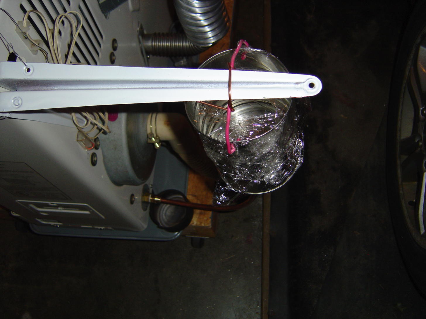

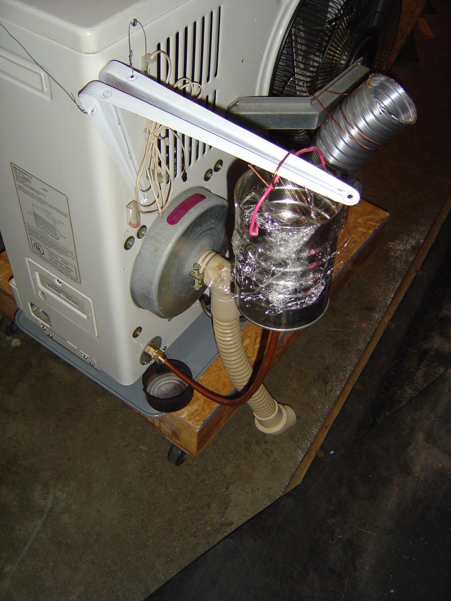

      There it is.
      The manual says that the bottom of the fuel tank has to be a minimum of 16" above the surface that the heater sits on. The set up is crude but hopefully it provides enough inlet pressure coupled with the fuel pump output
        • 755
        That tank is not high enough to give you the proper head pressure. Put it about the top of the stove and it might work.
