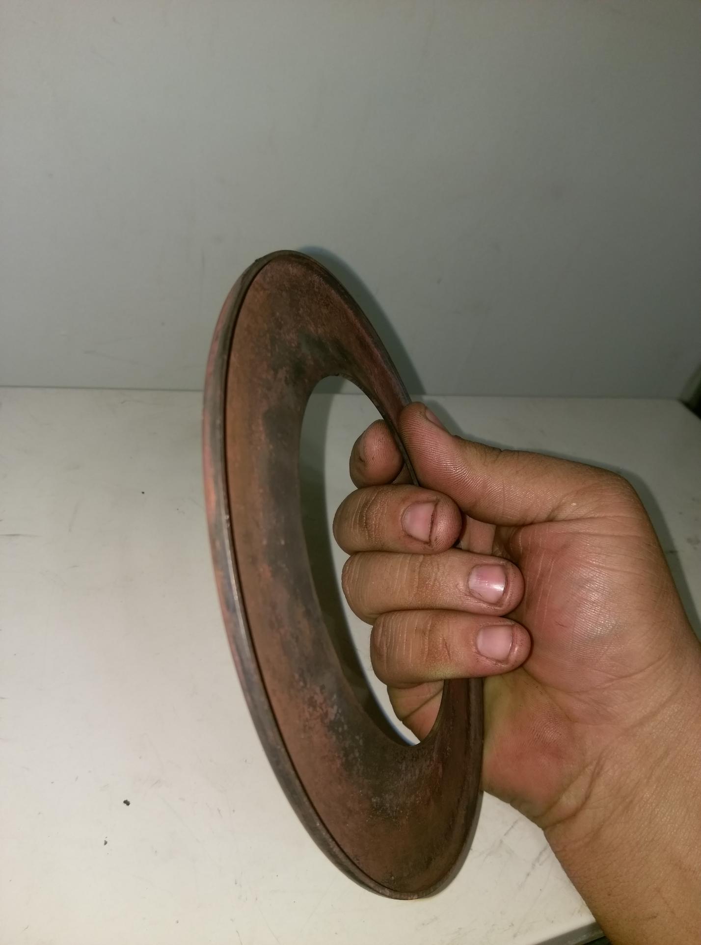

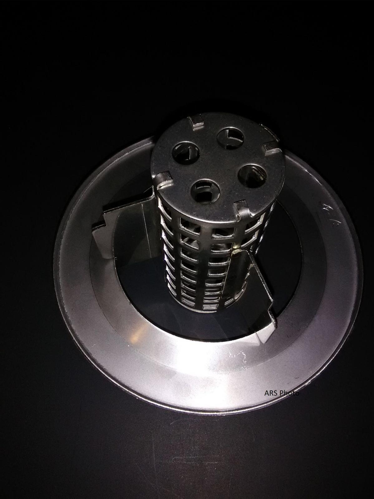

    I know this model doesn't use a burn mat, and i've had the burn chamber apart, but not removed, to clean it as best as i could. I'm curious if the center insert goes in a certain way? i'm wondering if it was put in upside down somehow. I made sure to install it as i removed it, but i'm still curious. If the fuel and air don't mix right i can see it not burning properly. There's a taper in the metal ring that's attached to the burn tube in the center of the burn pot. I"m not sure which was it sits, if the taper faces up or down. Click image for larger version
Name:	burn tube monitor 30.jpg
ID:	88024 Here's a generic photo of the center chamber piece. That taper in the center of the ring, does it face upwards towards the heater exchange or down towards the ignitor? There's also another metal ring in there that i'm guessing also directs airflow somehow. it looks like it would sit on that notched seat on the 3 center supports.

    The combustion ring is installed so that the tube with all the holes in it is upward. The flame spreader ring goes on to the tube with the holes.

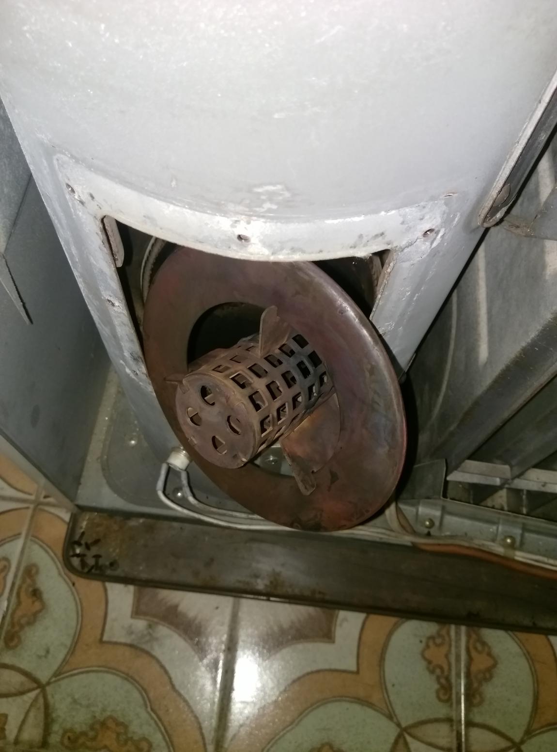

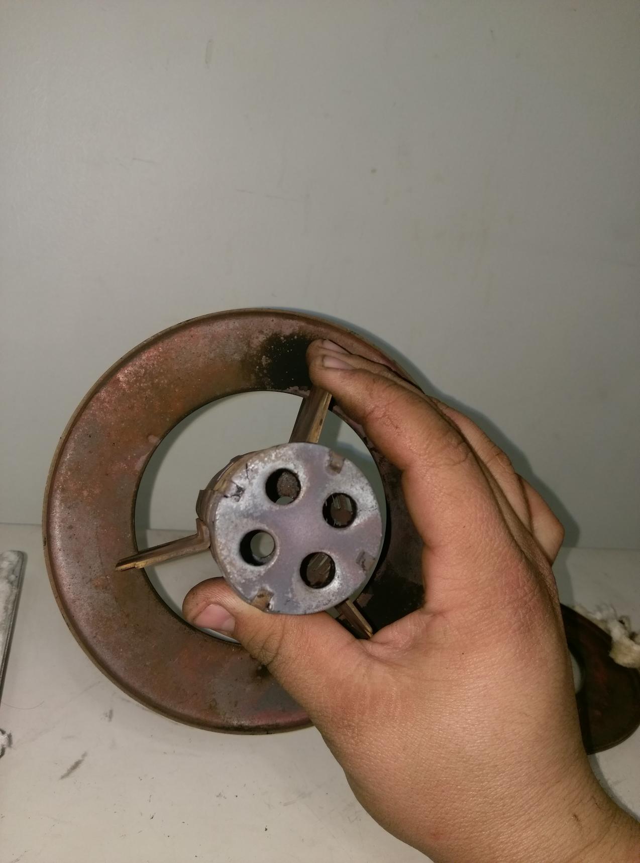

        I'll take pictures of the burn chamber i'm worried that the combustion ring assembly isn't in right. There's a second ring in there that sits on the edges of the supports attached to the center tube portion, for a total of two rings. does this sound right?
        There are 4 round holes in both the top and bottom of that perforated center tube, as well as square holes all the way around the sides of the tube.

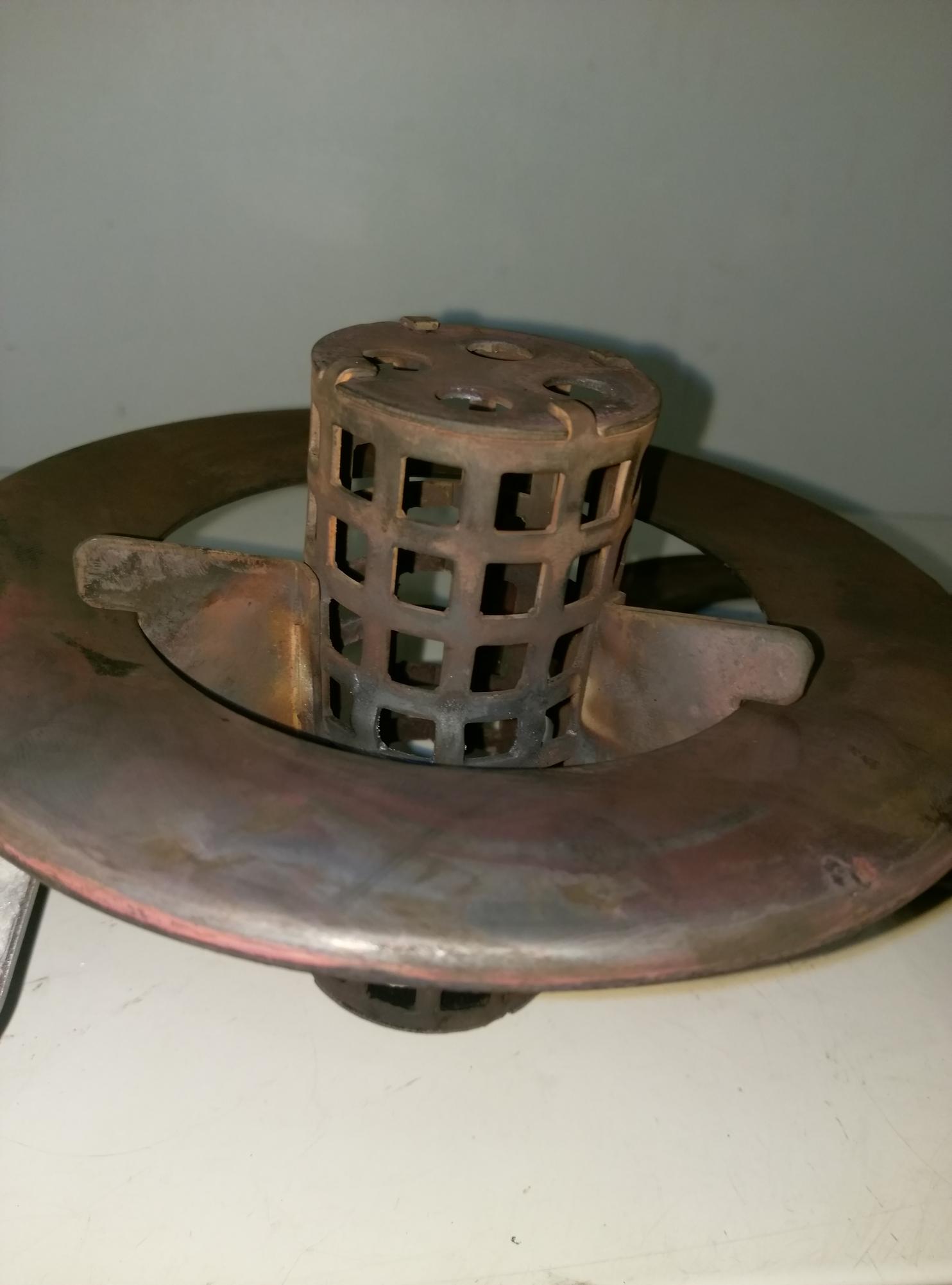

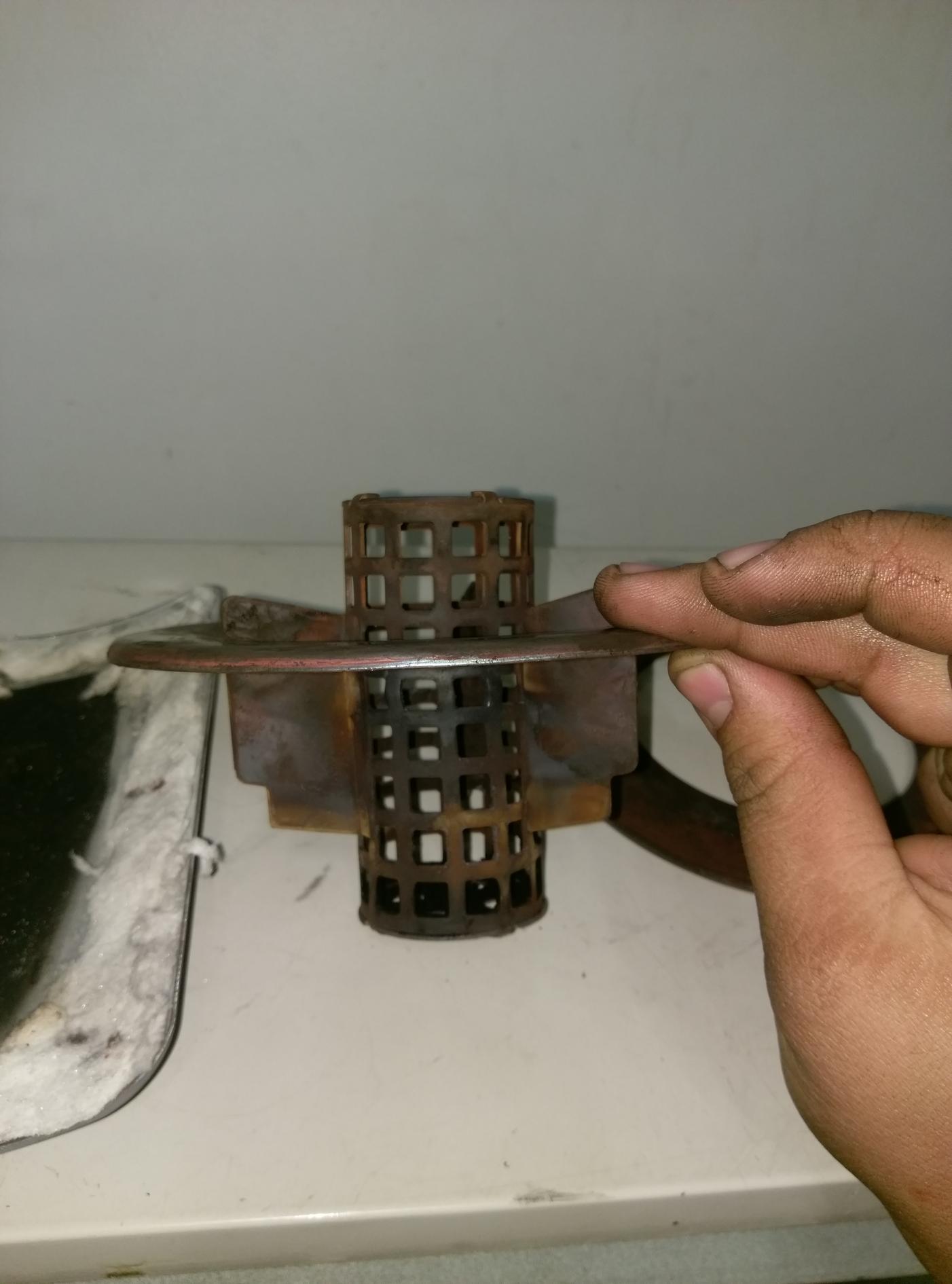

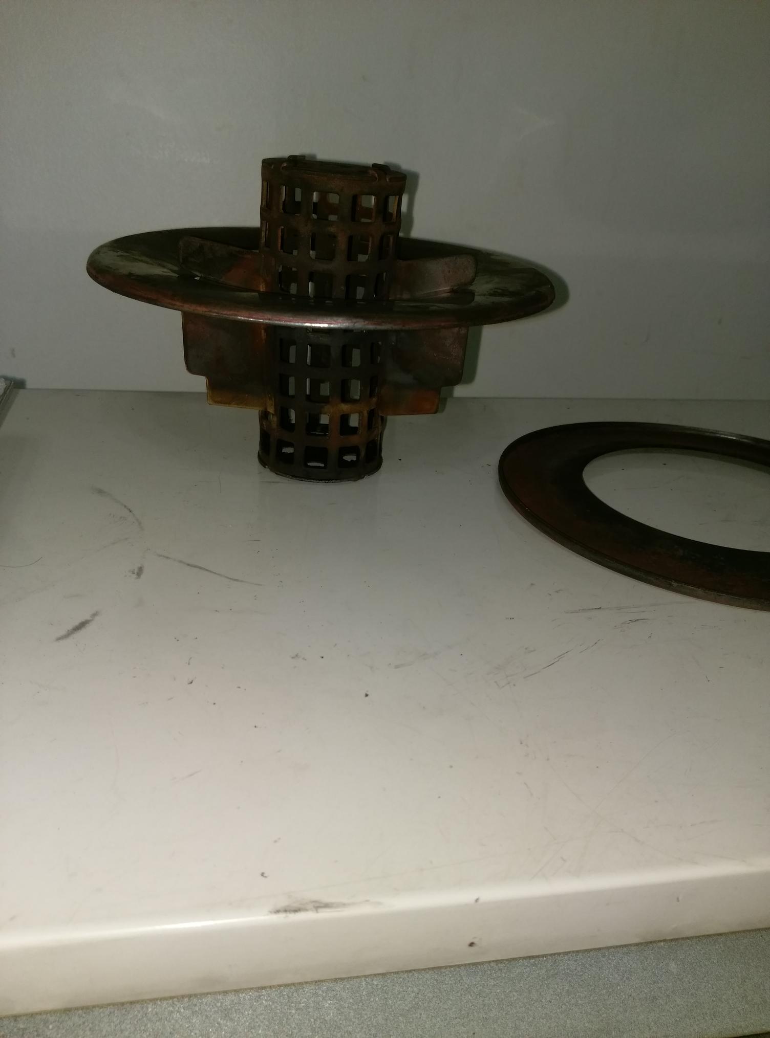

          Here are photos of what was in my burn chamber.
          The center combustion ring assembly. depending on which way its installed the center tube either touches the bottom of the burn pot or it doesn't.
          something tells me its not supposed to touch the bottom of the burn chamber, but i'm not 100% sure either way.

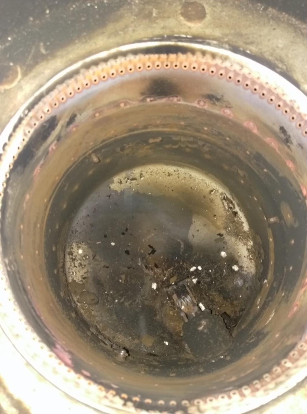

            My burn pot. I need to clean and vacuum it out before assembling it again.
            The bottom and top of this center portion is the same with 4 holes in each side.
            larger section of center tube facing up. are the notches in the supports for the first ring supposed to be for the second loose ring?
            larger section facing down. if installed this way into the burn pot the center tube touches the bottom of the burn pot. i'm not sure if the attached ring touches the little pins in the burn pot or not if installed this way.
            if installed this way does the second ring sit in the top of the supports?
              • 754
              The larger section goes up and the brackets are for the flame spreader circle.

                cleaned out and reinstalled. it is fuel related as there was a little bit of soot in there, and i cleaned it only a few days ago. i'm going to burn through what i have for this fuel while diluting it with fresh crystal clear K1 from the fuel station.
