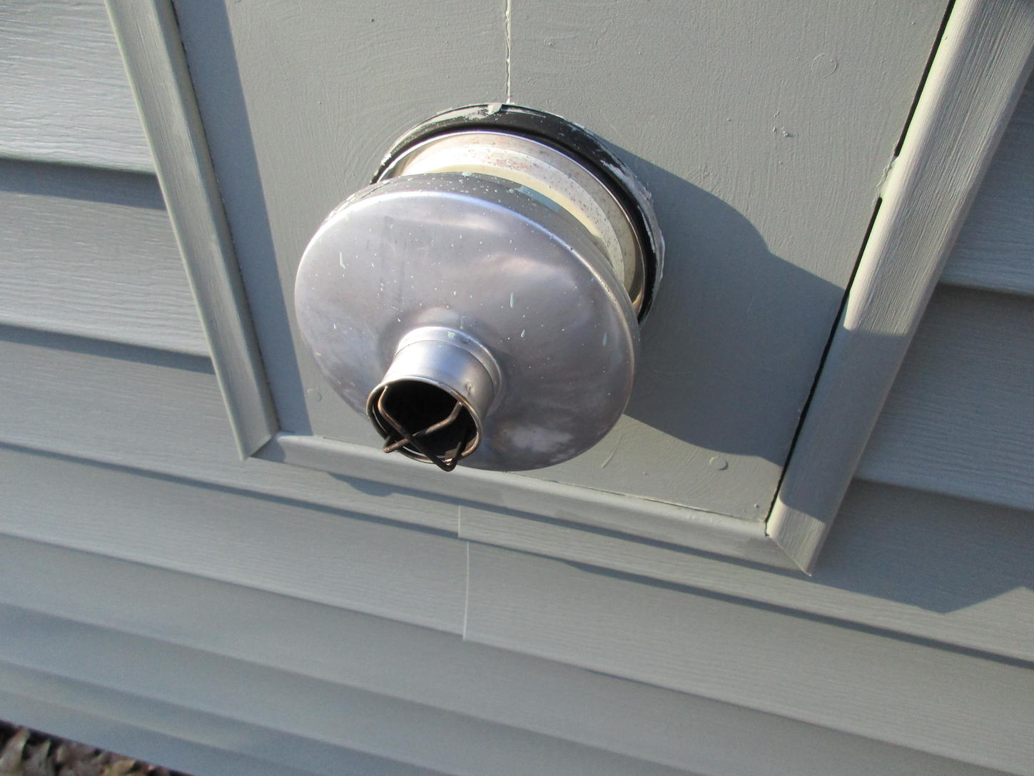

          Can you take a close up picture of the tip of your exhaust pipe? Thanks, Tom

            Here's the exhaust
