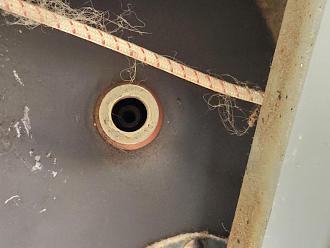

        Remove the copper tube from the burner pot and use paper clip, very small screwdriver or the smallest allen wrench 0.05 to check the hole if it's clogged up with carbon. If is, try to clean it and see what happens.
        The picture attached shows it full of carbon.

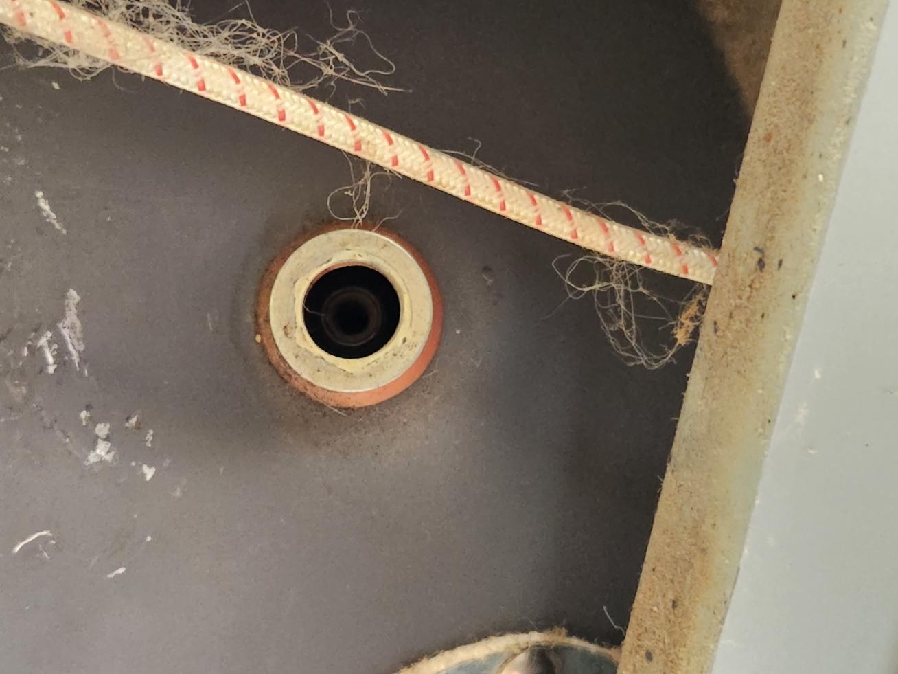

                      You never answered my question about cleaning/inspecting the burn chamber hole for clog Click image for larger version

                        The burn pot line got the drill bit treatment, and I poked/twisted a piece of 3/32 tig wire against the igniter shield.
                        The copper line had a piece of .035 mig wire ran through it and compressed air.
                        Both passages are clear.

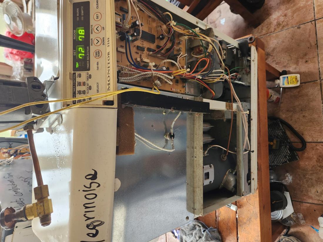

                          I am working on m2200 similar to 2400 but smaller, kept getting the E13, cleaned the solenoid pump and now it's running perfect, if you want to try let me know and I will show you how. You will a can of carb cleaner. it's worth a shot. the picture is a proof. Click image for larger version
