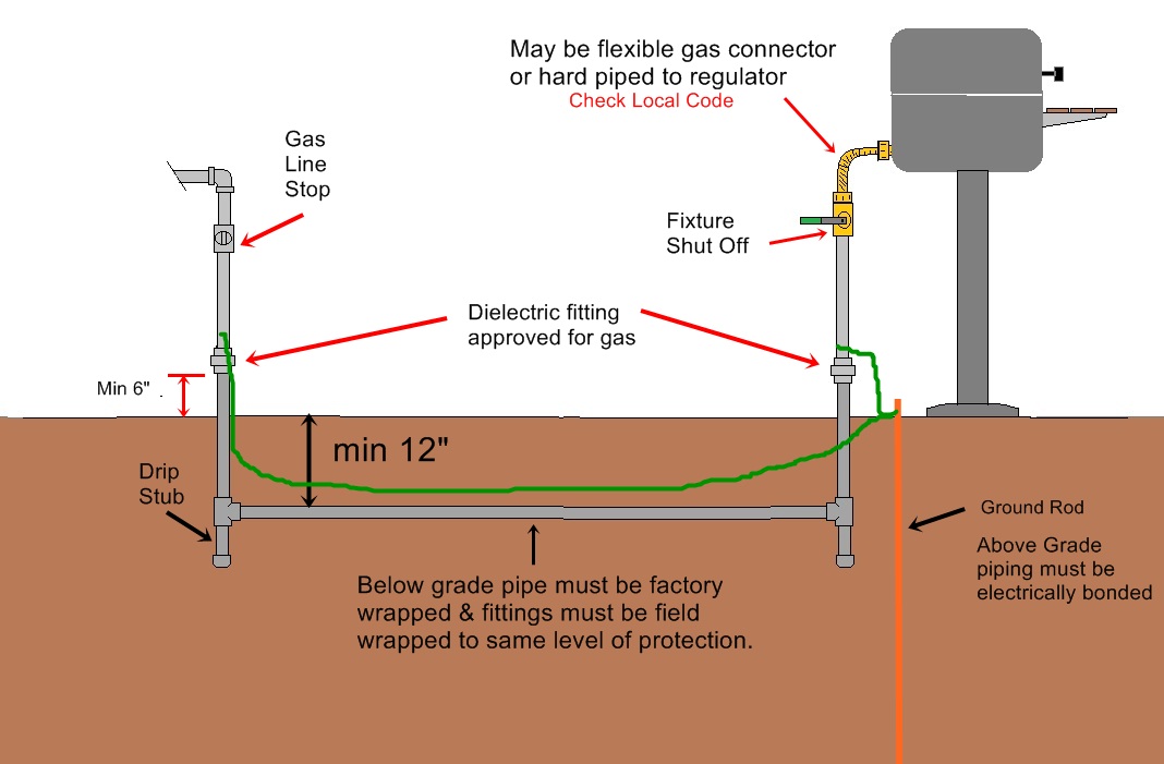

    was not sure were to post this but my father was a plumber and he did the work so figured why not. ok i have a gas line ran to my grill in yard at home. it was ripped up when they fixed a wall in my yard about 2 months ago. you can see the line was bent and i would like to replace it. it needs to be fixed from the valve shut of to the grill. my question is what kind of line should i run and is it being shut of at that valve good to work on or do i go further back. the pipe only needs to be ran about 3 feet down wall. one foot is into the ground then 5 feet to grill and then one foot up to grill. i am tempted to do it myself it seems easy but not sure any help would be wonderful. thank you

    They say a picture is worth a 1000 words,,,,so I drew a picture of how to do it with black iron pipe.
    You may be permitted to use CSST pipe if its approved in your area...if so let us know and I will make an illustration for that tooo
