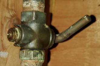

    Is this gas valve off?
    This is the gas valve connected to my dryer. I need to replace the dryer and this valve didn't work like I expected. Initially the handle was inline with the pipe pointing away from the camera. It's a real bear to even move but I got it to were it is in the picture but is that the off position or does it need to be inline with the pipe but pointing towards the camera? Just to clarify it's not at a 90° angle to the pipe but a bit past 90° Maybe 110°.

    From what I can see in the picture, it looks like you've got a typical gas ball valve there. These valves can be tricky to operate, especially if they're old or haven't been used in a while. Usually, when the handle is in line with the pipe, it's open, and when it's at a right angle to the pipe, it's closed. In the image, the handle seems to be stuck at an awkward in-between angle, which isn't ideal. For safety, you'll want to get that valve fully closed before disconnecting your old dryer. That means turning it until it's perpendicular to the pipe - a quarter turn from where it started. If it's really stubborn and won't budge easily, it might be best to call in a pro. They can make sure everything's shut off properly and maybe even replace that valve if it's seen better days. The last thing you want is to mess around with gas lines if you're not 100% sure what you're doing. Better safe than sorry when it comes to gas!

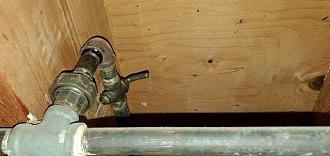

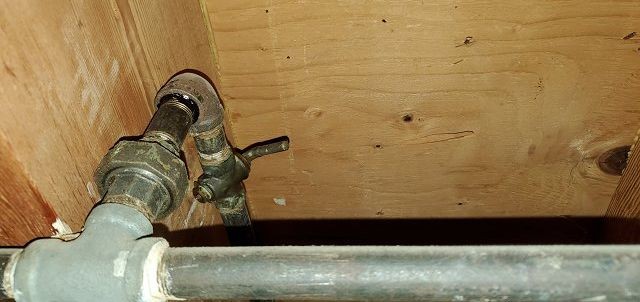

      A closeup of the valve. Don't ball valves typically have a barrel center? Like I said I was able to move this from being inline, 0°, to about 110° to were it is now but it doesn't want to go past that. Also most ball valves have a stop at 90°. I could go back to 90° but there's nothing to insure that the valve is fully closed. I tried looking the valve up online and mostly what looks similar are plug valves but that still puts closed at 90° so why did it go to 110°? That's what caused the confusion.

        I appreciate you providing that closeup image - it really clears things up. You're spot on in your observations, and I can see why you're puzzled. What we're looking at here isn't a ball valve at all, but actually a plug valve. That explains why it's behaving differently from what you'd expect. Plug valves can be trickier beasts - they often don't have that clear 90-degree stop you'd find in a ball valve, and they can sometimes turn beyond that point. The fact that you've managed to rotate it to about 110 degrees without a clear stopping point is a bit concerning. It suggests the valve might be pretty worn out or not functioning quite right. Typically, the closed position for a plug valve should be at 90 degrees to the pipe, but without a definite stop, it's hard to be certain. Given how old and finicky this valve seems to be, and considering its crucial role in gas safety, I'd strongly recommend getting a pro to take a look at it. They can make sure it's actually closed properly and assess whether it needs replacing. Since you're already in the process of switching out your dryer, it might be a good time to think about upgrading this valve to a modern quarter-turn ball valve. That would give you much clearer open and closed positions and be easier to operate.
