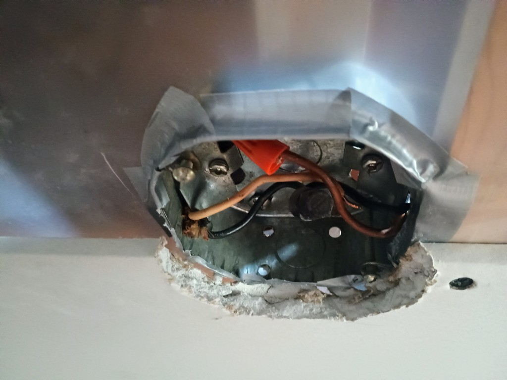

    I'm in the process of renovating my house including installing drywall. I just installed one of two ceiling panels in the spare room and discovered that the bottom of the electrical box isn't flush with the surface of the drywall (see pic). It is recessed by about 1/2" or so. Is it absolutely necessary for me to lower it so that it's flush with the drywall? Or, does it depend on what I plan to connect to the box? I'm just planning to install a light fixture (see pic). TIA

    It does matter, and the fix is easy. Electrical code generally requires the box to be flush with a combustible surface like drywall (recessed boxes are only allowed on noncombustible surfaces, and even then by just a little). More practically for your fixture: most ceiling fixture straps and mounting screws are sized to reach a flush box. A box recessed 1/2" behind the drywall means the strap won't seat properly and the fixture may not sit tight against the ceiling, or the mounting screws won't have enough thread to grab.
    The fix is a box extension ring (sometimes called a "mud ring" or box extender) — it screws onto the existing box and brings the front edge out flush with your drywall. They come in different depths (1/4", 1/2", etc.), so measure your gap and grab the matching size. No rewiring needed, and it's a 10-minute fix once the ring's in hand. Just make sure power's off at the breaker before you touch it.

      HB - I re-jigged it so that it was flush with the surface of the drywall. That said, thanks for the tip about the mud ring. I had no idea something like that exists. I'll keep that in mind if I ever encounter this again!
