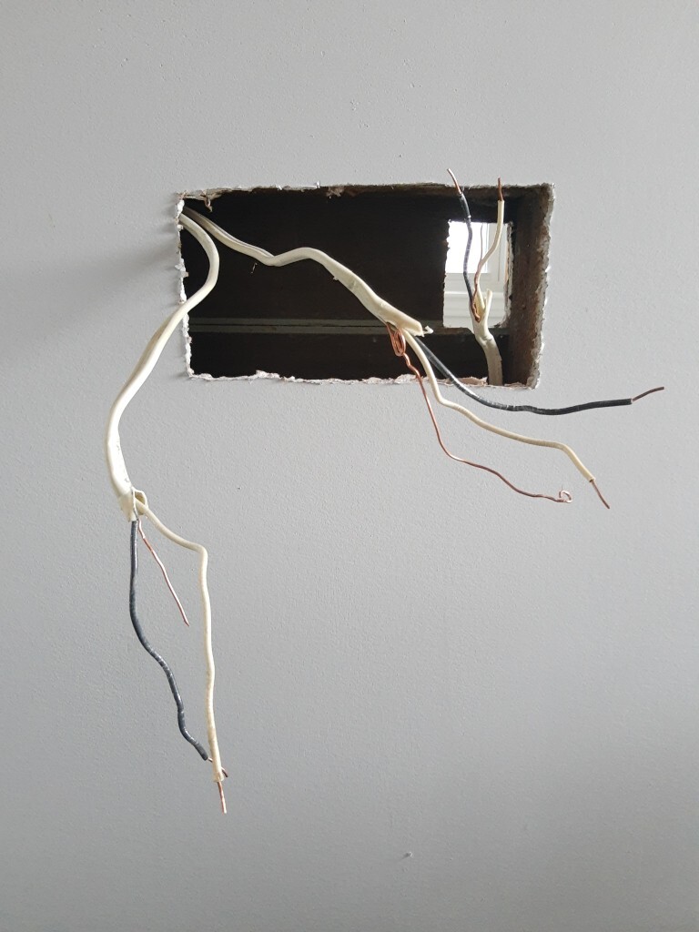

      I never did figure out the cause of the wiring fault and I was just going to let sleeping dogs lie. However, as it turns out I needed to rip the wall open to replace the receptacle box. When the contractor renovated my bathroom in 2011 he didn't secure it properly. Over time, it has become to the point that the whole outlet moves whenever I remove any plugs. Anyway, this is a pic of the 3 sets of wires....
      The cable on the far right is the "hot" wire. The other cables power the bathroom light and fan separately. The GFCI I'm using is a Leviton brand and (as expected) has both upper and lower neutral and hot terminals.
      Before I replace the box and re-wire the GFCI I'd like to get some electricians' opinions on the wiring configuration. For example, should the hot and neutral be connected to the Line side terminals and the respective white and black wires of the two other cables be pig tailed and connected to the Load side? Also, which of the ground wires (if any) should be secured to the box itself (using the screw at the back of the box)? Otherwise, which one should be connected directly to the ground screw while the other two are connected to it using a pigtail? TIA

        Welcome back Bodrey! It's good that you're taking the opportunity to properly address both issues while the wall is opened up. For your GFCI wiring configuration, here's what you'll want to do:
        Since you have three cables with the far right being your line (power source), you'll want to connect this incoming hot (black) and neutral (white) to the LINE terminals of your Leviton GFCI. For the remaining two cables that power your bathroom light and fan, you'll need to pigtail the black wires together and connect them to the LOAD hot (brass) terminal, and similarly pigtail the white wires together and connect them to the LOAD neutral (silver) terminal. This configuration ensures that both your light and fan circuits are GFCI protected.
        For the ground wires, the safest approach is to connect all three ground wires together using a wire nut with two pigtails - one pigtail will connect to the green ground screw on the GFCI receptacle, and the other will connect to the metal box's ground screw. This provides proper grounding for both the receptacle and the box.
        Once everything is connected, make sure to secure the new box properly to prevent any movement when plugging/unplugging devices. Before closing up the wall, don't forget to test the GFCI to ensure it's working correctly by pressing the test/reset buttons. Also, it's a good idea to label the load wires for future reference.
        Though I'm not a licensed electrician, just someone who enjoys DIY projects, I'd strongly recommend consulting a licensed electrician if you're not completely confident about doing this work yourself. Hope this helps!

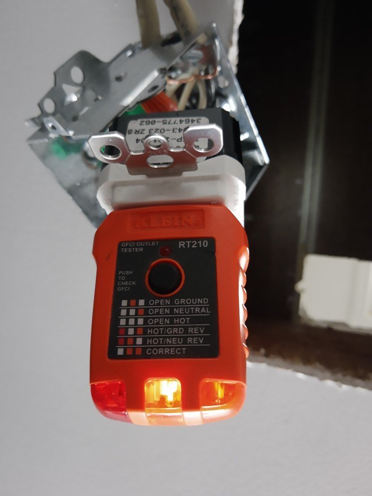

          I've got the GFCI wired as per your instructions. When I plug in the GFCI tester it (technically?) indicates that it's wired correctly. What I mean is, even though it's hard to tell from the pic the indicator on the far right is lit up, although it's far less bright compared to the middle indicator. I'm not sure if my tester works this way by design when testing GFCIs or if this still indicates a fault. The reason I say that is because when I press the button to test the GFCI it once again signals that the hot and neutral are reversed.

            Hmm. It looks like the GFCI tester is giving you conflicting signals, which can be confusing. The dim indicator on the far right suggests that the tester is detecting a "correct" wiring configuration, but the difference in brightness compared to the middle light might indicate a weak or inconsistent connection. The fact that you're getting multiple indicators, especially with one being dimmer, suggests there's likely still a wiring issue. Additionally, pressing the test button triggers a "hot/neutral reverse" reading raises some concerns.
            Make sure the hot (black) and neutral (white) wires are securely connected to the correct terminals on the GFCI. Hot should go to the brass screw, neutral to the silver screw, and ground to the green screw. If wires are backstabbed into the push-in connectors, try using the screw terminals instead for a more reliable connection. If this GFCI is protecting downstream outlets, ensure that the incoming power (line) is connected to the "LINE" terminals and any outgoing wiring is on the "LOAD" terminals. Swapping line and load can cause odd test results. Also, verify that the ground wire is properly secured.
            If the issue persists, plug in a lamp or other simple device to see if it functions properly. If it flickers or behaves oddly, there might be a loose connection or a neutral issue. If you're comfortable with it, a multimeter can help check voltage levels between hot, neutral, and ground to confirm proper wiring.
            Since the tester is initially showing "correct" but then indicating a reversal when tested, the issue might be intermittent due to a loose wire or a miswired line/load connection. Start by turning off power, carefully inspecting all wiring, and ensuring everything is securely connected.

              My particular GFCI doesn't have back stab connectors. Instead, it has something called back wire clamps. You insert the bare wire behind it and then tighten the terminal screw down to hold it in place. I tugged on the connections and they all seem to be secure. I also connected a lamp to it which worked fine - normal brightness and didn't flicker at all.
              I contacted Klein to inquire whether the dim right light on their tester is by design or does in fact indicate a wiring fault. I also plan to inquire with Leviton about the wiring configuration and to ensure that the GFCI is in fact labeled properly. Perhaps the GFCI itself is faulty (unlikely but who knows).

                The back-wire clamp system is generally reliable, but it’s good that you verified the connections. Reaching out to Klein and Leviton is a smart move.
                In the meantime, if you have a multimeter, you could check the voltage between hot, neutral, and ground to see if there’s anything unusual. If everything checks out but the tester still shows conflicting results, it might be worth testing with a different GFCI tester to rule out any inconsistencies with the Klein unit. Keep me posted on what you hear from Klein and Leviton. I’d be curious to know if they provide any insight that helps clarify this.

                    I tested the wiring using an analog multimeter and this is what I found:
                    - Voltage between the hot and neutral wires was within normal range (120V)
                    - Voltage between neutral and ground was near 0V as expected
                    - Voltage between hot and ground was only about 75V! So, there's definitely something odd going on
                    JM - The wiring being used appears to be the newer NMD90 standard (white sheath). However, it's easy enough to reverse the wires on the GFCI temporarily just to see if the hot/neutral reverse fault disappears using the tester.
                    Machinist - I plugged the tester into the GFCI above my kitchen counter and both indicator lights were equally bright. So, the issue is not with the tester - it's either the circuit or the GFCI itself.

                      The 75V reading between hot and ground is definitely a red flag. This suggests there might be a loose connection or a poor ground, which could be contributing to the flickering light and sizzling sound.
                      Since you've confirmed the tester is working correctly by checking your kitchen GFCI, we can narrow this down to either a ground path issue in this specific circuit or potentially a faulty GFCI unit. Before replacing another GFCI though, I'd recommend checking the ground connections at all points in this circuit - particularly at the panel and any junction boxes along the way. A compromised ground connection can create exactly the symptoms you're seeing.
                      If you're comfortable doing so, could you check the ground wire continuity from the GFCI box back to the panel? This might help pinpoint where the ground path is being compromised. Just be sure to have the power off when testing continuity!
