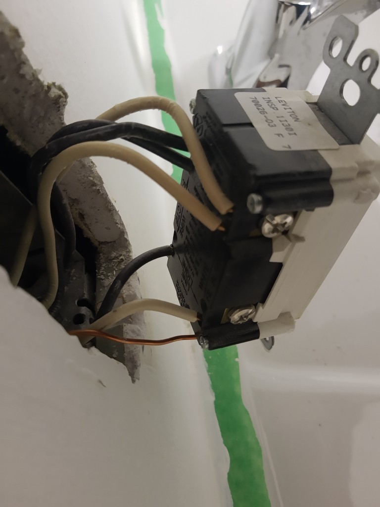

    Recently, when turning on the bathroom light I've noticed a sizzling/crackling noise coming from the GFCI receptacle above the sink. In addition, the light bulb flickers. I plugged my Klein circuit tester into it and it's telling me that the hot and neutral connections are reversed. However, as you can see from the pic all of the black wires are connected to the brass terminal side of the receptacle, and the white wires (neutrals) are connected to the silver terminal side of the receptacle. It appears to be wired correctly.
    Click image for larger version  Name:	GFCI.jpg Views:	3 Size:	89.5 KB ID:	97742
    Now, as you can see there are three sets of cables connected to the receptacle. Two sets of cables branch off and lead to the bathroom light switch and fan...
    Is it possible that the wires going to the light and/or fan switches are connected improperly and that that is where the problem lies? Or, is it possible the GFCI itself has become faulty and is throwing out a false "incorrect wiring" signal? The light and fan switches have always worked properly, and it has only been in the last few weeks that the light has started to flicker and that the GFCI has been making the crackling noise. TIA

    From the picture, it looks like the wiring is done correctly with the black wires connected to the brass terminals (for hot) and the white wires connected to the silver terminals (for neutral). However, just looking at it doesn’t always tell the whole story. A loose connection might not be visible but can still cause the crackling sound you’ve been hearing, as well as the light flickering.
    One of the next steps would be to make sure all the connections are tightly secured. Sometimes, even if everything is wired correctly, a slightly loose wire can cause electrical arcing, leading to the noises and flickering. If everything seems secure but the problem persists, it’s possible that the GFCI itself could be faulty. Over time, GFCI outlets can degrade, especially in bathrooms where moisture is more common, and that might explain the reversed hot and neutral signal from your tester.
    I’d recommend checking all the connections first, and if the issue isn’t resolved, replacing the GFCI might be a good idea. If the problem continues even after replacing the outlet, then it could be something to do with the wiring leading to the switches for the light and fan. If that’s the case, it might be worth checking those connections or bringing in a professional to ensure everything is safe.​

      TT - I re-seated all of the connections on both sides. Some of them had a little bit of copper exposed beyond their respective insulation. So, I trimmed them back as necessary. I know these backstab connectors are not reliable, but I tried pulling on each wire before I loosened the screws and they were all secure. However, I think the backstab connectors on this GFCI provide a more secure connection than those on a regular receptacle (they're held in place by tightening the terminal screws). In any event, after re-testing I got the same result - "hot and neutral reversed".
      I also checked the connections on the light and fan switches. Although the wires on each of the switches are connected to the backstab connectors and not the terminals, I don't suspect that either of these switches is the problem. The neutrals are firmly secured using wire nuts and electrical tape. The only thing I noticed that was somewhat unorthodox was that there were two pairs of ground wires (tightly bound but not secured with wire nuts) but the two pairs were not bound together. Again, I don't think this is the cause of the fault, but I can take a pic of the light/fan wiring and post it if you'd like to see it.
      Moisture could certainly be a factor, and in addition as you stated the GFCI itself could be faulty. I'm leaning towards that as being the problem. Easy enough to swap out to confirm. The one installed is also not of "Weather Resistant" (WR) grade. So, over time moisture may have degraded the connections.

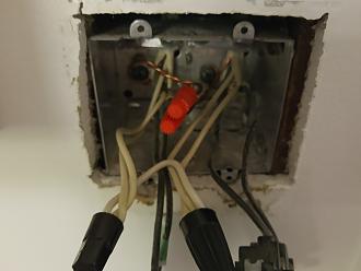

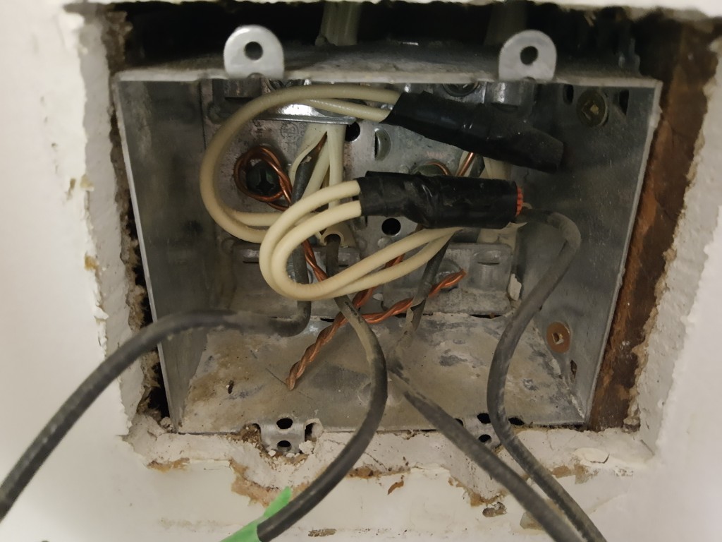

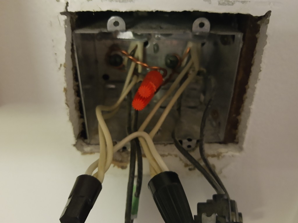

                    I tried swapping the different pairs of wires on the GFCI today, but it didn't make any difference. Looking at the fan/light box today something strange occurred to me... there are FOUR sets of wires, but only THREE sets of wires in the GFCI. Am I missing something here? Something that also seems strange to me is that the neutral wires are grouped in pairs, just like the ground wires. If all of these cables are part of the same circuit, shouldn't ALL of the neutral wires be bundled together? I've included a screenshot of the box and as you can see there is no pigtail going between the pairs of neutral wires - the pairs are wired in such a fashion to suggest that they're part of two separate circuits which I do not believe to be the case.
                    The light and fan switches have always worked as they're supposed to, independent of each other. Despite this, I'm beginning to suspect something is very wrong with the way the fan/light switches are wired.

                      Yes, it sounds like something is off with the wiring. I’d recommend double-checking for another junction box or possibly a hidden outlet on the same circuit that might explain the missing wires. If all the wiring is part of the same circuit, the neutral wires (white ones) should typically be bundled together. The fact that they’re paired without a pigtail suggests the wiring might not be set up correctly and could be acting like two separate circuits. Since the light and fan switches work fine on their own, it’s possible the wiring was done in a way that kept the neutral wires separate, which might explain the GFCI issue. It would be a good idea to trace each wire to see where it’s going and confirm everything is part of the same circuit. If you’re still unsure after that, calling an electrician might help avoid any safety issues.

                        Hello again Machinist and TT,
                        I have an update. I had to chance to play with the boxes in the bathroom again today, but unfortunately I'm no closer to resolving the issue...

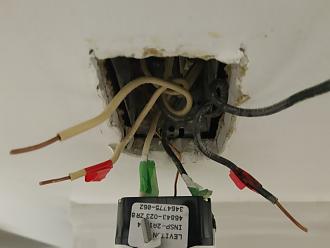

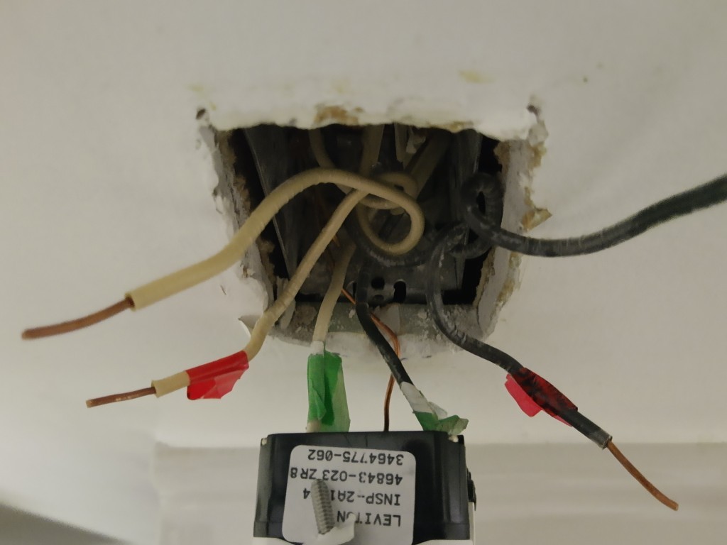

                        As I suspect the light and fan switches are part of the same circuit (and their neutral pairs were not bundled together) I ran a pigtail between them. I did the same for the ground pairs. I isolated the hot and neutral pair in the GFCI and wired them to the Line side. However, after re-testing I got the same result - hot and neutral reversed. <sigh>

                        So, I turned the bathroom breaker off and attempted to locate the mystery fourth pair of wires by testing every receptacle in the house for power. I couldn't find any other receptacles that did not have power. However, I did discover something interesting. When I plugged the circuit tester into the kitchen GFCI it also indicated that the hot and neutral wires were reversed. There are 2 other GFCIs in my kitchen (above my sink) and both of them indicate that they're wired correctly. I find this especially intriguing because I had another basement wiring issue recently for which I did hire a licensed electrician. While he was here, he did work on the kitchen GFCI that is now indicating a wiring issue. So, not sure what to make of that. I emailed him just a few minutes ago and explained what's going on. Just waiting for his reply now.
