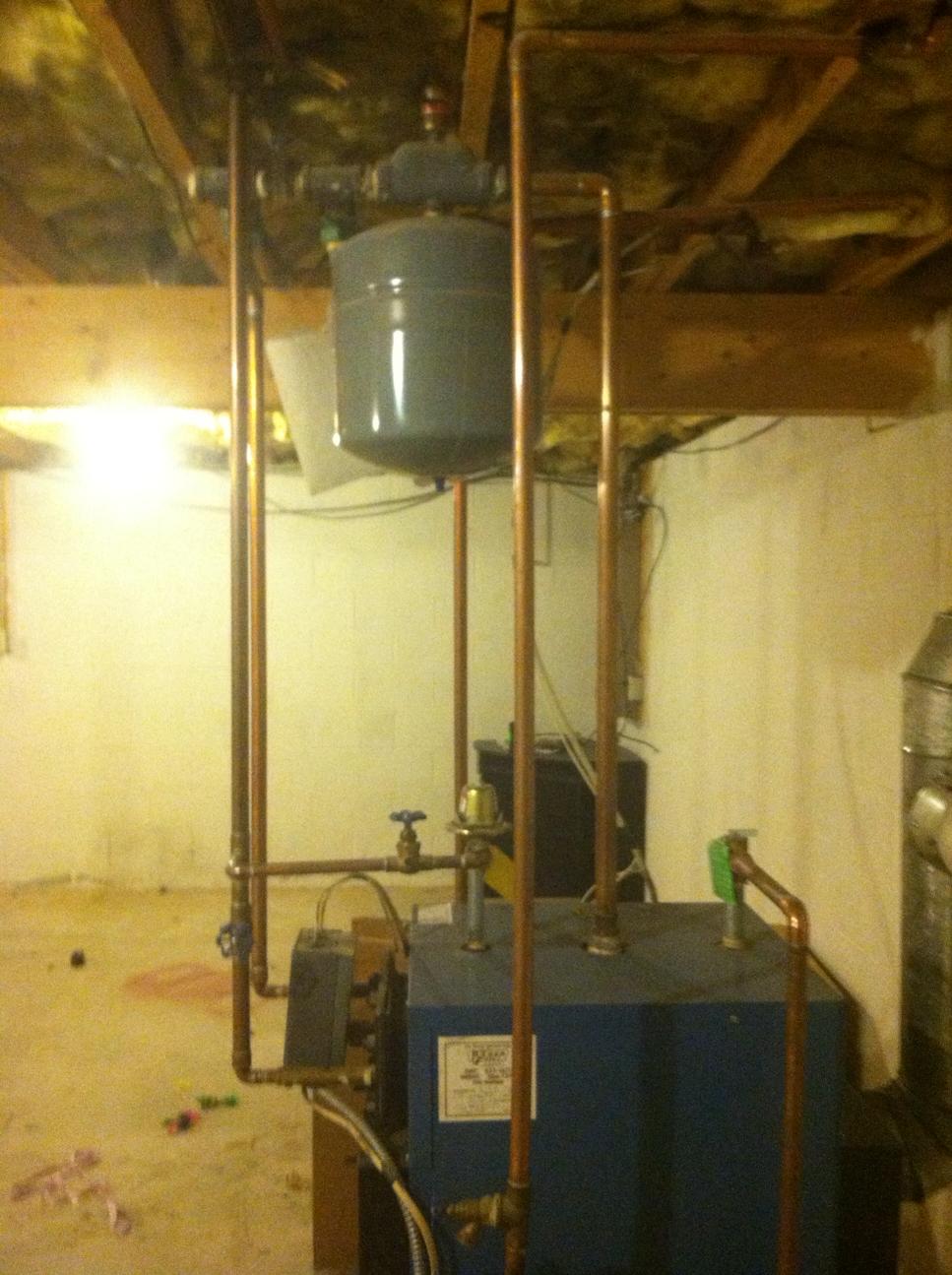

    We bought a house in October and it has an oil hot water boiler heating system. It was serviced right before we bought the house as well. Last month we started hearing a loud clicking/tapping sound coming from the 1st and second floor radiators. It would stop when the furnace was running, but when the water was circulating and afterwards. It would last for hours sometimes. We traced the sound down to the piping above the furnace itself. It sounds like it is coming from one of the valves or pipes.
    1 - Can you tell me where the loud tapping or clicking sound is coming from? I think it might be the flow check valve. They are both a Taco 220 or something like that. He thinks it is coming from the bleeder or something. Is this bad? He says the one elbow is too close to the valve too? Has anyone heard this sound before?
    2 - Will draining/refilling the system fix this?
    3 – If yes, how do we drain and refill this system? We don’t have the money to hire someone.
    4 – Why does it sound like someone is dumping gallons of water down our walls after the furnace is done running. It sounds like draining water but everywhere. Is that air in the lines? Is there supposed to be that much air in the lines?
    Please help : ( It is so annoying to hear this at night

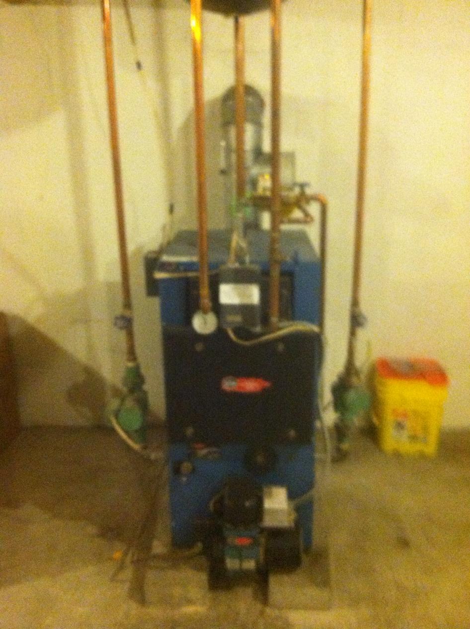

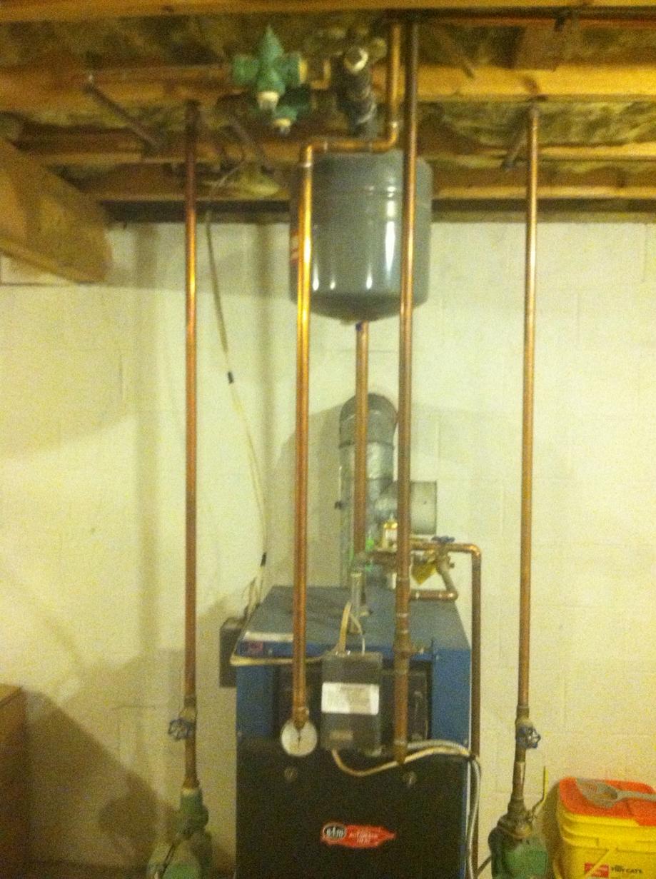

    More than likely you have air in your system. The air needs to be bled off. If there is too much air, which it sounds like there is you will need to fill the system up with water or glycol. Just looking at your pictures I see what I think is two return lines and both have a pump. It is unusual to have two pumps. It is incorrect to have the pump on the return side. The pump should be on the supply side of the system. You could find the highest bleeder and let some air out, but you will need to have someone come and pump up your system. It will be cheaper to have someone do it, than buying a pump, hoses and fitting. With no real knowledge of a boiler system you need to have someone show you how to do it and then you can make the choice of buying tools or not.

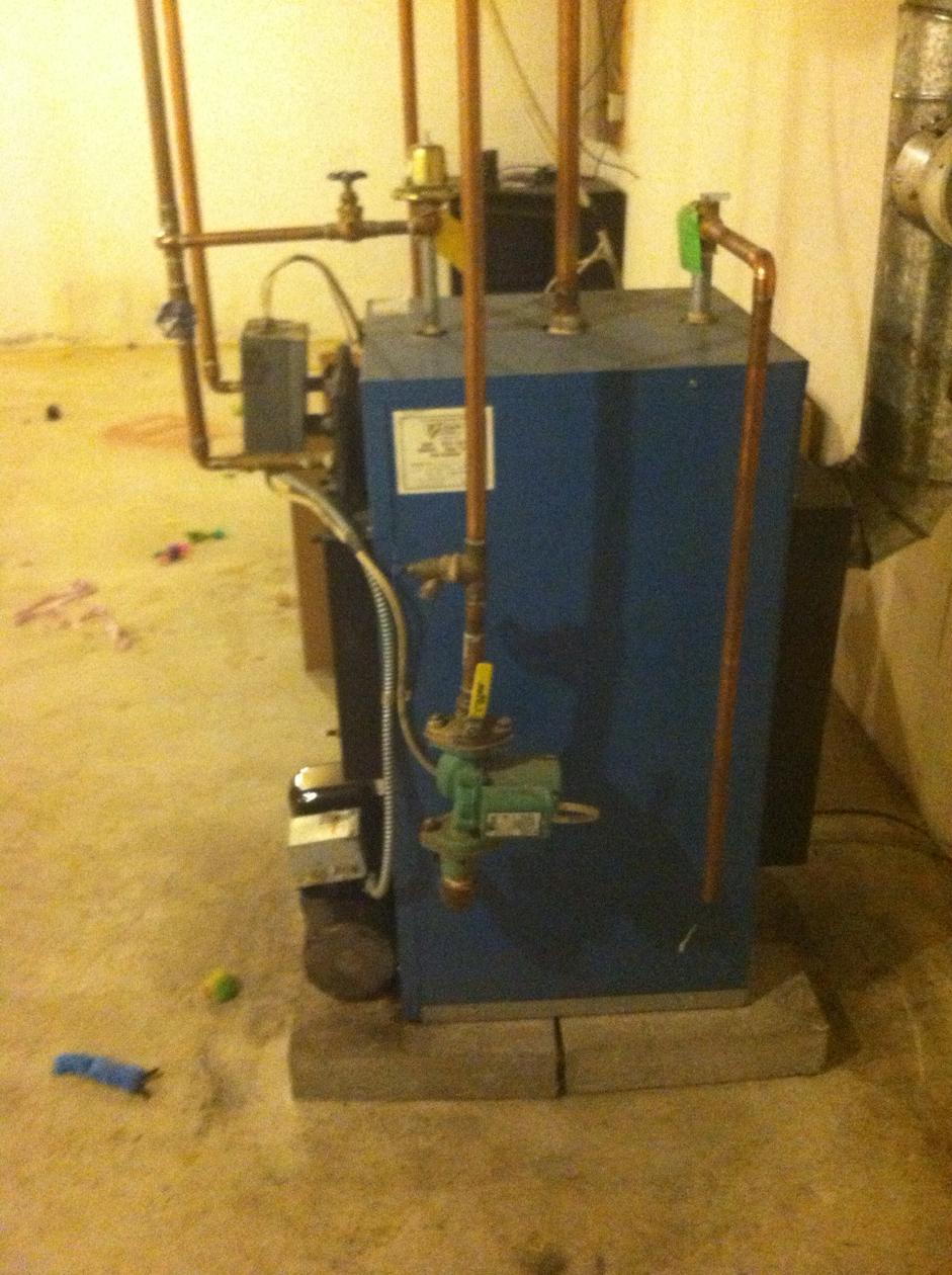

        I believe I see a Bleed valve on top of the air extractor which is on top of the pressure tank. You may also have a valve in the cold water line that is supposed to keep the water pressure up. That is the brass dome looking valve in the center forward of the boiler. If that valve works and you can find a bleeder you can fill the boiler that way. The valve with the lever on top is the temperature and pressure relief valve. It will only help you bleed the boiler itself and not the radiators. There should be someone on shortly that has more knowledge of boilers than I do and they should be able to get to the bottom of your problem. Pumping up the boiler means pumping more water or glycol into your system which will remove the air at the same time. There should be bleeders through out your system, most will be high in the system to help get rid of the air.
