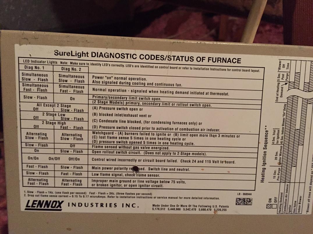

    I have opened the furnace door to check the Status LED lights, both Red & Green lights blink Simultaneously Slow (1 sec interval) which the sticker inside the door says "Normal Operation".

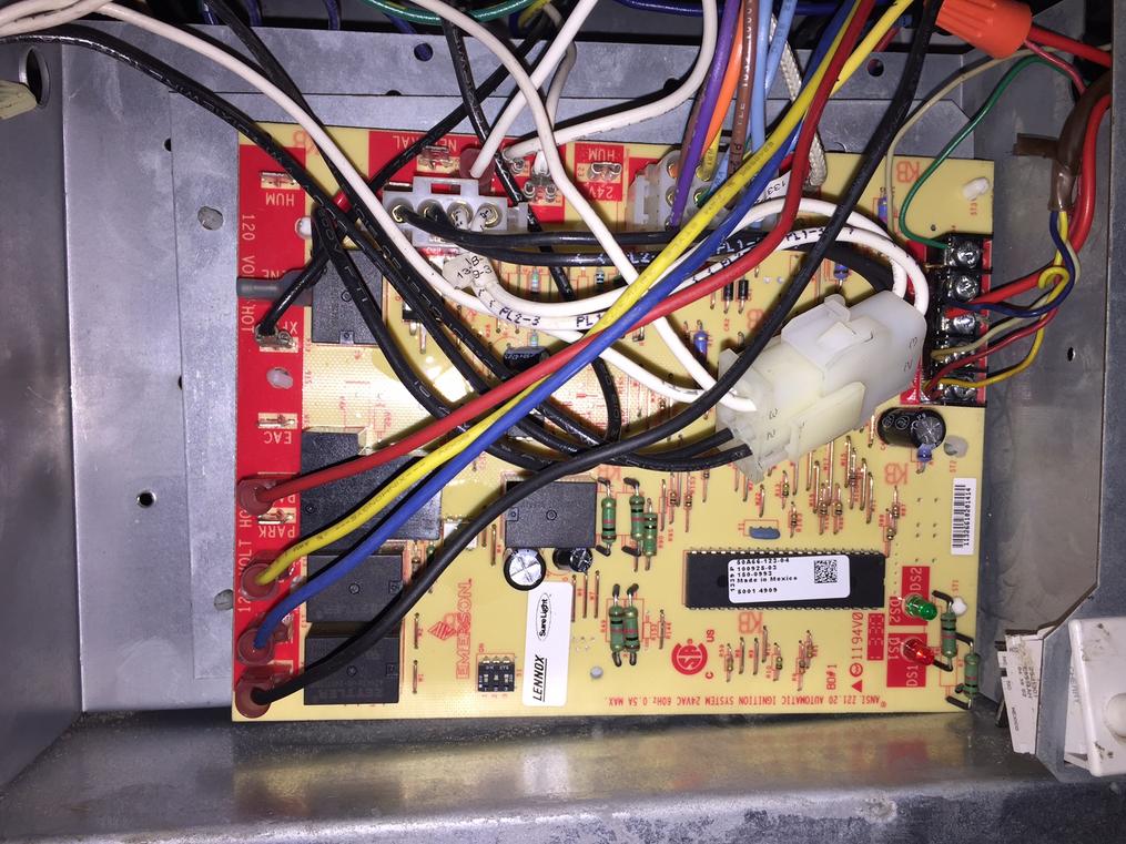

    Cant see your thermostat wires where they are connected at on the board, If you jumper from r terminal to w terminal the heat should come on, If it does you have a problem with the wiring or thermostat

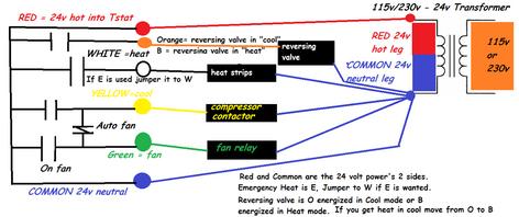

ID:	87322If all the limits and safety's are closed and you have 24 volts to W and no flash codes the board is bad.
      However if you kill power that erases the codes, you need to look through the peep hole to read the code
