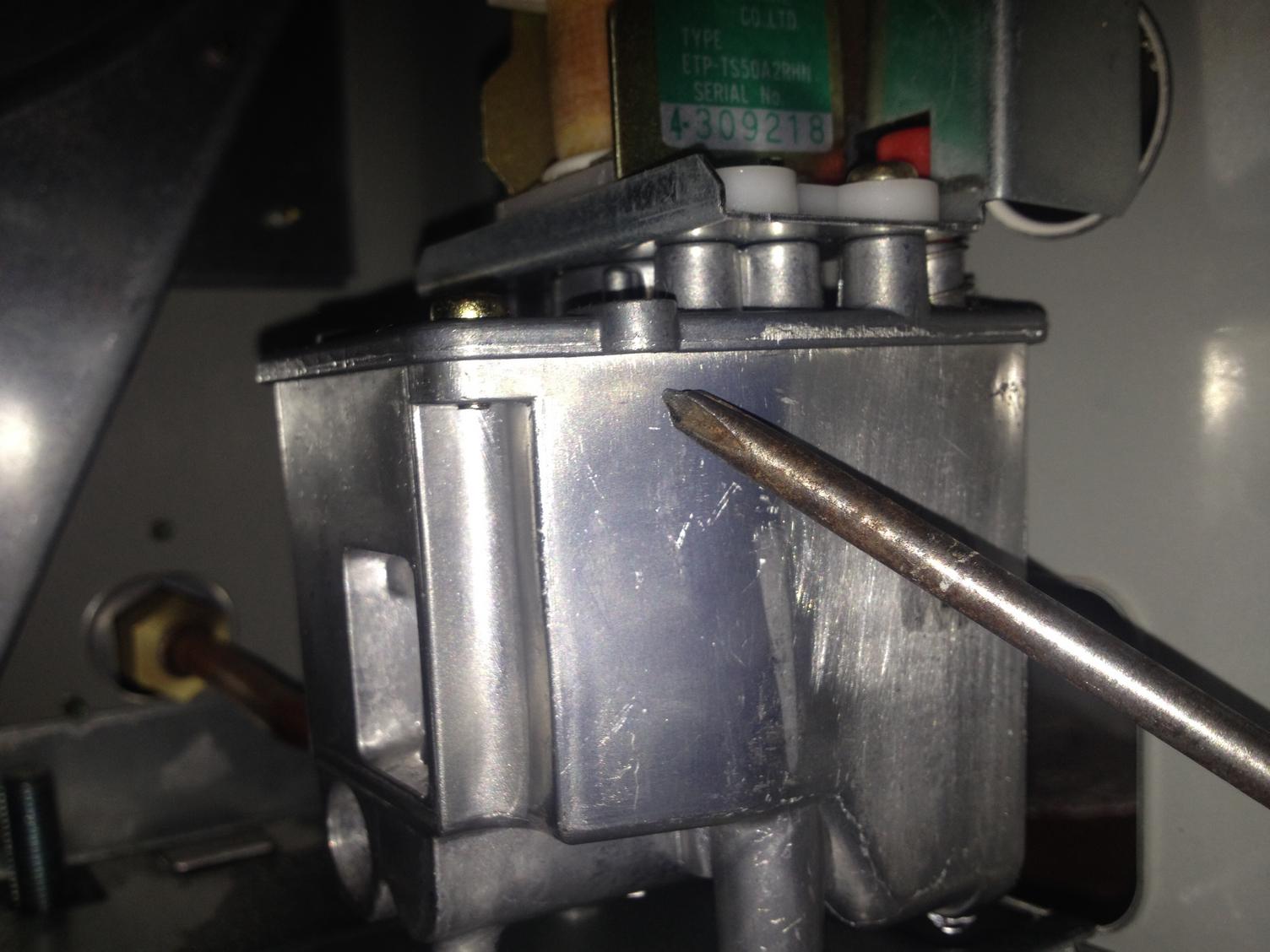

          The fuel is coming out of the hole on the side of the sump, I have another 4 hours b4 I get home...but it's not leaking from the filter or anything that could be loose. Might I add, it's been a couple of years since my oil tank had been filled but no problems with the heater it seems normal, except for the fact that fuel pours out that hole when I turn on the shutoff valve, I'll be home in 4 hours...

            take a picture of the hole you are talking about. there's only four ways for fuel to leak out.
            one: the gland nut surrounding the fuel line in back.
            two: through the hole the lockout reset protrudes.
            three: the bleeder hole on top of the sump pump plate
            four: between the metal plate and gasket where the filter screen is.

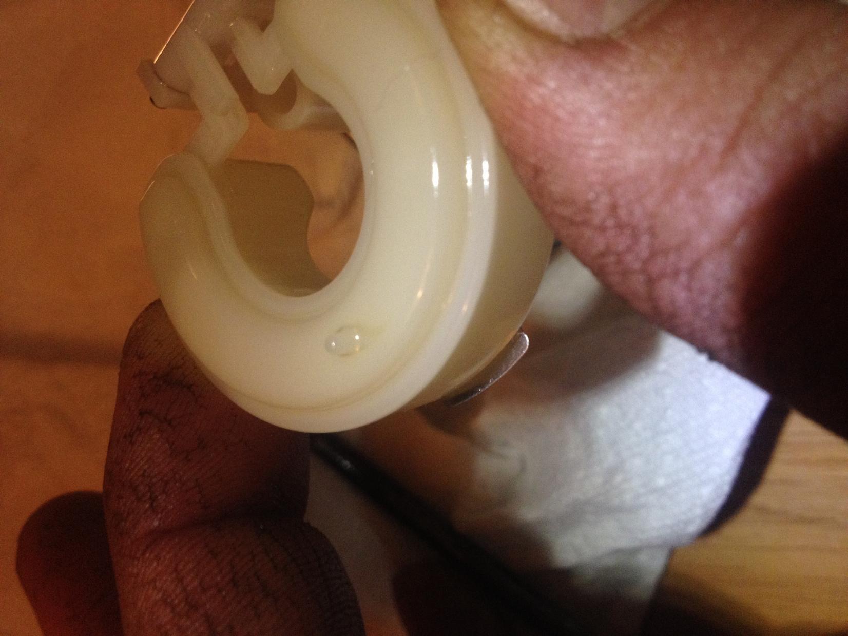

              Option three
              Found a hole in the float patching with a fuel friendly epoxy thanks for all your knowledge it helped!!!

                The float was full of fuel and would not float...
                  float
                  ok, so there's your problem. with the float always down inside the sump, the needle valve was always open. when you have excessive fuel the float moves upwards and contacts that small magnet, which keeps the needle valve closed.
                  invest in a new float when you get the chance. the added weight from the epoxy may make the level erratic.
