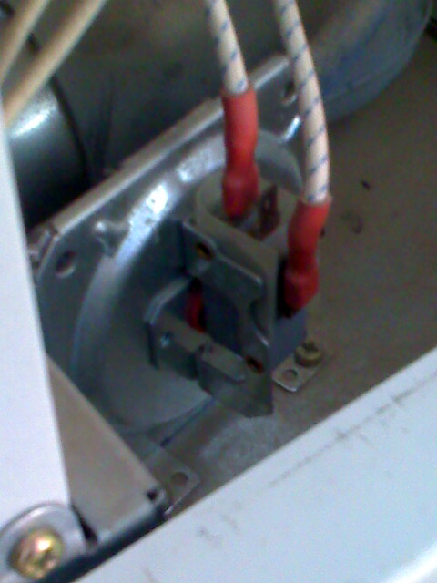

                          • 755
                          There is no air flow switch. You have a solenoid damper that is in the blower case and you have an air safety switch that is located on the base on the right side with the rubber hose connected. The solenoid damper has nothing to do with the fuel flow. The air safety switch has everything to do with fuel flow. If the hose is off or if it has been wired incorrectly you will have no fuel flow. If the exhaust or air tube on the outside of your house has ice or snow on it, it could be blocked also.Click image for larger version
