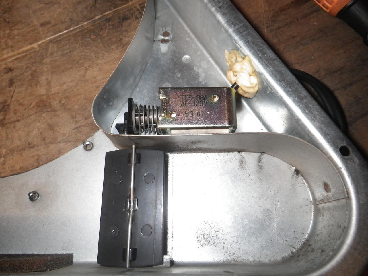

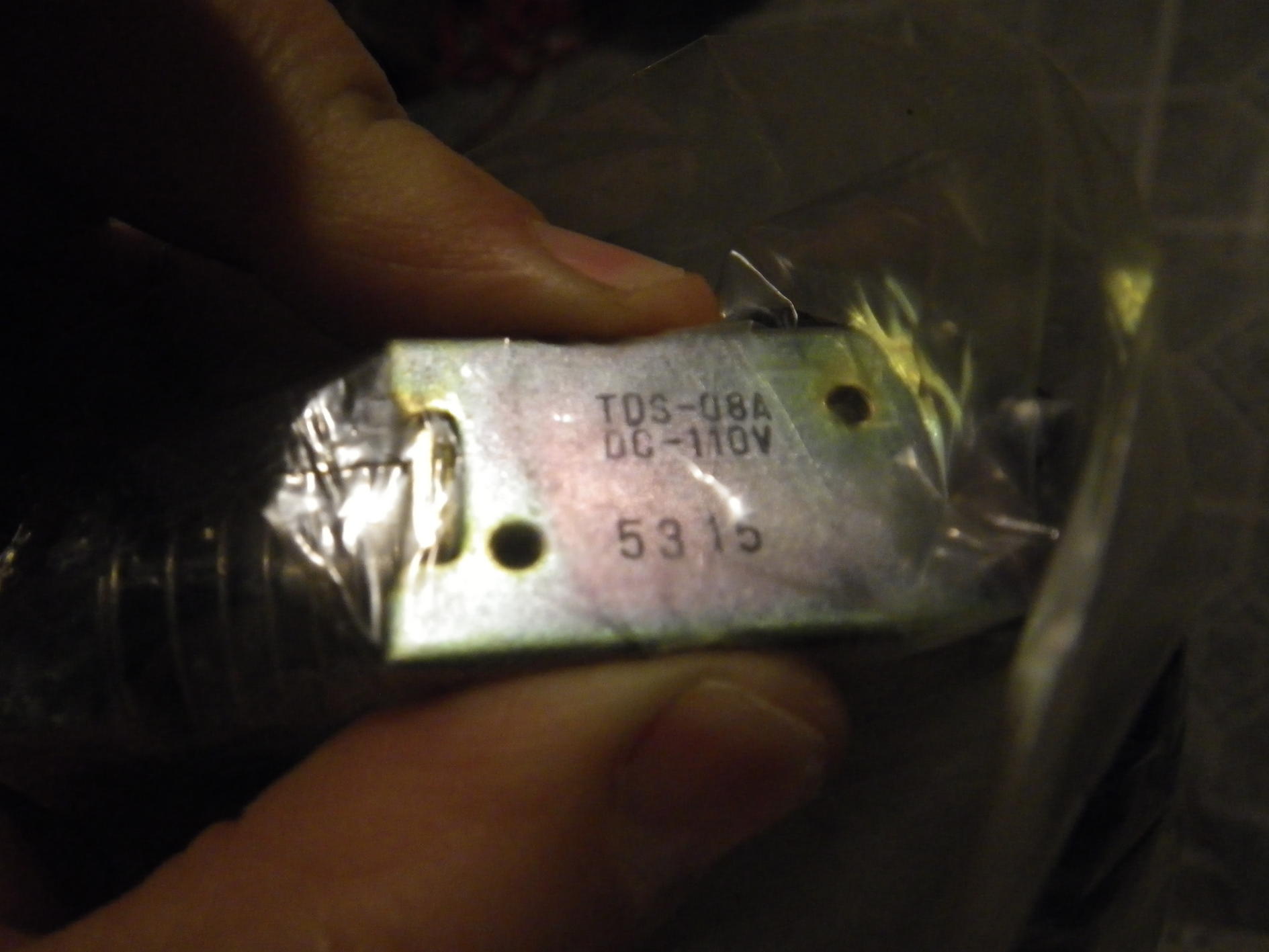

    A service tech told us that our damper solenoid assembly was on the blink. I was able to get the service manual, thanks to this forum! With it, my husband and I have learned much about our Monitor 441 heater that came with our house. We bought the part on ebay, advertised as part #6406. Once ours was apart, and we compared parts, it's clear our existing solenoid says AC and the replacement solenoid says DC. We are very reluctant to try this new part for fear of harming our heater. Does anyone have any comments about this? Thanks.
    Here's our existing solenoid Click image for larger version

    And here's the new one we received Click image for larger version

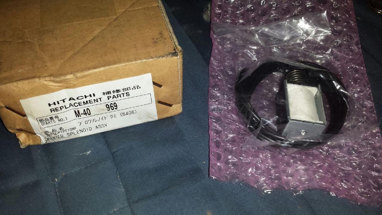

    Although we didn't receive the box, this is what was pictured in the auction and box states part #6406 Click image for larger version

    The solenoid damper actually runs on DC in the first place. When I had my own combustion blower apart, I tried putting AC across the damper, and it wouldn't work. If you can read a schematic diagram, you will see that the AC voltage coming in from the wall plug is rectified into DC before it gets to the solenoid. The 110/120 voltage difference is not critical. It's sort of like referring to a 2-by-4; it's a nominal reference. It'll work fine.
    I have to wonder why your existing solenoid "was not reliable". There's not much that can go wrong with one. The plunger might get dirty, but you can just wipe it clean. It's shouldn't be oiled; maybe just a little graphite. If you've been following the Monitor forum, you might have seen mention of an o-ring. If your blower is apart, you might find pieces of it inside the housing. Mine was all crumbled. It acts as a bumper when the solenoid plunger retracts. There's a shallow grove around the plunger that sort of keeps it in place.

        The old solenoid is missing the o-ring, and while it was working, but was hanging up a little. We had to smack the fan housing to get it to move and shift the yellow flame to blue. My husband says the old one wore a small groove on the plunger shaft, and also the hole the damper shaft fits in had become elongated from wear. He filed the hole round again, and smoothed the plunger, and it's almost as smooth as the new unit. We installed the new one, since it has the o-ring. We'll keep the other as a backup.
