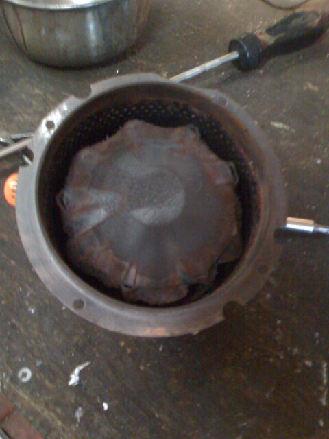

        You need to look into the burner pot and see what the combustion ring looks like. The flame sensor might be touching the ring because the ring has mushroomed from use.Click image for larger version

              I took out the flame rod and the end is bent. From looking at it it looks like it may have been grounded out on something. But it looks like a big job to access the burner ring. Do I have to take the chamber and exchanger assembly out of the unit to access it?
                • 754
                Yes, you have to take the combustion chamber and heat exchanger out of the unit and flip them upside down. Keep them together unless the heat exchanger is very dirty.
                • rrob311
                  • Nov 2014
                  • 86
                  OK I got it torn down and the burner ring is worn out big time, the burner pot is also full of carbon on one side. Is a lot of buildup common when burning kerosene or would it be safe to say maybe diesel or heating oil was used in it?
                    • 754
                    Nobody deliveries Kerosene to homes anymore. You will get #1 Home Heating oil which is almost as light as kerosene and approved for use in Monitor heaters. It is very safe to say that the heater has been running for a long time since it has been serviced. If the bottom of your pot is not warped you can install a new mat and burner ring and new gaskets. This should make your heater run for 3 to 5 years without much trouble. If you use the Economy Plus feature you will get a few more years out of it before you need to service it all over again. Merry Christmas, Tom

                      I had to use a needle scaler to clean the pot but it worked without damage. I also cut a burn mat so we will see how it works. Have you ever tried grinding the protruding edges off the burner ring and put them back in service? Will it work for longer that way? Merry Christmas as well. Stay warm, it was -6f this AM here in NH.

                        Your old burner ring is unserviceable and must be replaced.
