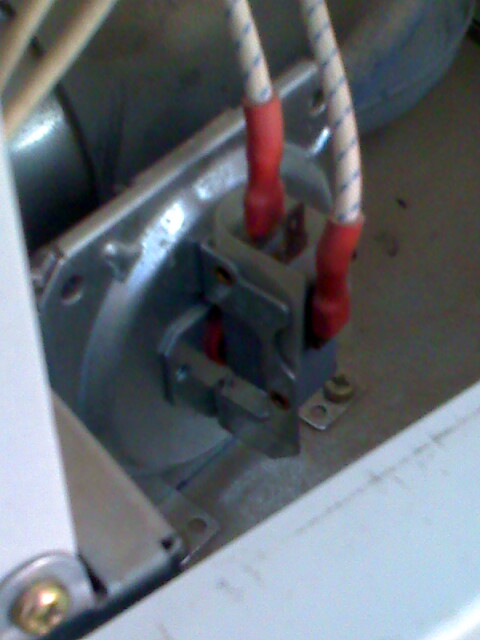

                    Linneus,
                    One of the B/W wires on the J connector goes to the Air safety switch and one goes to the overheat switches. As you can see from the picture of the Air safety the outside prongs are used. It does not matter which of the two you connect the wires to, but they have to be the outside prongs. The other B/W wire goes from the J connector to the overheat switch.
                    After you get this correct go to the C connector and disconnect it from the main circuit board. Plug the stove in, the circulating fan should not come on. Now plug in the C connector, the fan should not come on now either. If this is not the case, there is a possibility you changed the switches around. The over heat switches are normally closed and the fan thermostat switch is normally open. They look just about the same, but are completely different parts. Messing with the wiring on a Monitor can be a $450 mistake. Be very careful around electricity if you have no experience. Be very aware one of the fan thermostat wires is HOT as soon as the stove is plugged in and you can get a real hit off it. Been there, got the Tee shirt.

                      Sorry to be such a dim wit but one of the blue/white wires from the j connector goes to the Air Safety switch, got it. I still have two blue/white wires, one from each of the overheat sensors, I have one going to the J connector but where does the other one go, or is there only one?
                      And another question... Where do the two wires on the K connector go? These are yellow-coated wires. One was going to the air safety switch. You don't know how helpful you have already been! Do you have a picture of your unit wiring?

                        Linneus,
                        The two yellow wires go from the K connector to the fuel pump. It does not matter which side you put them on. That will free up another prong on the air safety switch. That will be the other B/W wire. Boy, I hope you haven’t fried the pump. It is very fragile. With all these wires in the right spot your stove should run OK. I hope we’re not back to the yellow flame again. If so, it is a must to get the by pass and figure out if its fuel or flame sensor.
