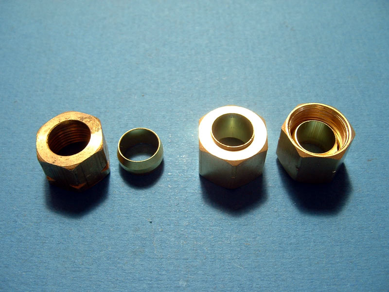

    Loose on the left and captured on the right.

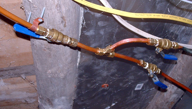

    Feed line from the "gravity" tank is lower right. Upper right is the L30 feed. Left is the L73 & BS36U-FF.
