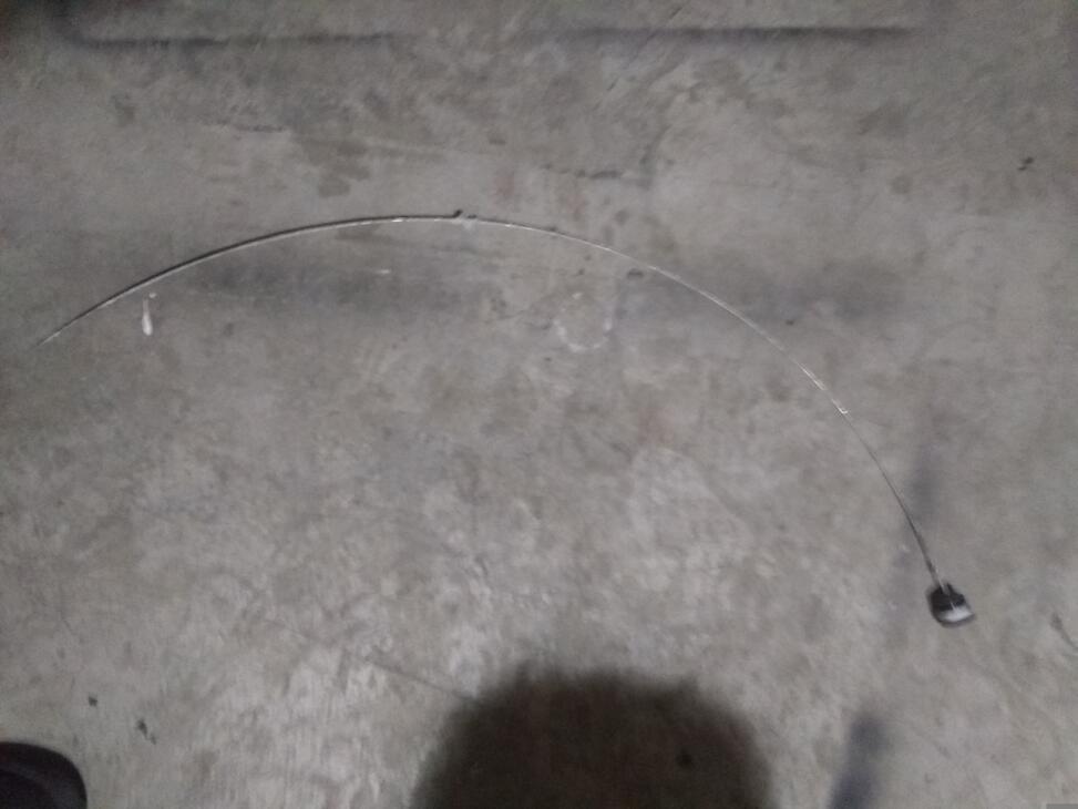

              First off Thank You TinyTool for your helpful replies.
              Ok its done. Should of done it 4yrs ago but never gave it a thought until I saw that episode of This Old House!
              Got to say I was nervous about doing this as I expected something to not go well disturbing parts that have not been touched in 10yrs but so far so good. Its been an hour and I see not leaks from the anode, fill/supply lines, drain valve or blow off valve! Just turned on the power so it will be a little while before I can check for hot water. This water heater has the normal rod and a second one that is part of the hot water outlet. I only replaced one but while it was out I did take my scope and look inside at the other one and it was a good 95% gone, should I replace it too or will just the one be good enough. Unlike the one I replaced which was appox 36" long its only 16"

                You're very welcome, and great job replacing the anode rod. It’s clear that your anode rod has done a good job protecting your tank since it’s corroded so much.
                Since the second anode rod in the hot water outlet is about 95% gone, it’s definitely a good idea to replace that one too. Both rods help protect different parts of the tank, so having two fresh ones will give you better overall protection and help your water heater last longer.
                The shorter 16-inch rod might be easier to replace than the longer one you just did, but it can depend on how accessible it is. Since you already have the tools out and some experience now, it makes sense to go ahead and replace it while you can.

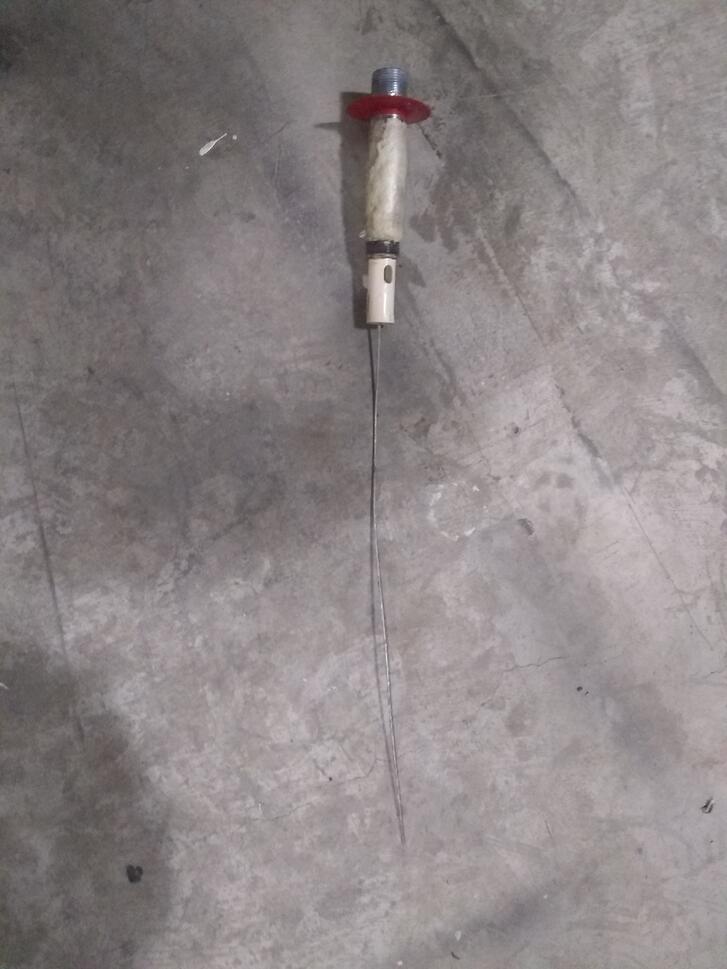

                      Ok I got the rod installed. This one came out much harder as it took a 7' cheater bar and my wife to operate the bar while I held the heater in place. It was past time for this one as well.

                        Nice work getting that second rod out. From the photo, it definitely looks like it was overdue for replacement. Sounds like it put up a serious fight, but good thing you had help and the right tools.
                        With both anodes replaced, your tank should be in great shape for the next few years. Hopefully the washer turns out to be a quick fix. Let us know how that goes.

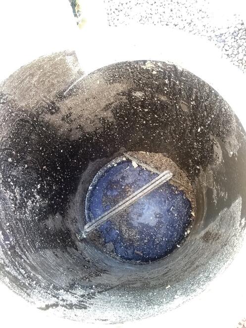

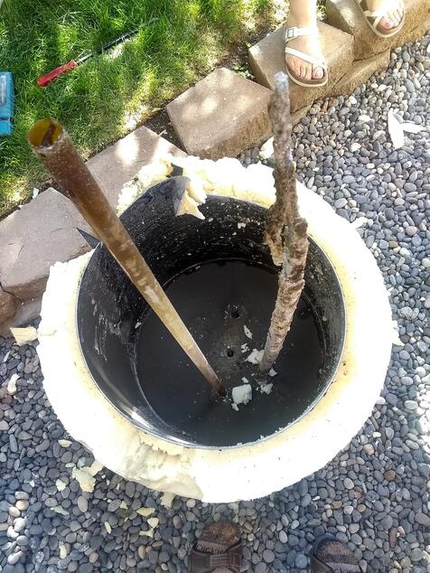

                          Ok since I have been on a water heater kick, I checked the one next door at my daughters house and it was 20yrs old, seems like I just installed it! So I went with my gut and just replaced the water heater, being in a basement with no drain I unhooked the cold fill and sucked the water down just below the upper thermostat with my vac and them removed the upper element and sucked it out from there which worked rather well. Got it down about 3/4 and then just carted it out. I brought the water heater home and cut the top off it with my Sawzall and was surprised that the anode rod was mostly there although it looks bad and there was a lot less sediment in the bottom then I expected. I was watching the vac tank when I dumped it and it seem clear with little sediment. While this tank was 20yrs old I really think it could of gone another 10 with no problem but did not think I could successfully remove the rod to replace it after being in there so long or that it would be in such good shape after 20yrs.

                            Interesting to see the inside after cutting it open! Based on what you found, it sounds like the tank was in decent condition. Still, replacing the whole heater was a safe call at that age, especially since getting the old rod out after so long could have been quite challenging.
                            • Jems
                              • Feb 2026
                              • 6
                              #15
                              That is a fascinating look inside a tank of that age. I am genuinely surprised by the condition of the anode rod; in a 20-year-old unit, they are typically completely consumed. The minimal sediment buildup is also impressive and suggests you have excellent water quality in your area. If you or your daughter ever decide it's time for an upgrade or encounter any operational issues,
