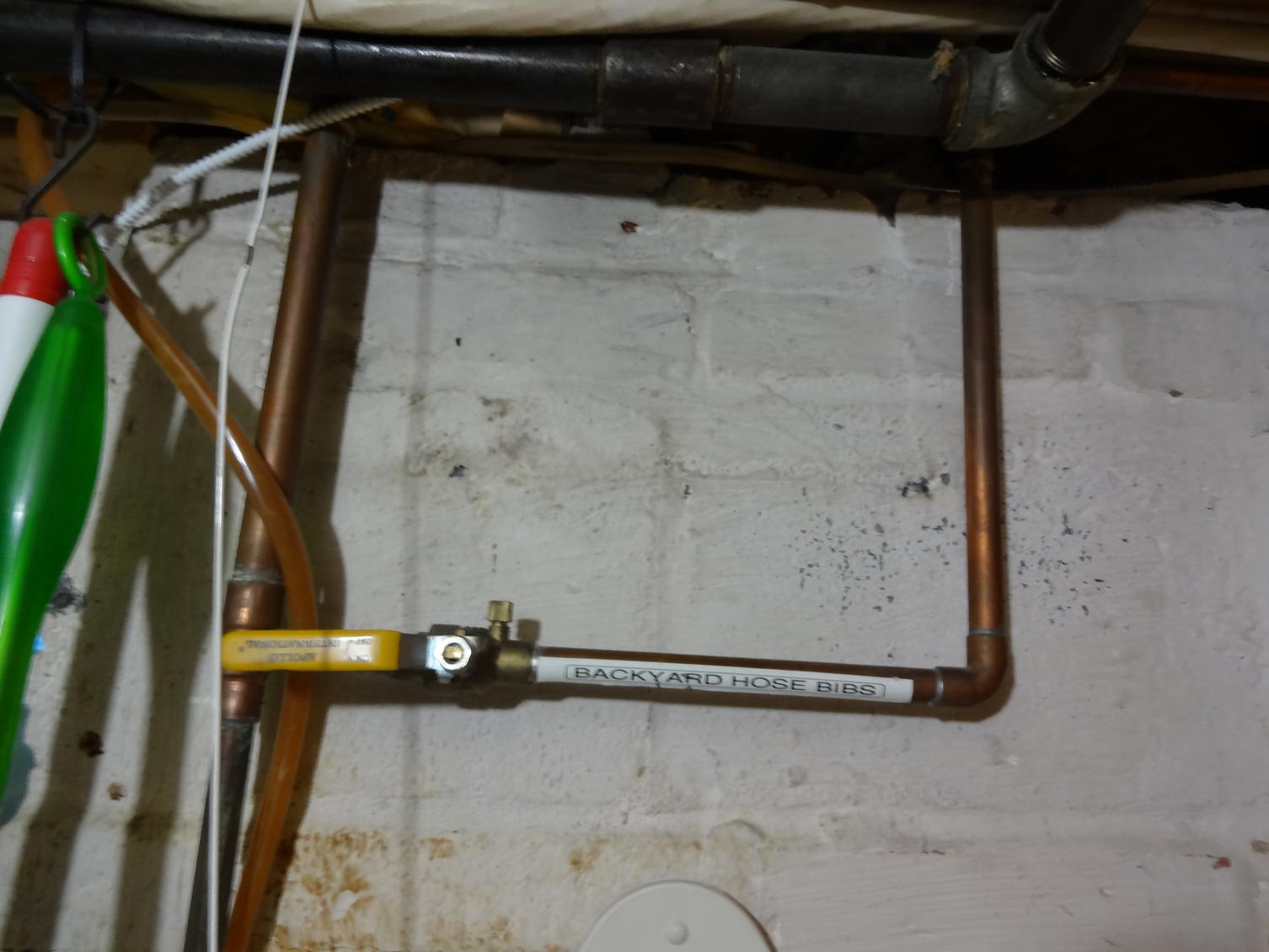

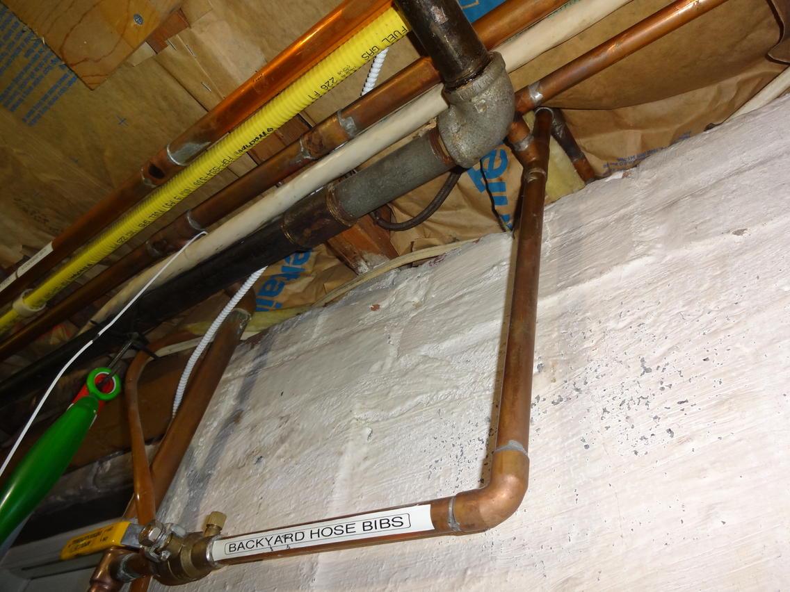

              Thanks for the responses. Here is the one qtr turn ball valve in the laundry which leads to the branch in the 2nd image which supplies the (2) faucets outside. Sorry I forgot to rotate the images, rushed this morning. I think I can drain the water from this branch and remove the elbow and discover what ails this ....It will be easy I hope to re-sweat this joint once I discover the problem.
              I cannot image what could be in the copper section. Like I said I shut this off sometime in the wintertime when I thought temps could pose a problem or to avoid calamity when we'd go skiing or something....

                    Upon looking at your pictures, why not remove the yellow ball valve in the basement and replace it with a stop and waste valve. this way when you shut down for the winter, you shut off the supply [stop n waste] and remove the little knurled nut and your lines will drain back. [open both outside faucets] your outside faucets are all ball valves [normally used to shut off flow], not throttle the outgoing flow. a globe valve is normally used - has a stem washer and seat. most outside spigots are these.

                      It may not be visible, but that is precisely what I installed years ago.

                      I removed the elbow just after this valve and rant a coat hanger up PAST the branch to both lines......NO OBSTRUCTIONS.

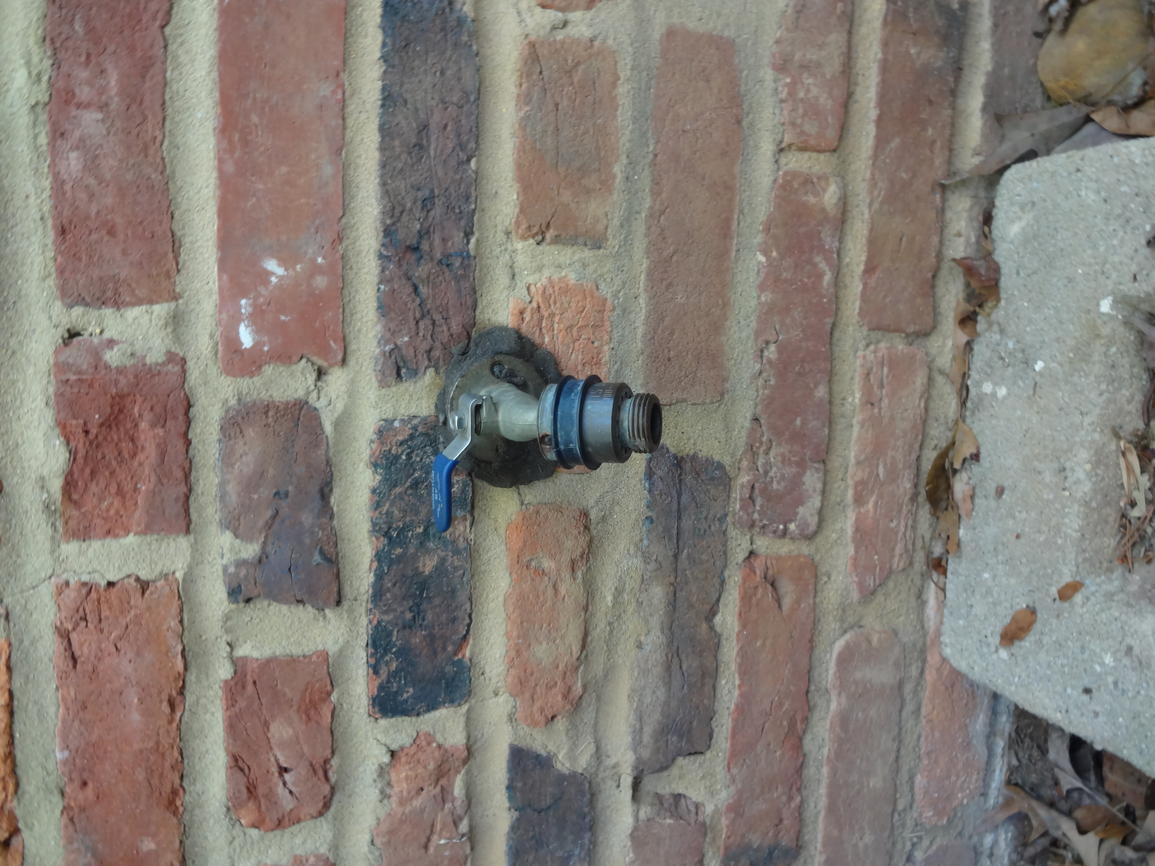

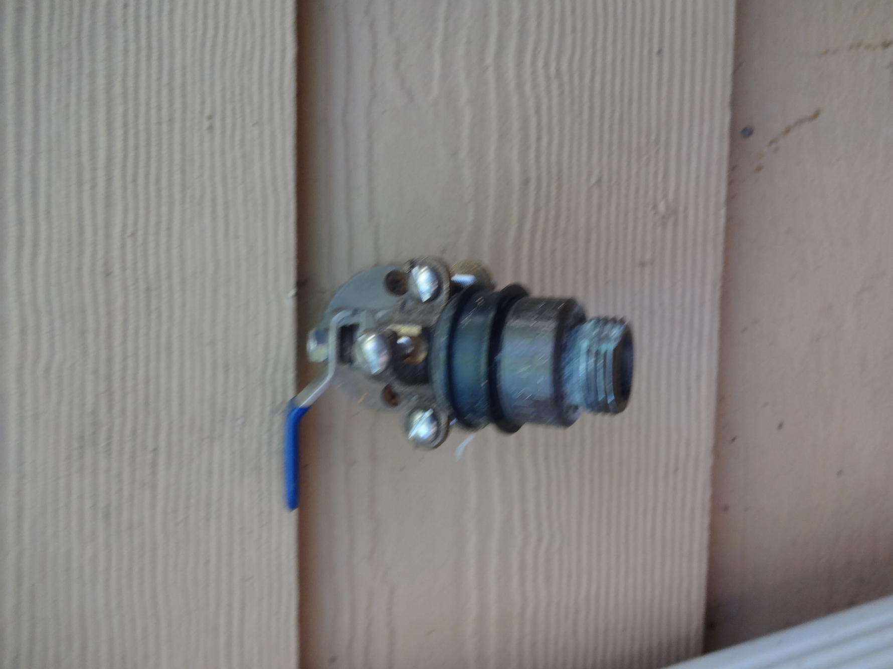

                      I removed the NF8 on the nearest faucet, attached a 90 degree SHARK BITE elbow and fireed the water on-NO WATER out of either faucet.
                      My next consideration is that BOTH faucets have been tampered with to render them inoperable. I have no idea how this could happen but I still plug along with no idea what is going on here.

                        FURTHER UPDATE: Upon removing the far NF8 I was able to peer into the faucet to watch the valve action. When I turn the valve the stainless "ball" inside the facuet doesn't move.
                        How likely could BOTH faucet valves fail in this manner?

                          NOW, you say that the quarter turn ball valves, the internal ball does not turn when you rotate the handle. my thoughts there is that there is a stem washer with the stem press fitted into the ball. evidently the stem is turning within the ball - not turning the ball itself.
                          I would replace both valves with a standard globe valve [sill cock]and IF you do not require the vacuum breaker, why use it?
