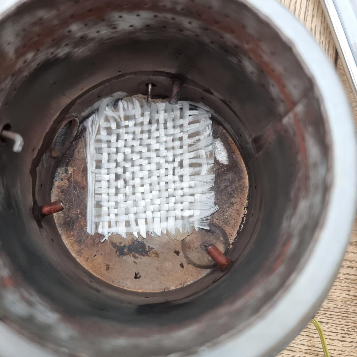

    Hi,
    my first post, so thank you all for being here!
    From reading the forum on these types of heater I think I have identified my problem as I have a large hole in the burner mat.
    I have cleaned the old mat and residue off and replaced the mat with a silica fibre woven cloth I used Victas fire cement and bedded it into that.
    How long should I leave it before I light the burner? I have it in the oven at 100C to help the cure.
    Many thanks,
    Lee

                I would like to know what the important characteristics of the mat are., and how it 'holds' fuel. The original mat looks like a weave with gaps in. Is that important??
                The temperature of 500°C for fibreglass should be good for the material, because the fuel will combust at 250°C that is delivered to the mat. Doesn't ensure longevity of the mat or suitability though.
                I have been experimenting in safe conditions outside with a fire blanket ( the 1m x 1m silica fabric from earlier) and a powder extinguisher.

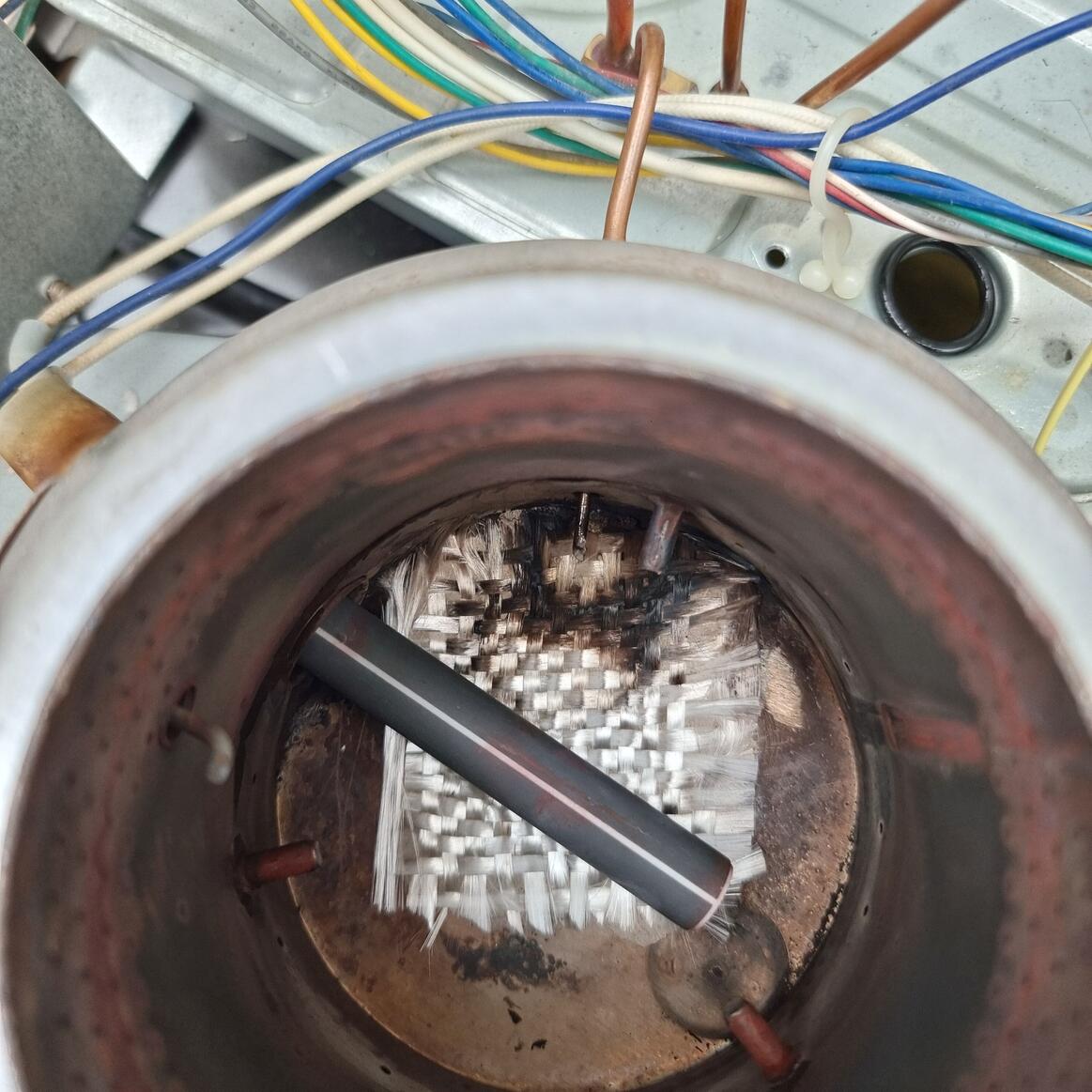

                I got my old LC-DX320 out of the garage which I am fairly sure was sounding like it was a burner mat problem. The symptoms were loss of heat output, the odd E-0 or E-7? and eventually not starting and E-2. I replaced the mat on this unit today with a 15 Oz /400g fibreglass cloth. I cured it in the oven for an hour and rebuilt the heater. This fired up staright away, although the flame had a slight amount of dancing yellow/orange in there.. I turned the heat setting down and I got an E-7. I relit it OK and ran on a moderate heat for 45 minutes and turned it down to minimum for 15 minutes. The flame appeared much better/blue at this stage and good heat output. So, this cloth could be a potential, but I will keep testing it.

                DX320 - New mat cemented in
                DX320 - New mat after running for an hour.

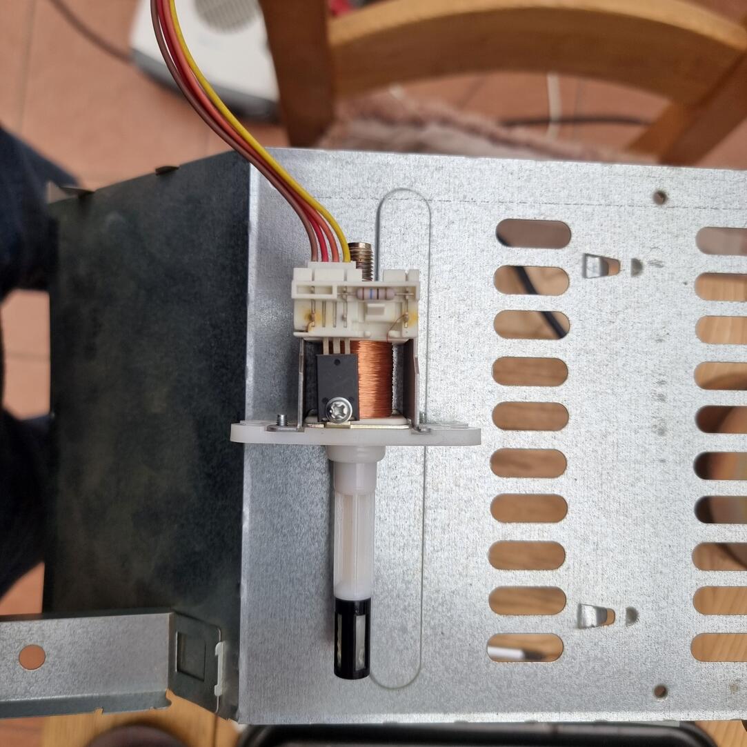

                I went back to the LC-32, replaced the mat with the same material as the DX and rebuilt. This wouldn't fire and had the same E-2. I noticed that these 2 heaters appear to have identical pumps and burner pots and the same 3.2KW output. So I swapped them over for a quick test. The LC-32 now fires up and works and the DX is not firing and E-2 error. Pump then???
                Well, I shutdown the LC-32 after a 10 minute burn, left it for 2 hours and fired it up again. This time I was greeted with greyish smoke on the strat up, it ran fine after this. I ran it for an hour and it seemed to be working fine. I have finished with LC-32 for now as the pump isn't working. Anybody have experience to repair these pumps?

                I have now have the DX320 running with the pictured mat and it's original pump.
                I will check the mat condition after several hours of running.

                  You've done some great work figuring this out and swapping the pumps between the two heaters was a smart move. From what you described, everything points to the pump being the likely problem, since the LC-32 worked fine with the DX pump and the DX showed the E-2 code with the LC-32 pump.
                  From what I found, these small solenoid-style pumps can fail in a few ways. Sometimes the coil stops working, and other times old fuel residue blocks the internal parts. A few simple things you can check:
                  • When the heater tries to start, see if the pump makes its usual clicking or vibration. If it stays completely quiet, it might not be getting power or the coil could be bad.
                  • If you have a multimeter, check whether the pump is getting voltage when the unit starts up. If power is present but the pump does nothing, it's likely faulty.
                  • If it clicks but you still get an E-2, it could be struggling to move fuel. Try cleaning the small screen or nozzle on the outlet side, and make sure the fuel pickup sock and line are clear.
                  • You can also do a short test by letting the pump run into a small container to see if fuel comes out. Do this carefully and outdoors.
