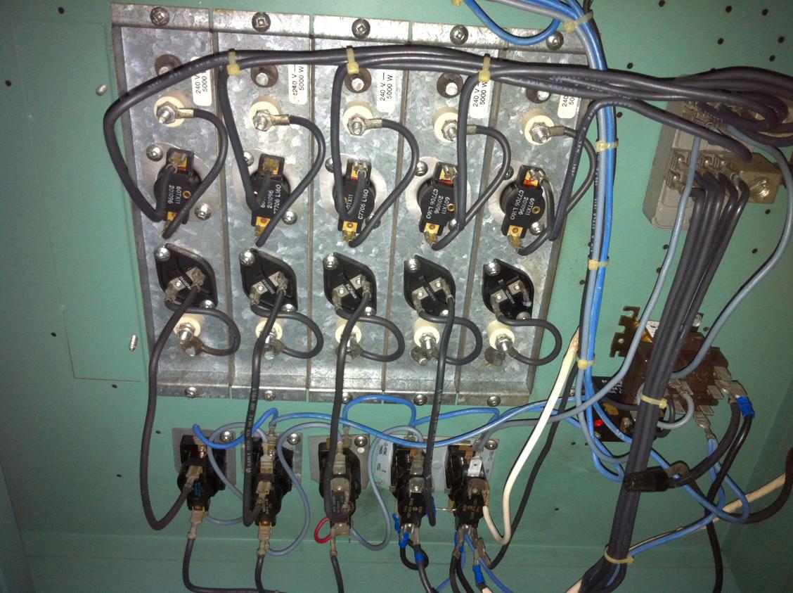

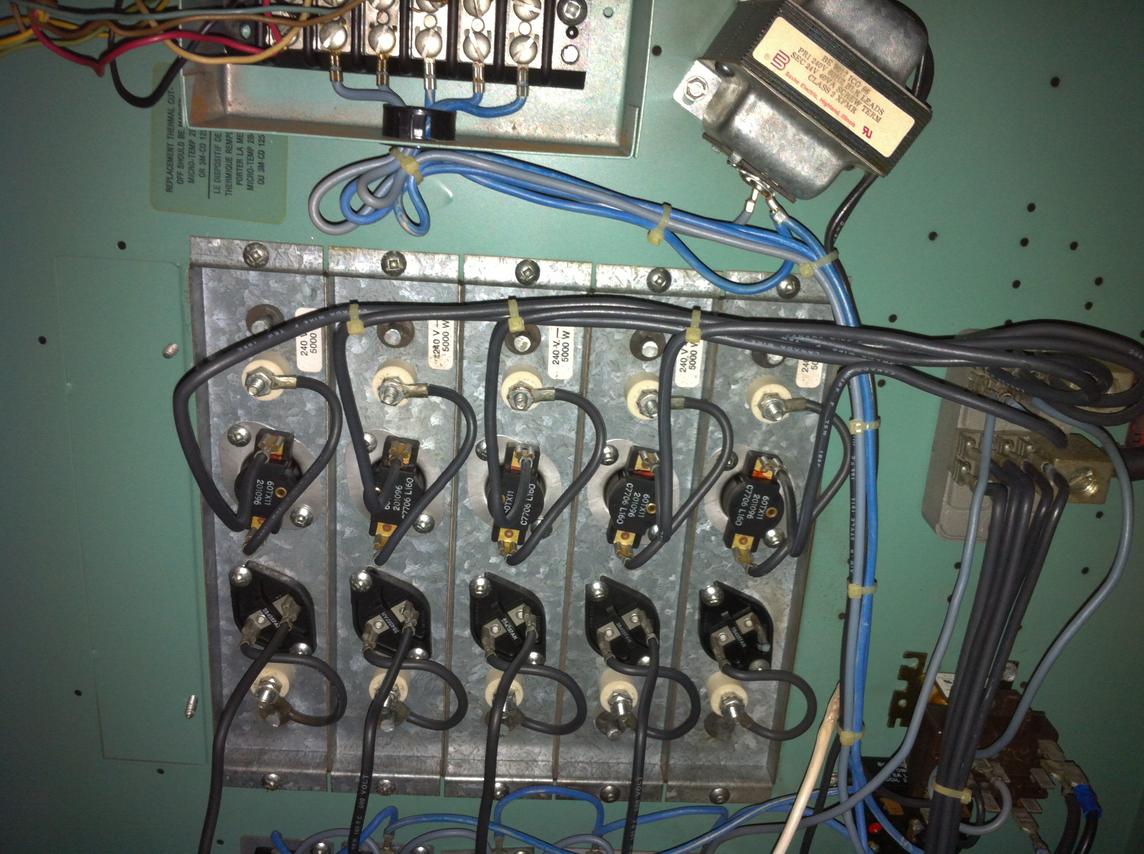

check the wire gauge size imprinted on the wire insulation. get some of the exact size replacement and spade terminals of tinned copper or steel. if I were you I'd change out the sequencer too. the white indicates heat on the terminal. if the contacts inside arc, it causes a high resistance and increased current at that point.
