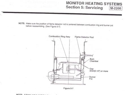

    This is what I have done so far. I have bled the line at many fittings, replaced the inline fuel filter (which is inside), cleaned the filter on the sump pump (not dirty), pulled the flamerod and omhed it out (0.4 ohms), replaced the gasket. I also have cleaned the 1/8" fuel line to chamber pot with doubled up telephone wire and then poked around the chamber pot with a 3" piece of coat hanger wire, trying to see if I can feel carbon. When I stick the coat hanger wire into the chamber (about 3 inches), it feels a bit stuck at the very end) I am afraid to stick the wire in any further and this little 2200.

                          TomClick image for larger version
Name:	M2200 Burner.jpg
