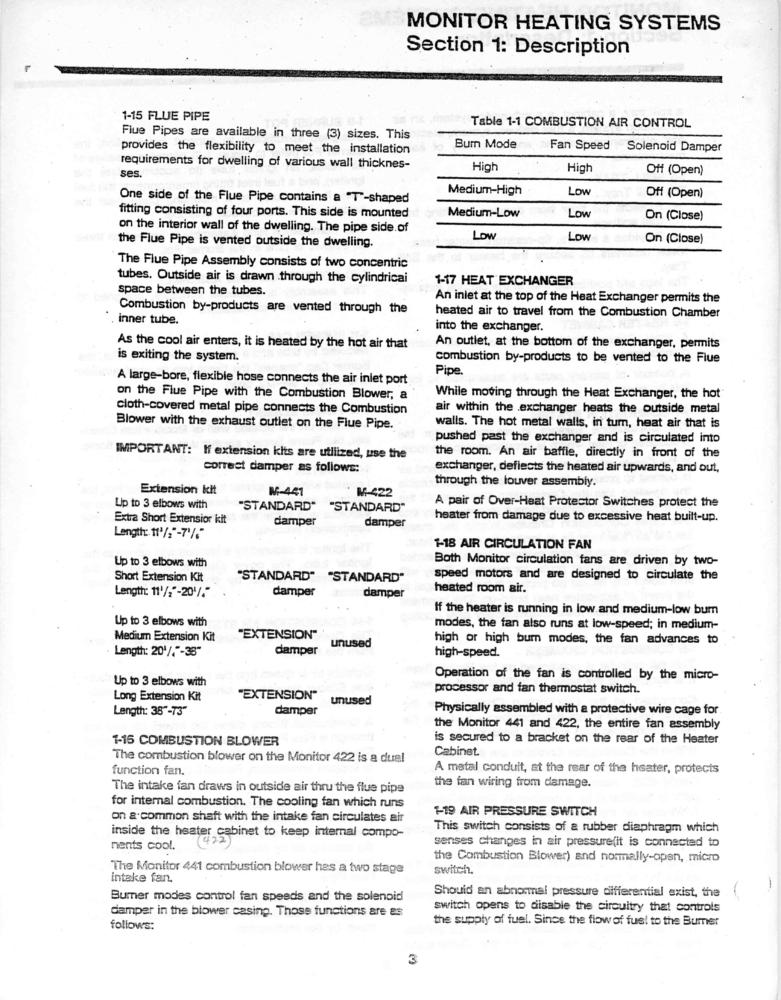

                The service manual I received through this forum was a blessing and a big help but like some .pdf files it's blurry in some places. Some of the the small print in the schematics, timing chart and troubleshooting section is almost impossible to read. It's also missing sections 1-15 thru 1-19 which cover the air circulation fan.
                I appreciate all the help and if you can think of anything else I may be missing please let me know. You guys are great. Also, if anyone can provide a clear copy of the blurry sections of the manual and sections 1-15 thru 1-19 that would be great to have. Thanks.

                    Pg 3 of the scanned service manual is missing. It contains sections 1-15 through 1-19. I've scanned it in, but I can't seem to shrink the file size enough to post it here.
                    Last edited by adnadeau; 01-06-2013, 10:04 AM. Reason: not PowePoints but pdfs; Pg 3 info

                      Page 3
                      Here is a jpg of the service manual pg 3. I hope it comes out large enough.
