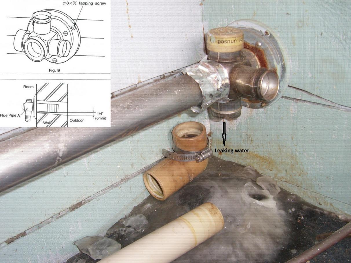

    We bought this condo 5 years ago. The monitor heater works fine the first three years. Now if it is very cold, the heater stopped working with error code E14. This year the heater didn't work when the outside temperature below 10F. We asked a professional heater repairer to check our heater, the man cleaned our heater, but it still didn't work well, so we asked him again, the man said it's water condensation in tank, so he add some anti-freezer to the tank, and heat the tank with a torch. The heater only worked for one day, then it showed E14 again. The flame was very small, the heater worked about 10 minutes, then stopped with E14.
    I saw water dropping at the flue pipe, so I disconnected the outside flue pipe, and found the pipe filled with ice, so I cleaned the pipe, and reconnected the pipe, then finally the beautiful blue large flame came again. But it only have worked for about 5 days, then I found there is blue flame with flickering yellow pop. So I disconnected the flue pipe, and found the pipe was half filled with ice and water, and the water was leaking from flue pipe A air intake port. Please see the First pic.
    So I checked the manual and found the flue pipe A is not installed in correct direction, it should rotate anti-clock wise 90 degree. But look the holes in the wall, it's not easy to rotate the flue pipe to correct direction.
    Now my question is why the flue pipe A leaking water, why leaking water from air intake port. Does it help to replace a new flue pipe A?
    Thank you very much! Any suggestions are welcome!
    • 755
    That installation is the worst possible way to vent your heater. The extension kits are not meant to run through unheated spaces. Sometimes it is just not possible to use a Monitor or Toyo when you do not have a outside wall to vent the exhaust. That being said, the problem is the fact that the flue pipe is mounted on a upward slope through the wall. Condensation in the air side of the flue is dripping back into the flue. You can't see it, but the same thing is happening to the exhaust side. Left too long the flue will corrode through or block up all together. You need to make some major changes to your flue pipe set up, i.e. move the stove to an outside wall and be sure the flue pipe slopes downward.

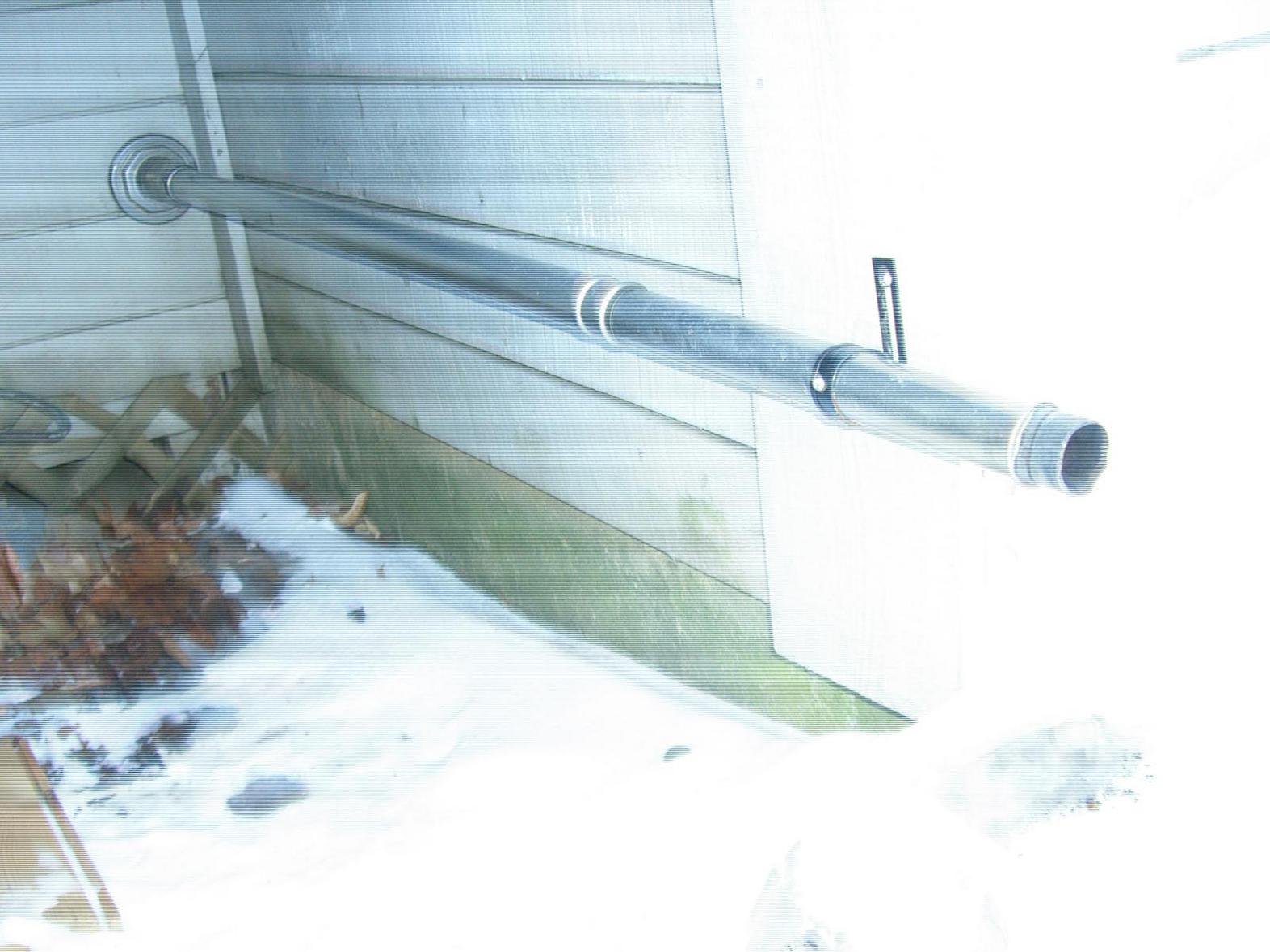

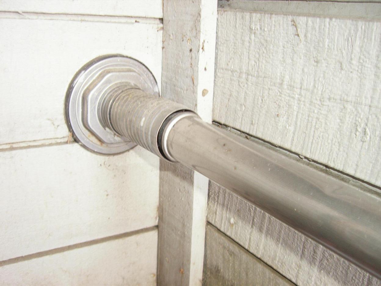

              Thank you hawkins111 and HayZee518, here are the pictures of the outside flue pipe.

              The exhaust flue pipe has an extension outside. The gentleman installed and repaired this heater came here install the extension several weeks ago when the heater didn't work and the outside temperature below 10F, he said the hot exhaust gases met with the tank make the tank cooler, then the water in the tank might freeze, let the fuel gel, so he made the extension and add more antifreezer to the tank.

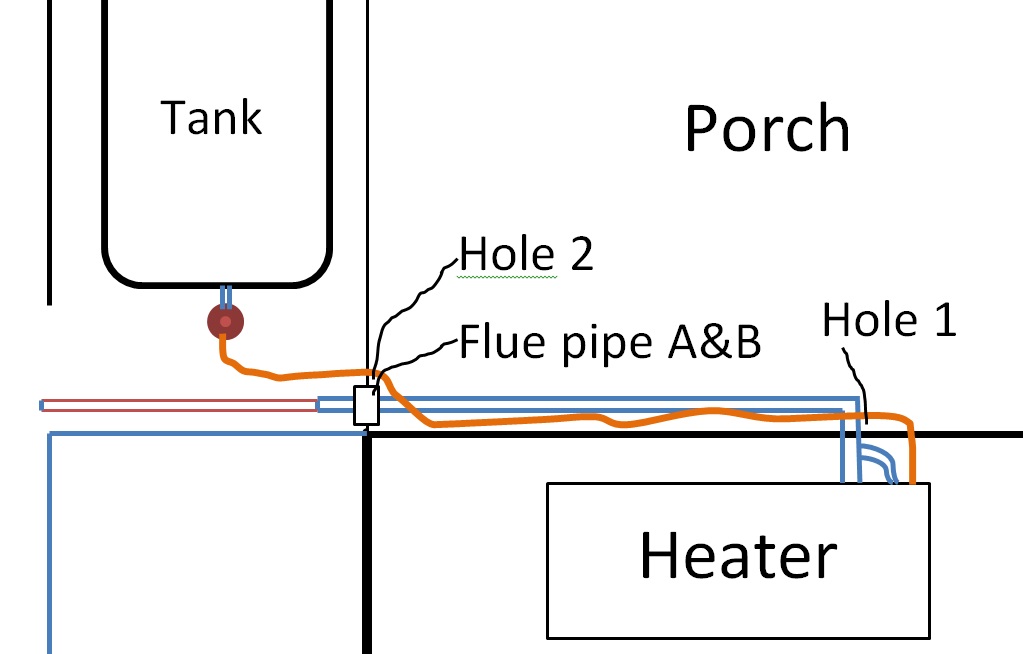

                Above is the installation diagram sketch. Hole 2(the hole in the porch wall) is lower about 2" than Hole 1(the hole in the outside wall of living room), but I don't know if the flue pipe A&B downward or not.

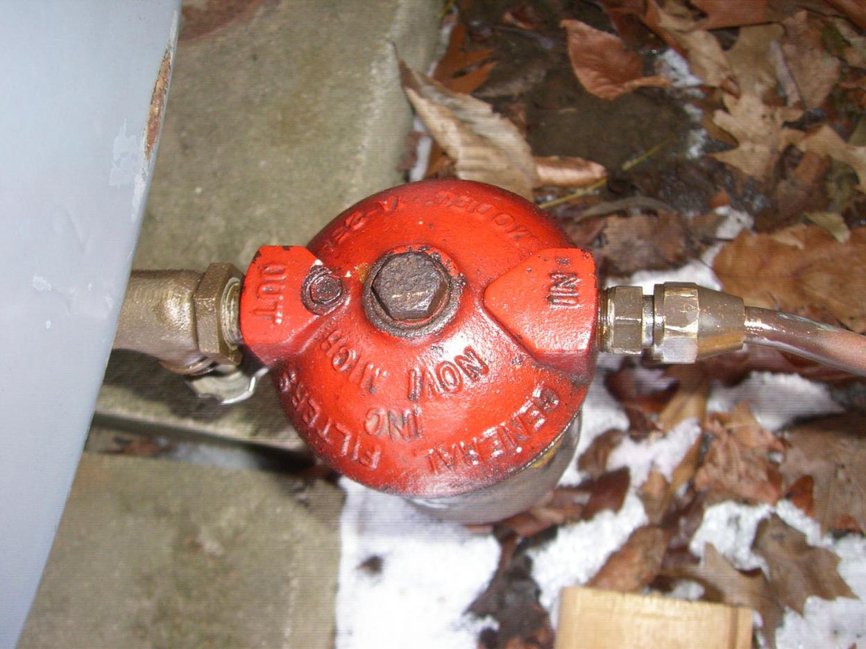

                I also found that the filter near the tank is about in same height with the heater side fuel inlet, and also the filter seems installed in wrong way, look here.

                HayZee518, you mentioned gooseneck extention, can you explain detail how it works for this situation, or where can I find information about gooseneck extension, thank you very much!
                The porch is exposed to outside, the temperature there is about same as outside, it is only sealed with plastic sheet to keep out wind.
                  • 755
                  That whole install is so wrong I don't know what to say. The fact still remains that we don't know if the flue pipe is pointed downward. That is where the water (condensation) is coming from. The gap on the air side of a Monitor flue has been a problem forever. When conditions are just right ice will form right at the inlet of the air. If the ice builds too much it will trip the air safety switch and shut off the fuel. By the way, you have the older style flue pipe which is one piece not the two piece new style. In my opinion that whole install needs to be condemned and you need to start all over in another location, the tank needs to be raised as well. Tom
